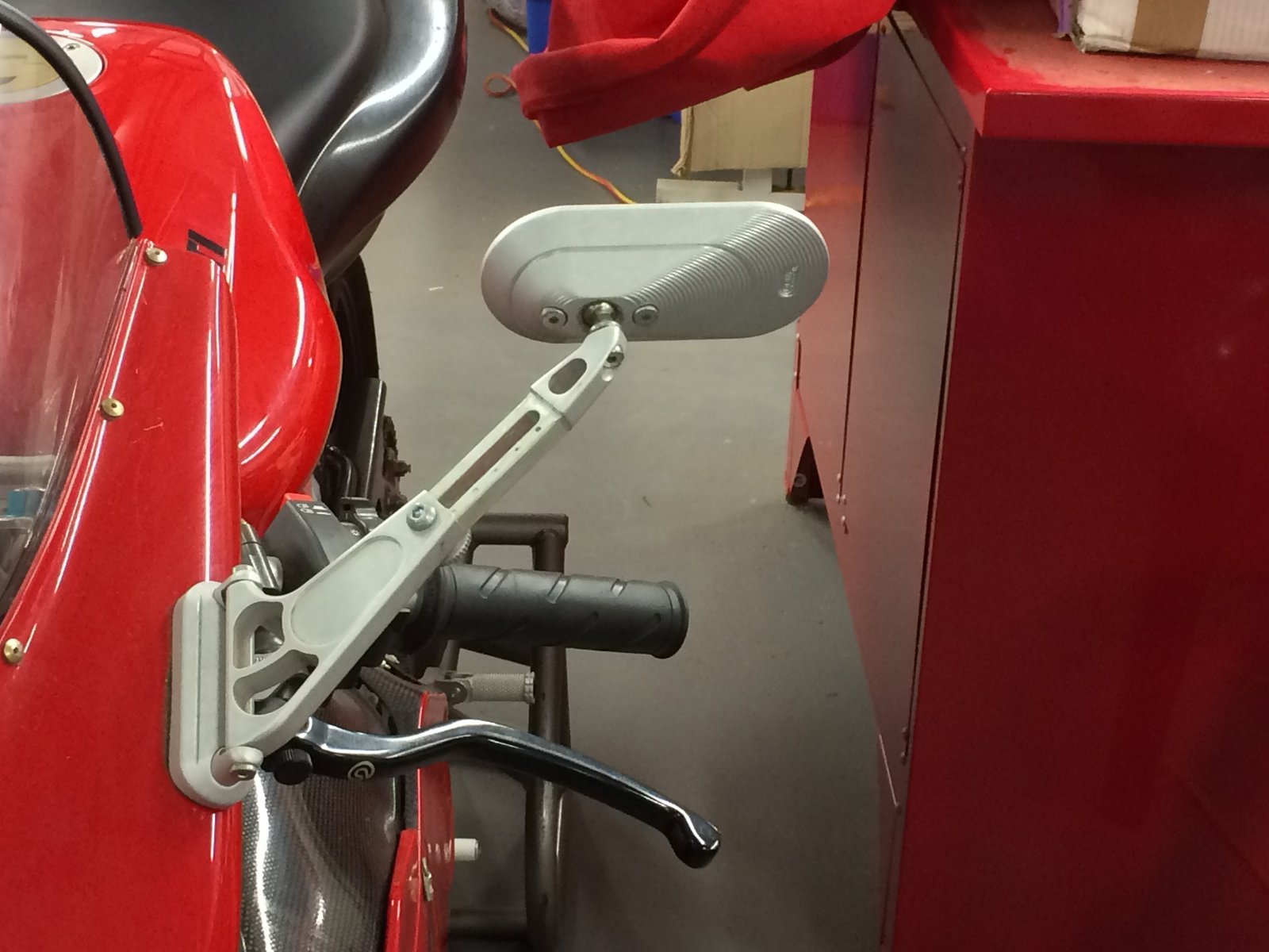

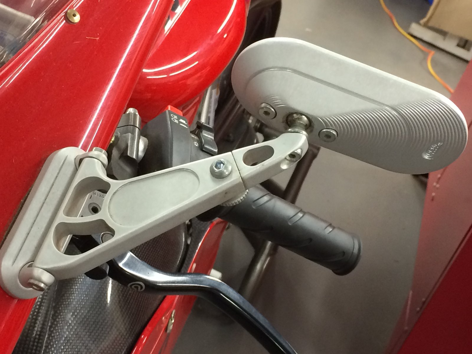

  4. The best mirrors i have brought for vibration are the DP CNC telescoping aluminum jobbies, adjust the length to tune out the primary harmonics? seem best at 3/4 extension
    these dont vibrate? recognise them DP items?
    got spare sets on the cards
