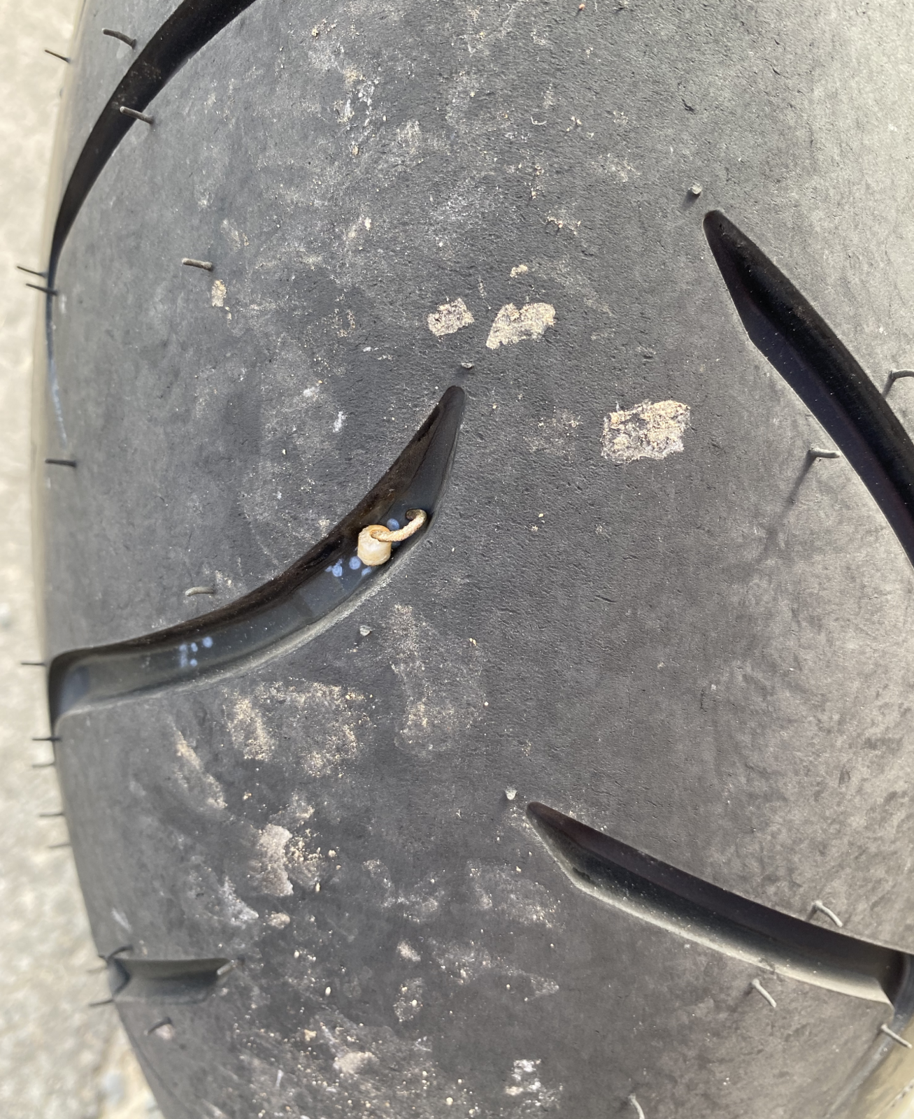

  1. What's your thoughts on plugging tyres?
    I've just had a new pair fitted and got a puncture in the rear within 30 miles :(
    There's a couple places that will plug it for ~£25, and many that recommend very strongly against it!

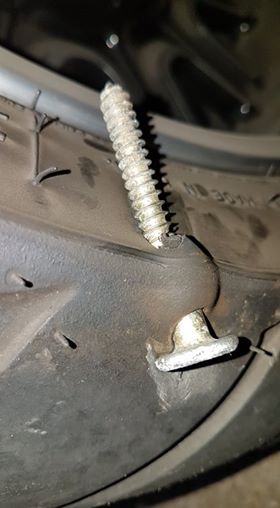

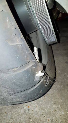

  19. Sidewall punctures,immediate replace!! Check this out. 67691731_407783140083691_414692222143823872_n.jpg 67469706_709974479425979_6656994460334817280_n.jpg This was in my indians rear tyre!!
  20. Thanks for all your helpful replies guys.
    It's a brand spanking tyre on a 749s. ZR rated. Puncture is slap bang in the middle.

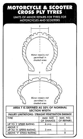

    I contacted Dunlop, and they said, "The British Standard which applies to tyre repairs (BS AU 159g) states that no repairs are permitted in motorcycle tyres with a speed rating above V. Unfortunately your puncture is not repairable."
    So for my own piece of mind and to be legal about it on the roads, I'm going to bite the bullet and just get a new tyre :(
