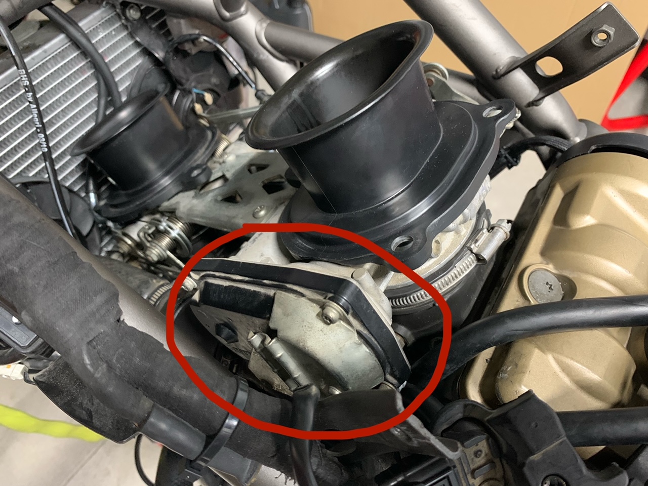

  1. Hello, I'm new to the forum and my name is Primoz. I have a problem with the MTS 1200. Engine want start. I marked the part that "lights" up on contact and does not go out. Can anyone advise/help me what could be wrong? Thank you!

    The throttle bodies are one unit and cost over €2000! Can you please explain what you mean by "the part that "lights" up on contact and does not go out", I think something is lost in translation.
    Have a look at this thread, might be helpful. Judging from replies it seems to indicate that the throttle servo runs until the engine starts. So the issue could be elsewhere.

  3. When switching on, throttle motor hums continuously and dont stop.
  4. According to the post I added a link to above this is normal behaviour, see the post on there from aero52. Your problem with starting might be elsewhere.
