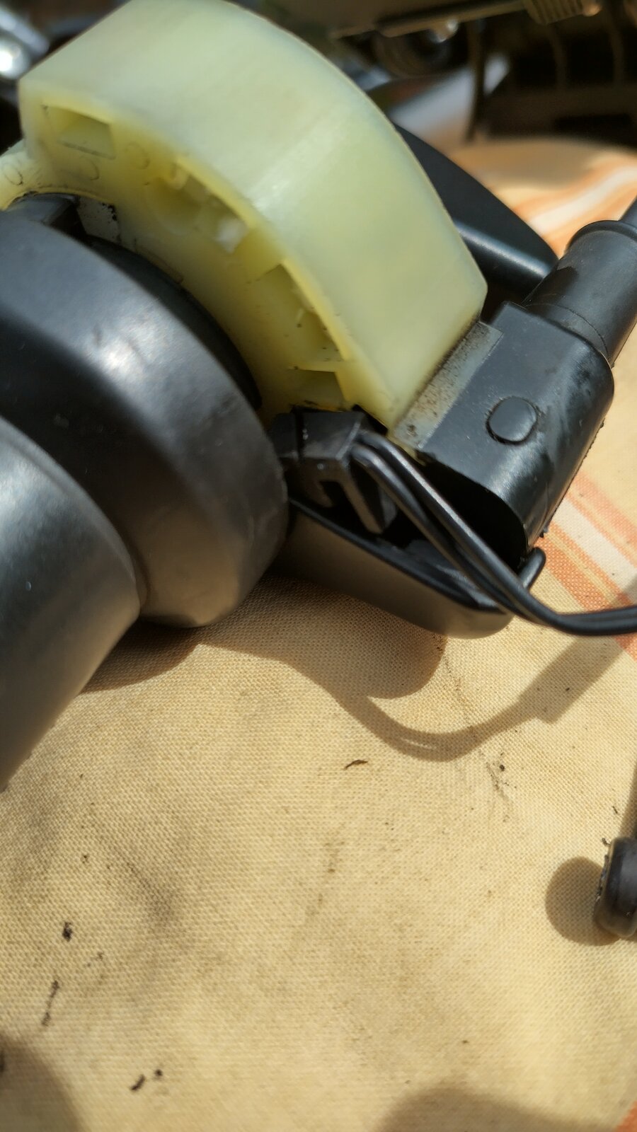

  4. Ok, throttle is off, spring is in, can anyone do me a nice close up picture of how the heated grip wiring goes please, on a complete assembled throttle?
  5. Not a great pic but now struggling to see how that little clip should go.
  6. Ok, panic over, seems it just wedges down in the gap, all sorted and put back together.

  8. If it’s any consolation, I had exactly the same issue. It looks like it should be more complicated than it is. Luckily my mates V4S was in the garage so I could dismantle his for a look!
  9. Thx mate. Since last night I've managed to find a great installation post on another forum and they recommended dental floss to pull the locating hook on the end of the spring into its retention hole. Gonna give that a go. Ta. Rich.
