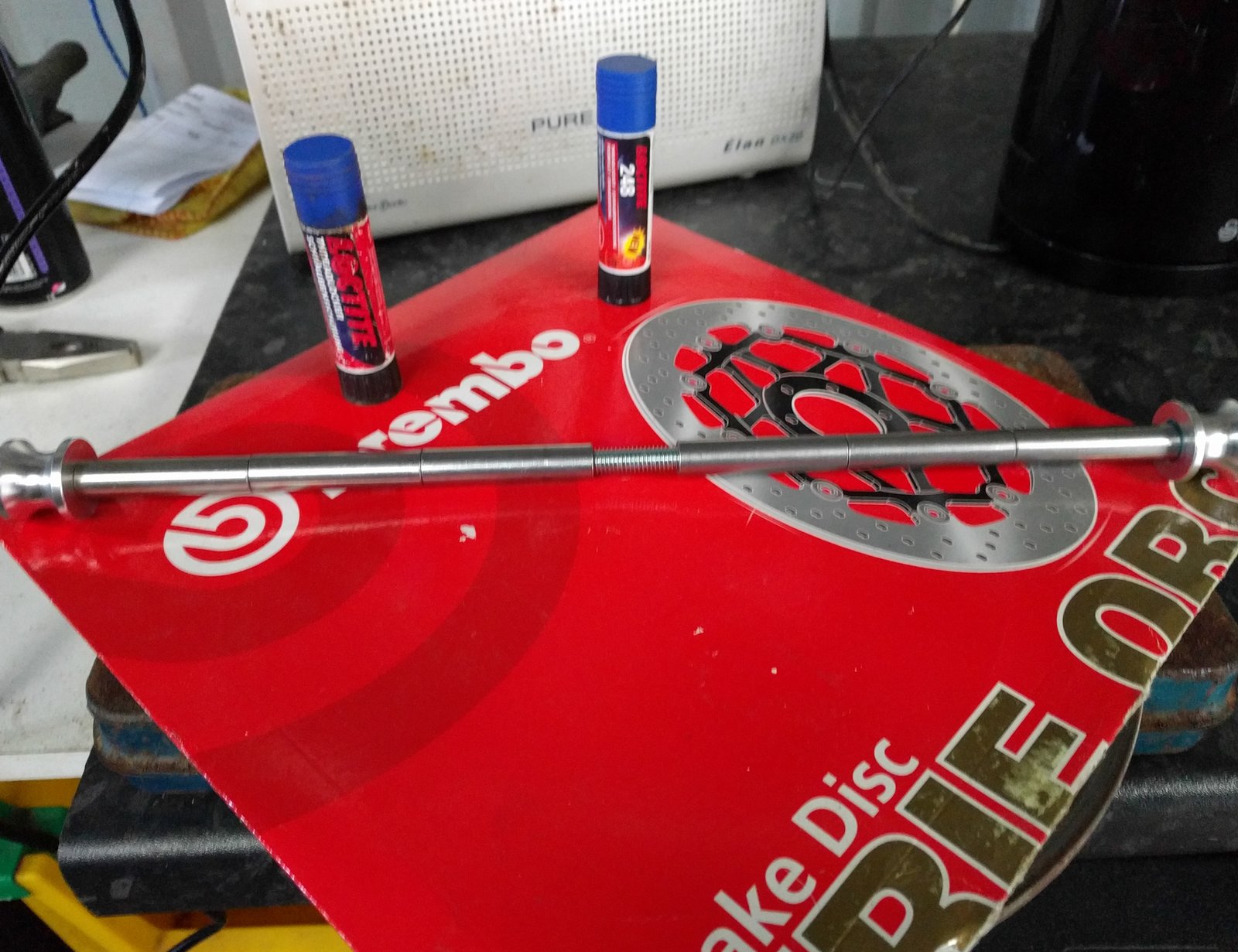

  7. I was thinking I could make up an 8mm threaded rod and spacers - I already have a pair of 8mm bobbins, but I'll need a different diameter plug with an 8mm hole at each end to fit the internal axle diameters of 20mm and 17mm, bit of a faff as I don't have a workshop! Easier if I can buy one off the shelf. I already have the correct bobbin hooks for my stand, which at present uses the flat plate with rubber cushion, not very secure

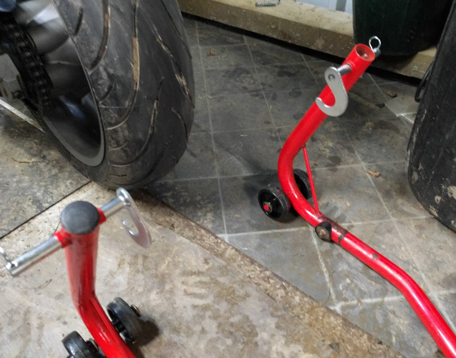

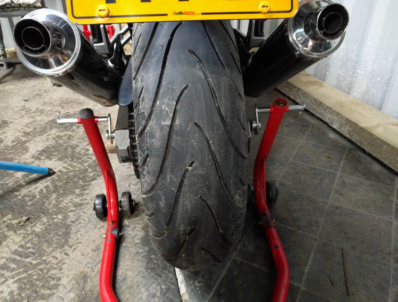

  8. I made up my through spindle bobbins in the end. I bought a metre of M8 threaded rod, 6 x 50mm tube connectors and a pair of M8 bobbins. Quick hacksaw and a bit of Loctite and job's a good 'un. A pair of hooks from eBay interchangeable with my plates to allow wheel removal. Total cost less than 20 quid. IMG_20181110_112954.jpg IMG_20181110_115644.jpg IMG_20181110_120004.jpg
  9. NIce.
    I too have one of those stands with interchangeable hook holders. And they are rubbish to use!! Get some fixed prong ones imho: easier to use on your own and lifts the rear higher for easier maintenance or use of tyre warmers (if thats your thing) :upyeah:
  10. Nah, only use it for chain lube / adjustment, cleaning wheel and holding it upright to work on - you know how short the side stands are! Lifts the wheel high enough for those jobs. Locates on the bobbins much quicker and easier than getting the plates in the right place. Obviously not leaving the bobbins in situ when riding, it only takes 10 seconds to remove them.
  11. Ar right, so you remove during riding. This it was a fixed deal. What about when you need to remove the rear wheel?
  12. Just swap back to the under swing arm flat plates. Again only takes a minute.
