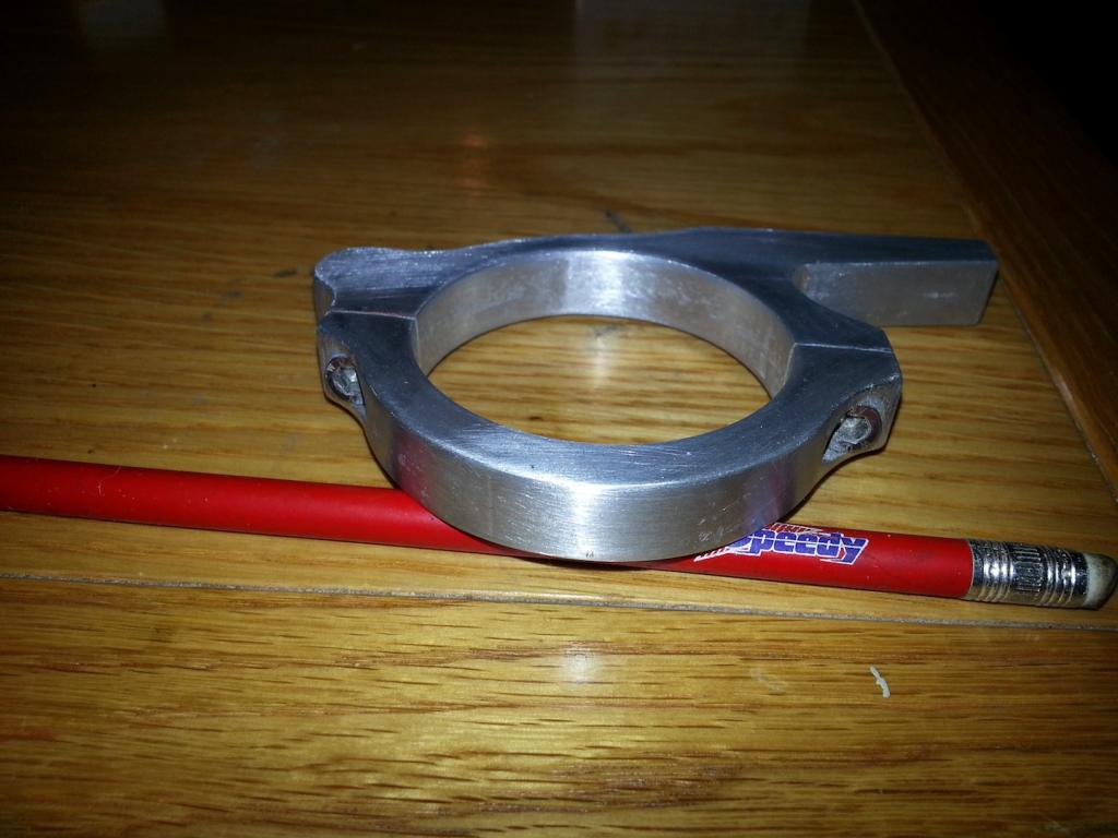

  11. Decided to make my very own thumb brake , for no other reason than I can , this is the fork leg bracket . I will decide on the master cylinder after I have disassembled a brembo one I have . I will either use that one, or if I fancy the challenge, I will make one of my own . Can`t be that difficult . Then all thats needed is a lever . I think the advertised ones are a rip off and will keep you posted on my progress .Will need polishing when finished . This took about 2 hours but I do have a lathe and a milling machine .
  12. Will do. I should get the forks back next week so I hope to be making progress with the build over the holiday. Andy
  13. Looks good. Andy

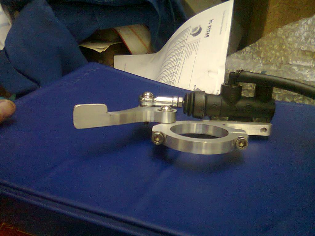

  14. must admit I nicked the design from the web . That why I thought about my own master cylinder as Im sure I could make a smaller one . Lever will be to suit the bike as well . This is the picture that started it .
