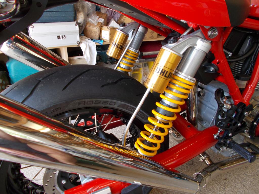

  4. dave ,end can brackets you say ?
  5. [​IMG]
  6. Exactly like your's, only I need to find somewhere near me that will make them.
