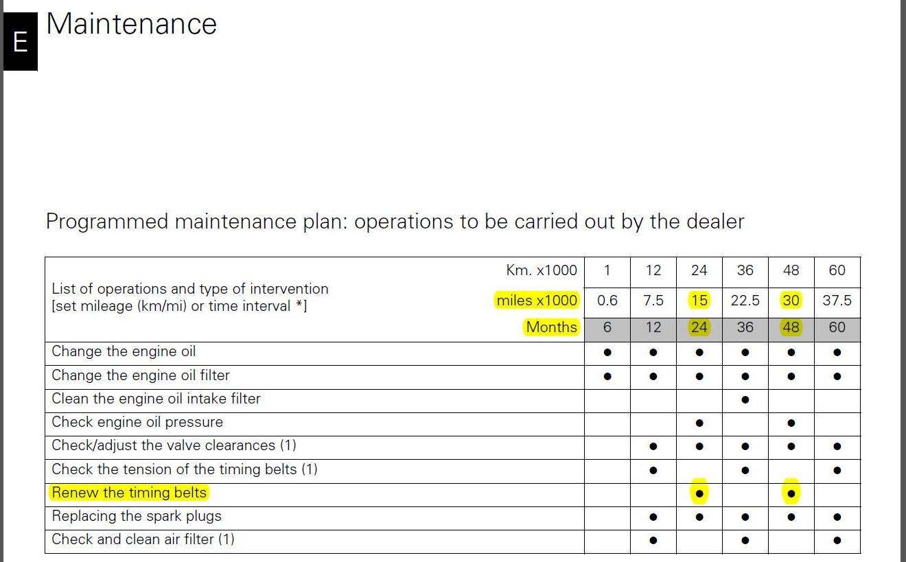

    Download the user/owner manual from here Service and maintenance motorcycle | Ducati (drop down menu right hand side) it'll give you a maintenance schedule in there
    When the time is right @Exige is your man for belts :upyeah:

  11. No. It's something like every 2 years or 12k mls. Check the service book. Most go 3 years quite happily though.

  16. Every two years dude, they DO break... more so if the bike is not used too often as they dry and become brittle (from my limited understanding).. most dealers do this for a reasonable amount.. although if you have a Pani then you don't have this problem
  17. so every 2years at most. and every 5kmiles at most.
