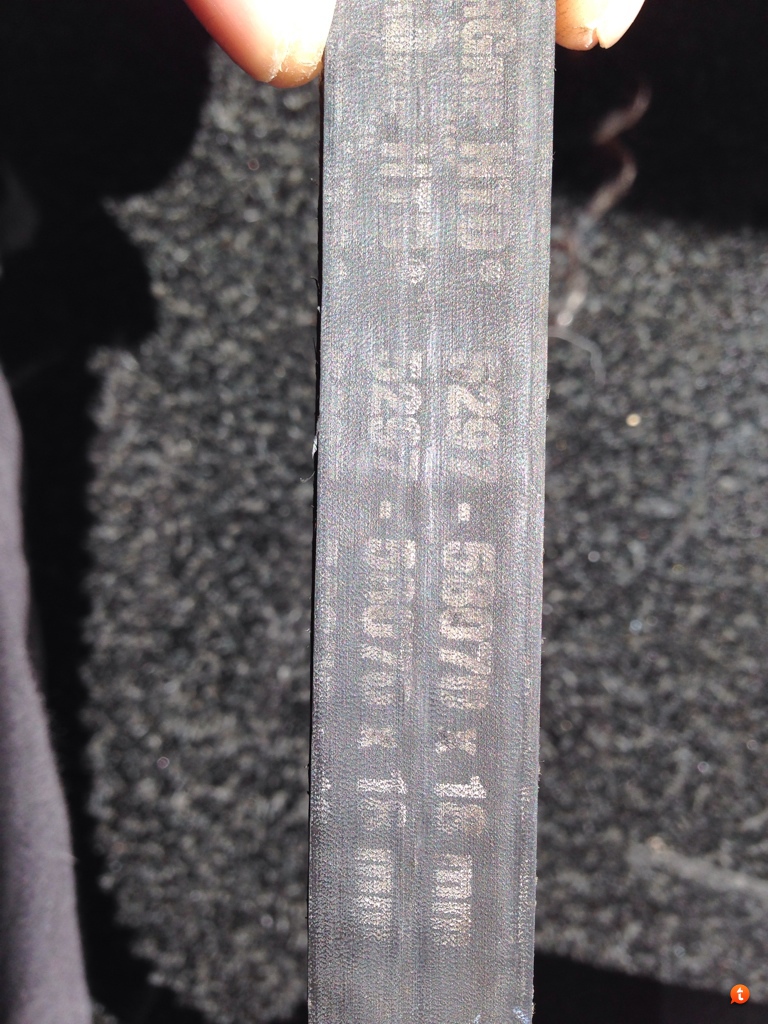

  7. Just use Gates 5297
  8. Thanks.........I've already contacted Gates anyway, but that must be a good starting point because it seems there are several variations some of which may be more serviceable.......
    However, I think you will find that 5297 are round tooth belts and not to be fitted to square tooth pulleys....Possibly there are 9257 which are also round tooth.

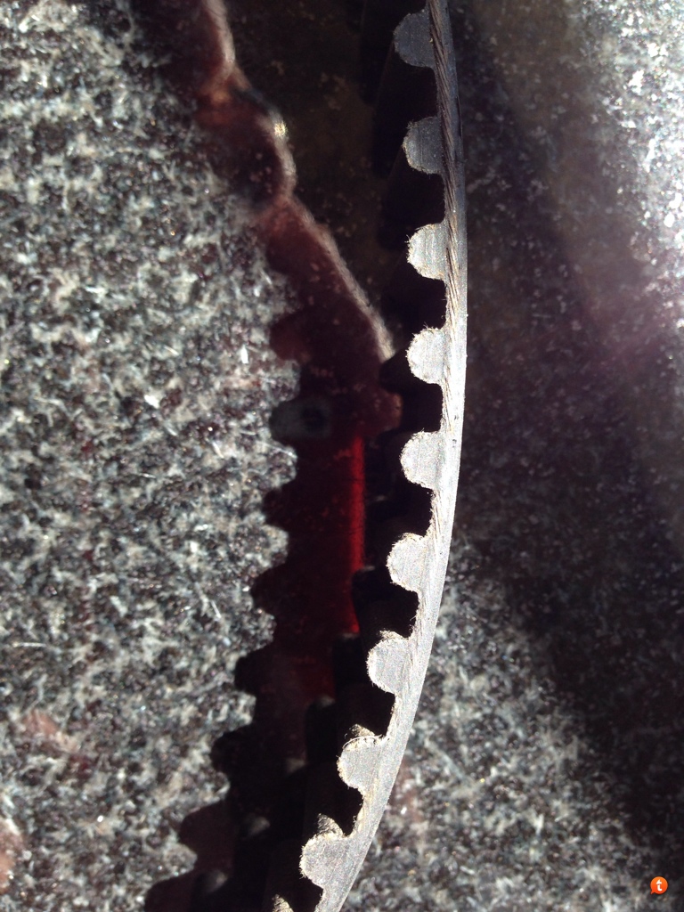

    "PowerGrip HTD 5297-58070 x 18mm" I have a '94 900ss I think all 904cc aircooled are the same but don't quote me I wouldn't like to be sued
    Photos for your pleasure.
    [​IMG][​IMG]

  14. Sorry, but I think you are missing the point...........
    Looking at your photos, you have round tooth belts, which means you have round tooth pulleys.............
    ........there are loads of us that have square teeth pulleys so we need square tooth belts, and they are what have been discontinued..........

  15. The square tooth belts are only applicable to 600/750 and are still available.
  16. Is you sayin' that the 900 belts are a different part number then?
    'Cos if so, I won't have to worry as I was sensible having a 750.....
  17. Yep. The 900 belts are different....longer and with round teeth :)
