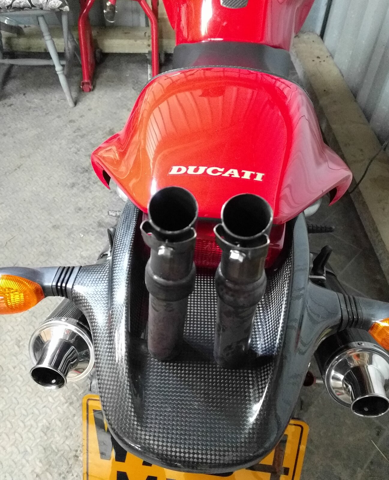

  1. Don't laugh. .. but after removing the dB killers from my BOS cans, I'm left with an annoying little hole in the end pipe, and, being a bit anal, I'd like to tidy it up with something. Ideally not a bolt, more like a little grommet that can live in that environment. Any (serious) suggestions? IMG_20190330_170725.jpg

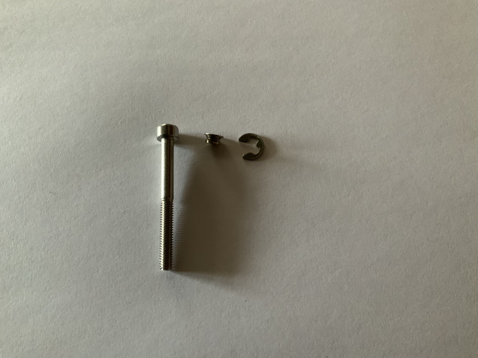

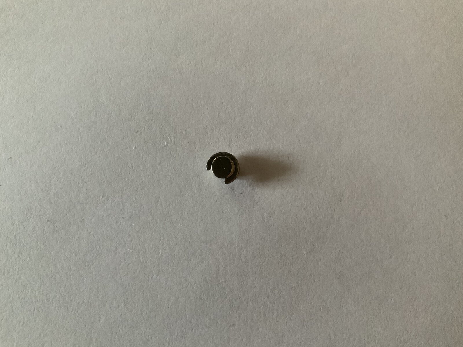

  7. 1: No access to lathe
    Get yourself a button head cap screw.
    Drill a tiny hole close to head and hold with Tiny R clip.
    2: Access to lathe.
    Get any stainless screw.
    Machine grove close to head to accept a C clip.
    Machine head down to 0.2mm say or smaller.
    In either case finish by cutting off excess screw. Personally I would opt for 2 as neat and less obtrusive but both fine. Both allow easy removal to refit dB killers.

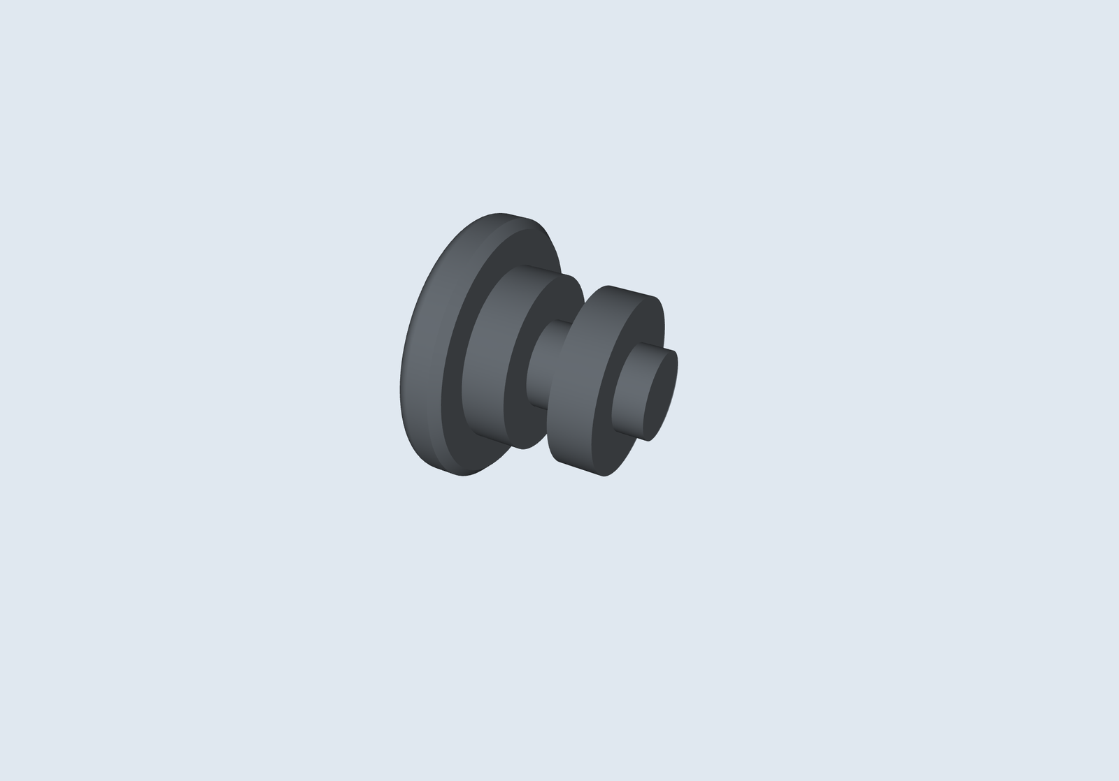

  8. Here you go..................
