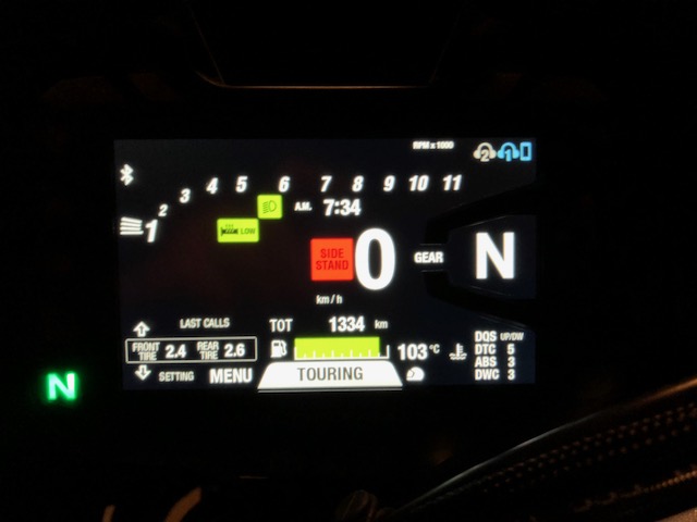

  1. Initial oil service today on the 1260S and i had the tire pressure sensors fitted. Instantly the display shows front and rear pressure. At 4 degrees C and rain back from service I could watch the pressure go from 2.5 bar rear to 2.7 bar after 30 minutes of motorway riding. A really nice and I think poorly documented function.

  3. The sensors are oem items from Ducati. When i picked the bike up for delivery I ordered them for fitting on the initial run in service. I saw a poor dash image somewhere online and figured I have to try this.
    They set me back around €450 including 1 hour work. I believe I was told they cost around €300 if delivered with the bike from factory.

  12. Hi, I´m not sure how this works. I guess they have to be paired with the bike somehow? I bought mine from the dealer, installed and activated.

  15. Thanks! Yes installed via the Ducati Software Links to bike. They each Have a uniique code which you input with keyboard to the software.... 1 for frt & 1 for rear and activate this feature from the software. I will ride later today & see if they trigger.
  16. Hi there
    As I thought, sensors must go in 'sleep mode if bike is not used. They showed pressures on dash after 1min driving. All good & work well. Cannot see that pressure can be set to show anything other than Bar.
