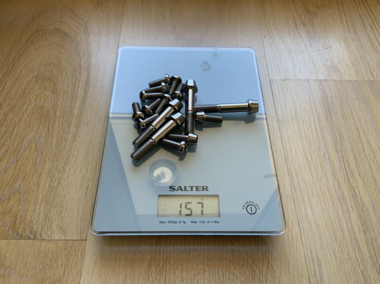

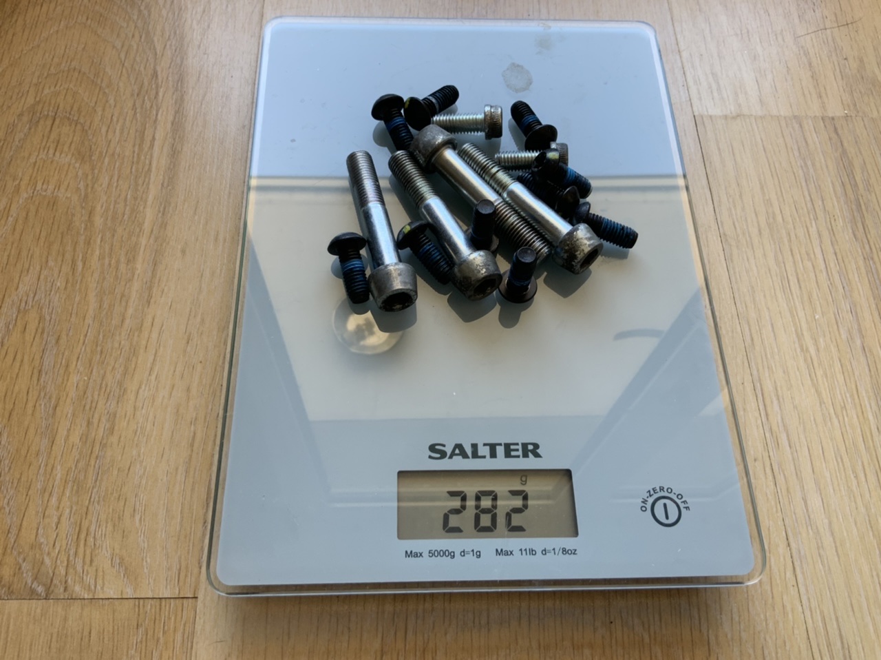

    Weight comparison of some of them below.
    66F6ED65-30AA-4929-8614-CCD108B492C0.jpeg 6CE84449-BDF2-44FD-8315-3100C00C431B.jpeg
