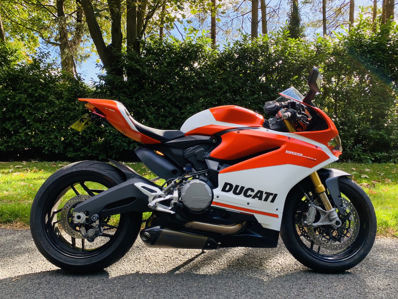

  1. I need help with some man maths - thought you lot might be able to help
    I have a 959 Corse with underbelly Akra slip-ons. Now I've got it into my head that I want the matching titanium racing manifolds. Not cheap at round £1500, plus I'd need the dealer to fit, so I guess I'm looking at £1800. I thought I could have it done over winter to maybe wangle a discount.
    The upgrade will remove catalytic convertor, so that should be a nice weight saving in itself. I'd get the nice Ti manifold, and I'd be rid of the ugly plastic heatshield, replaced with the lovely carbon version - I do like a tarty bike.
    I also assume it will also be louder (still able to pass trackday drive-bys?), and unleash some more performance.
    What do we think? Is this a worthwhile upgrade on a 959, or would I just be throwing away money?

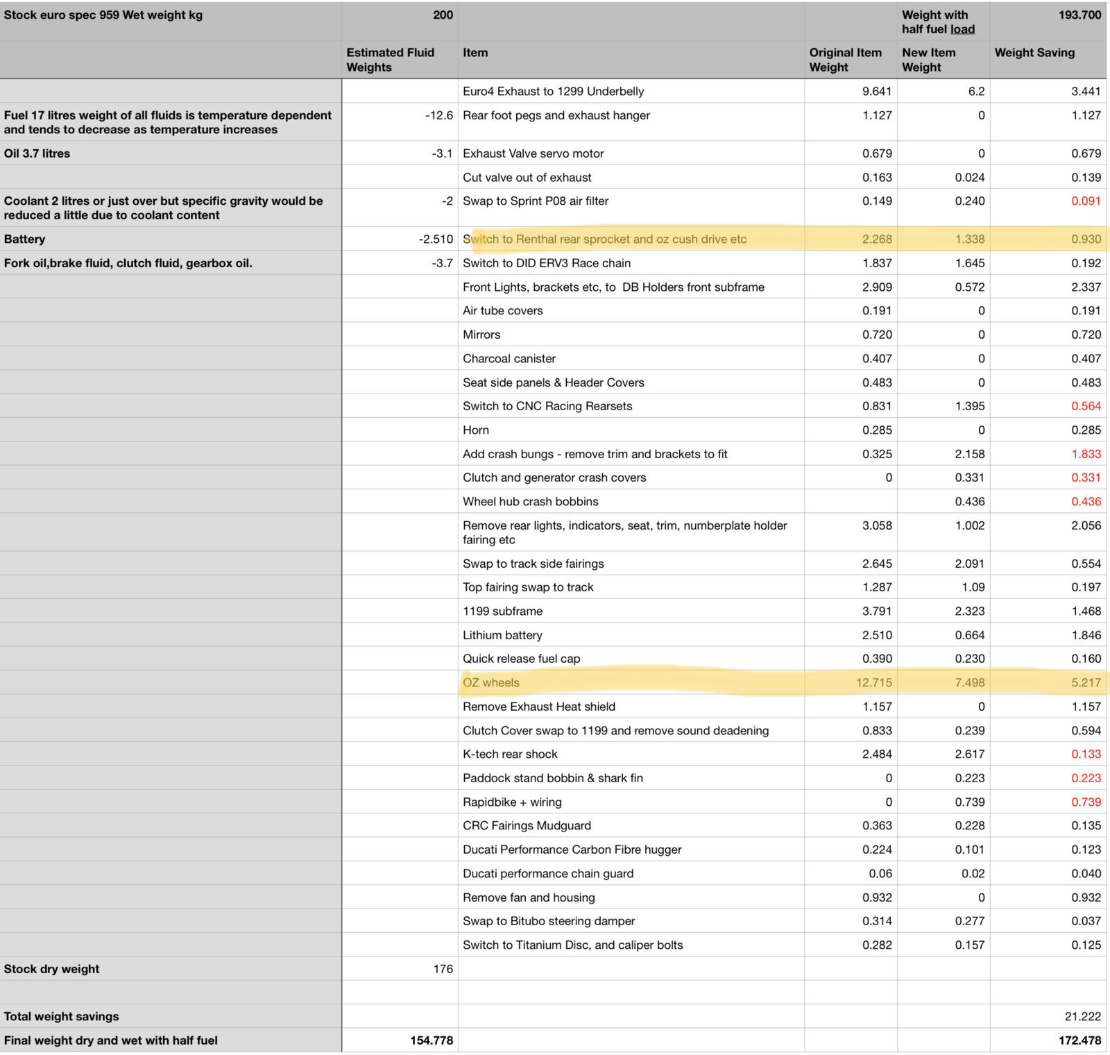

    The wheels on the 959 are exceptionally heavy - especially the rear - check out the highlighted items below for the weight savings on OZ Gass - mag or carbon wheels are lighter but there’s a trade off in robustness.
    This is unsprung rotational weight - I can’t express the bang for your buck advantage enough!
    My thread has some pictures with individual wheel weights.
