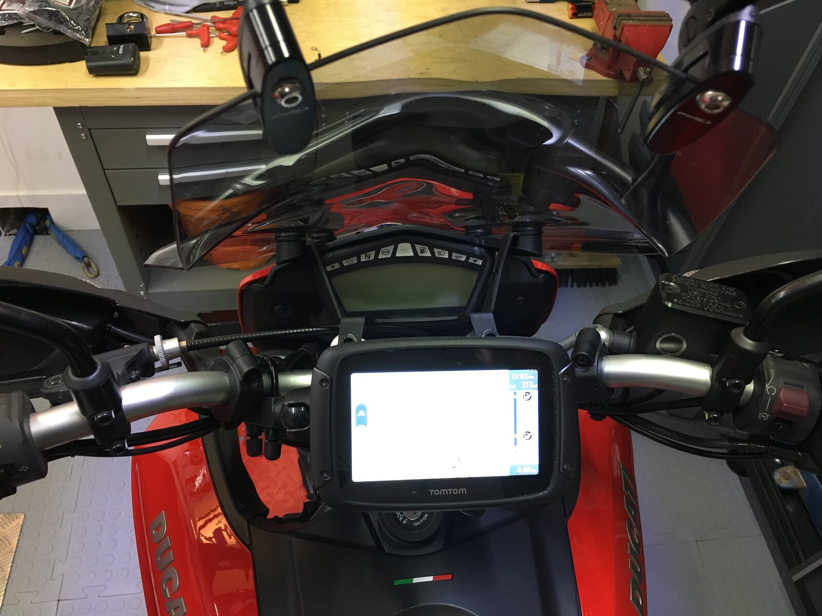

  1. hi could someone please advise the best way to wire a Tom Tom rider to my 939 hyper thanks in advance
    Scott
  2. Scott.
    I took mine directly to the battery. But if I had my time again, I'd go to the fusebox under the LH panel of the bike.
  3. Thanks man
  4. There’s a switched live taped up in the loom behind the headlight. I used it for my Garmin, really easy to get to.
    Nose cone off, drop headlight bolts out. 25 minutes tops
