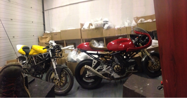

  5. Cheers Johnny boy. C spanner is for the lower nut? I am sorting the yellow one out at the moment.[​IMG][​IMG]

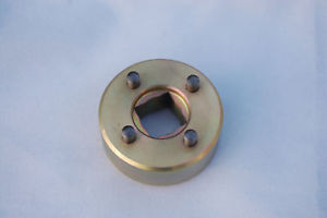

  7. Ah sorry c spanner is for the carby. You need a readily availble tool like the one pictured which has the pins on it. I got one for my ST. Works great
  8. Yes I forgot to mention i have the much improved version......

  12. It isn't impossible to make your own tool for that top nut thingy.....(another silly nut invention by Ducati to stop owners doing work themselves, they think)........
    You could make it from a large open end flat spanner and drill say, four holes in the right position and either tap them for an appropriate diameter hard bolt or screw........Or you could use hard nails of the right diameter, heat up the spanner and drive the nails thorugh the holes, then grind them off to the correct length (when it has cooled down)......
