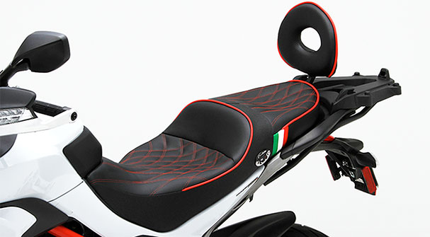

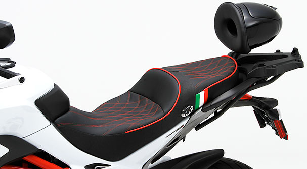

  8. Maybe this? :)
    Or this?

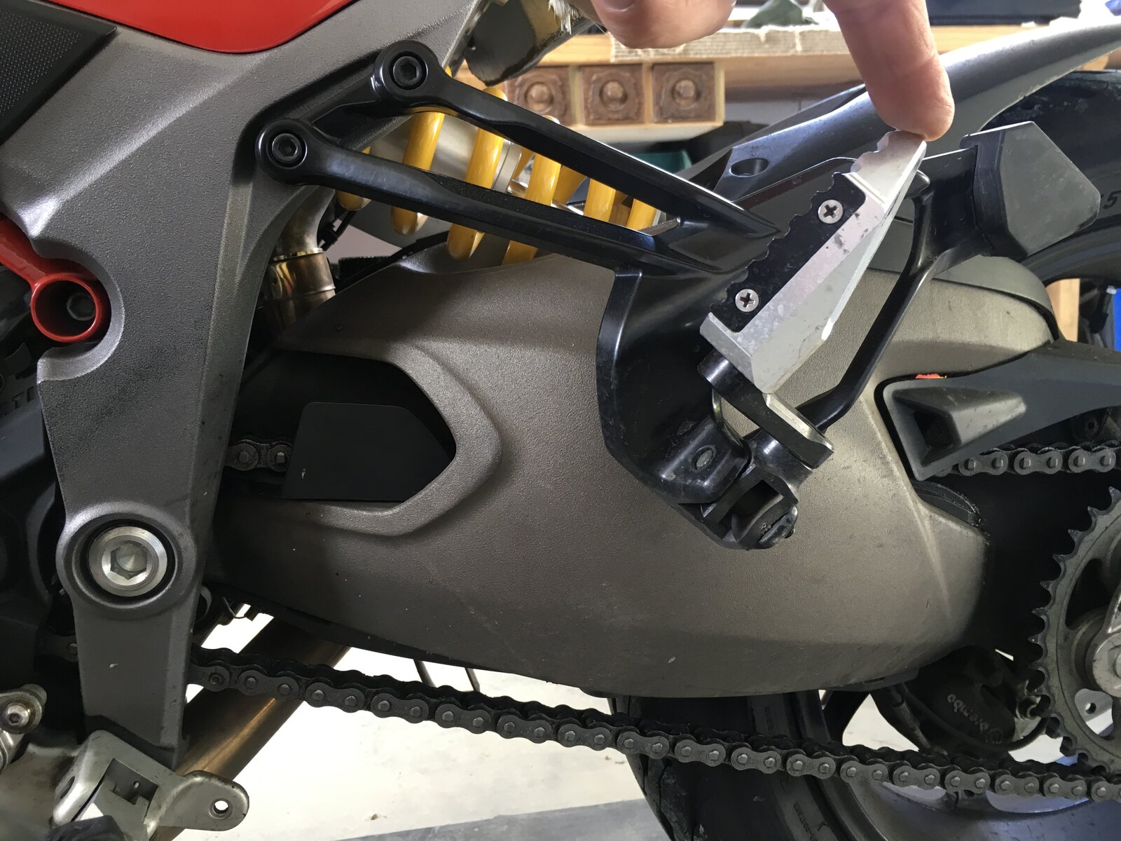

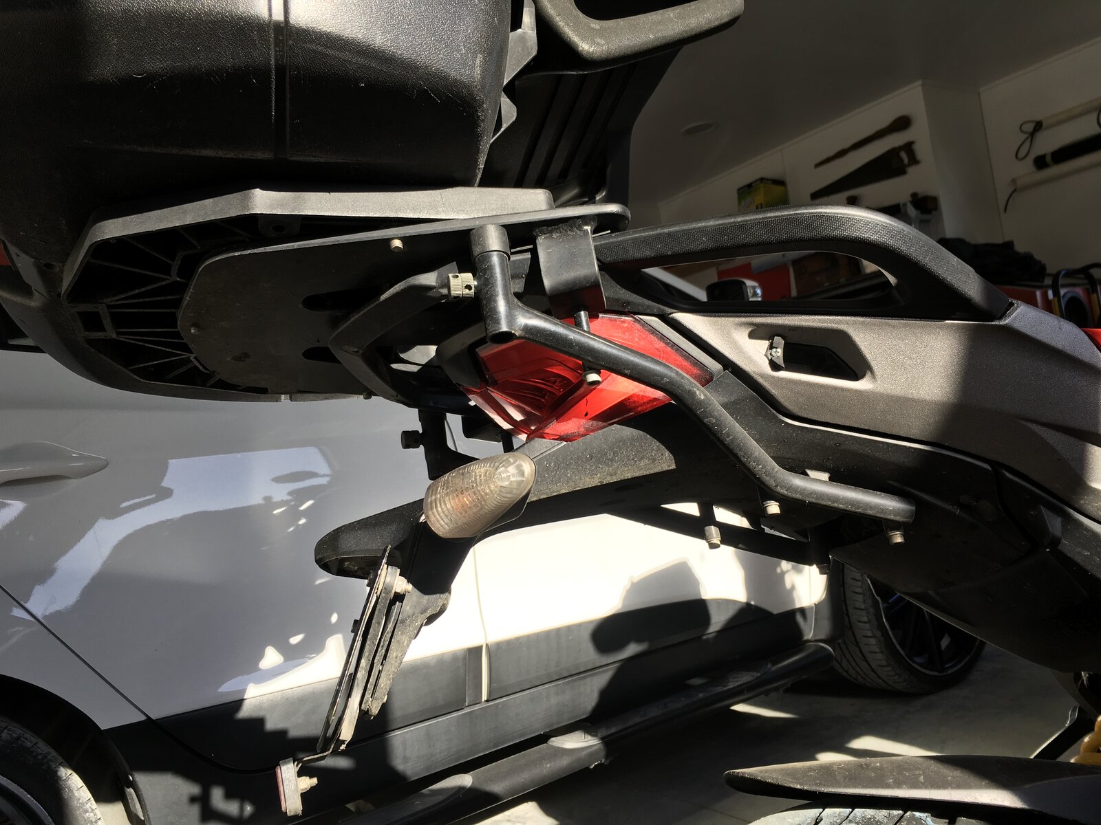

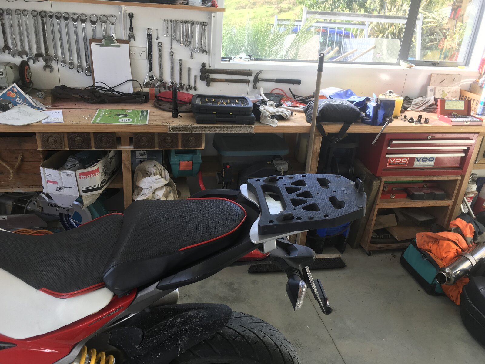

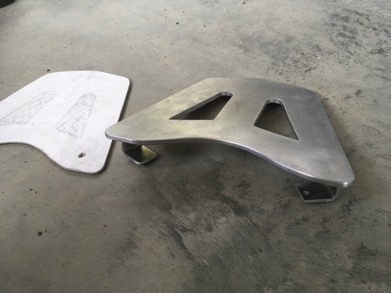

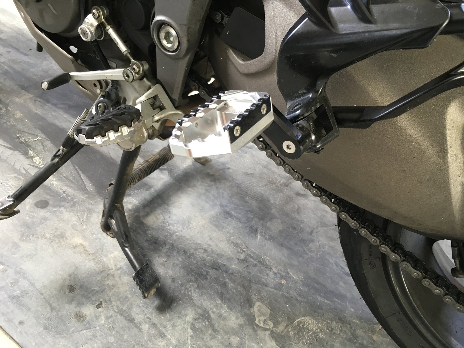

  9. IMG_0703.JPG IMG_0708.JPG IMG_1198.JPG Mine had a badly mounted givi resin plate on it when I got it and it was very flexi. Too weak to suppert my wife leaning back against it under acceleration. But research tended to show all the various plates mounted too far forward IMO so I made my own plate, mounted it with a ventura support bracket from underneath and remounted the Givi plate on top. Solid as a rock. Then the pillion footpegs needed to be moved forward and up as she could only have her heels on them with panniers attached. Cheapo ebay pegs worked lovely.

  11. My girlfriend has the same problem with footpegs and the panniers, can you provide a link to the footpegs you used please.
  12. Did you steel that plate from a ship's hull. Yowge.
  13. Be aware that the Ventura rack from the 1200 DVT doesn't fit the 1260, Ducati changed the grab rails just enough tom interfere with it
  14. Yip, I steeled it from an aluminium hull, it is pretty lightweight!
    Sorry couldn'd find a link but were dime a dozen when I bought them...
