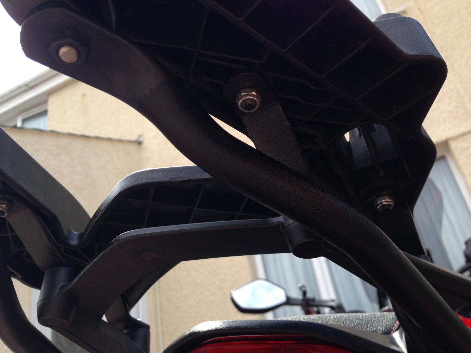

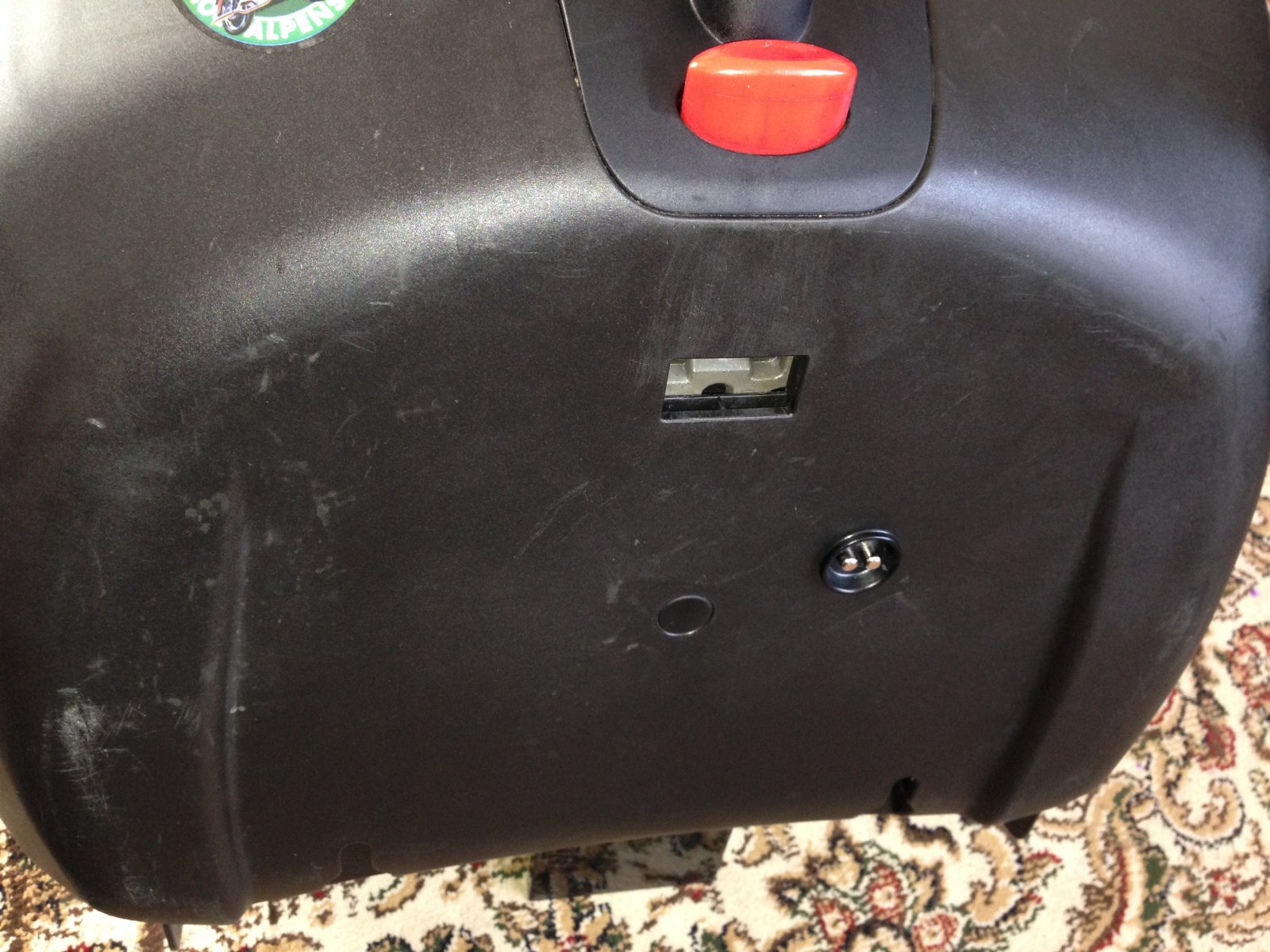

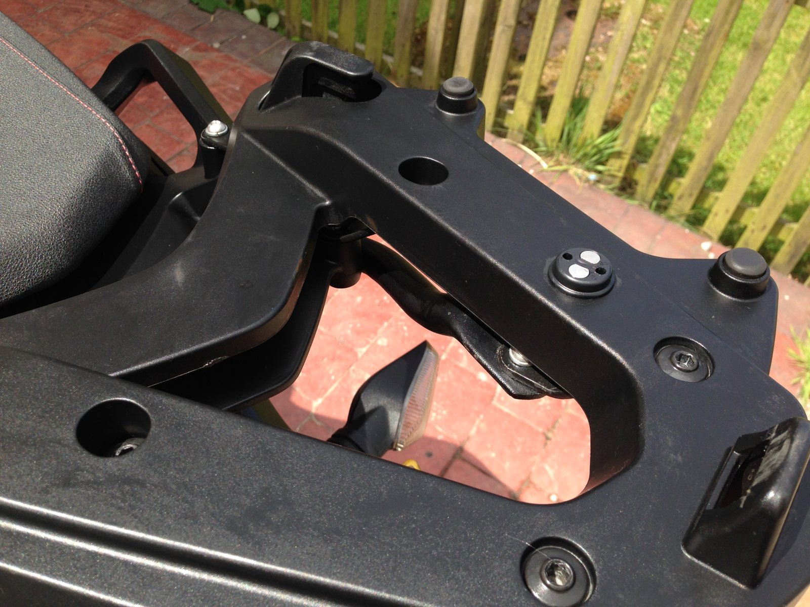

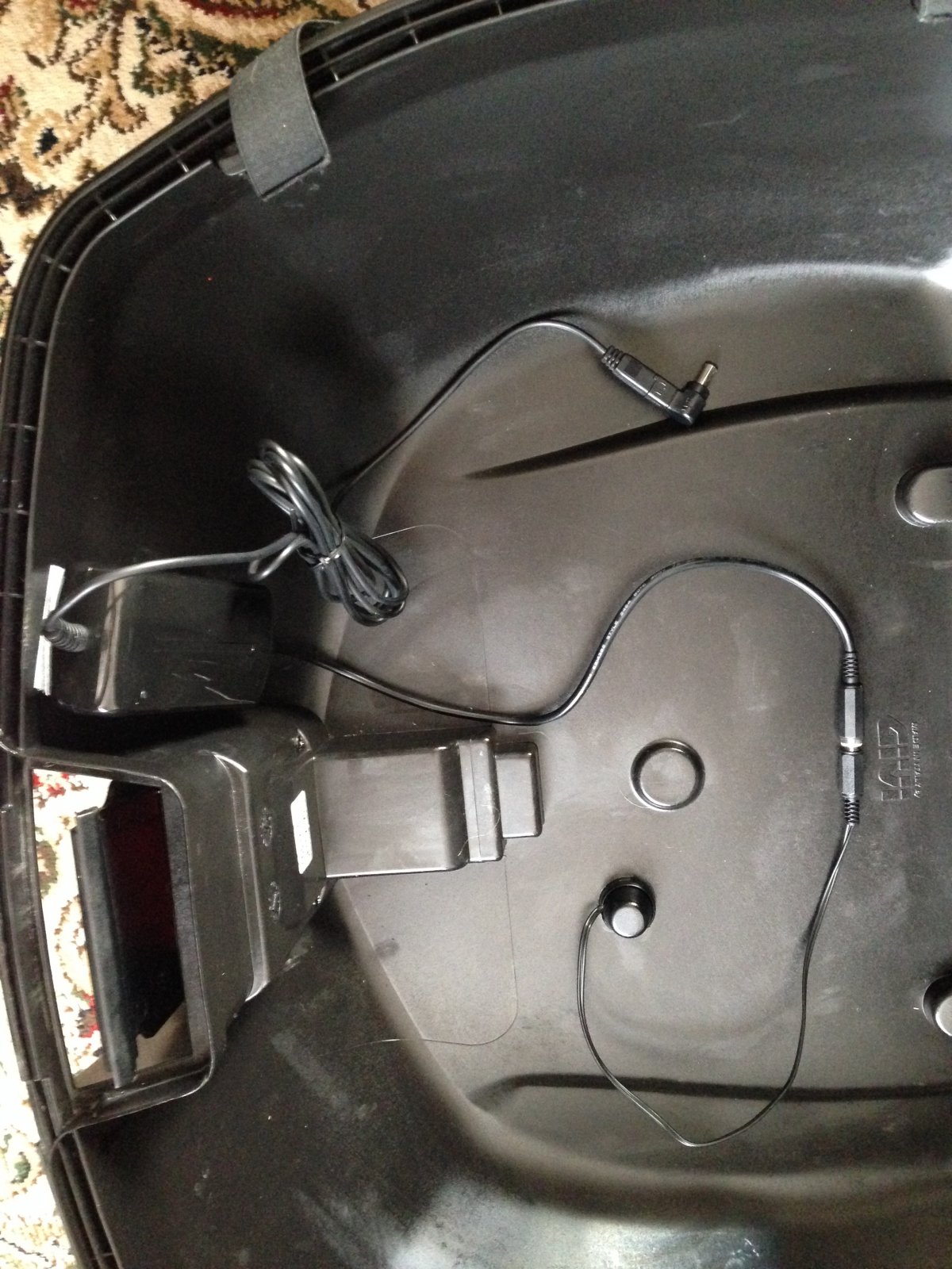

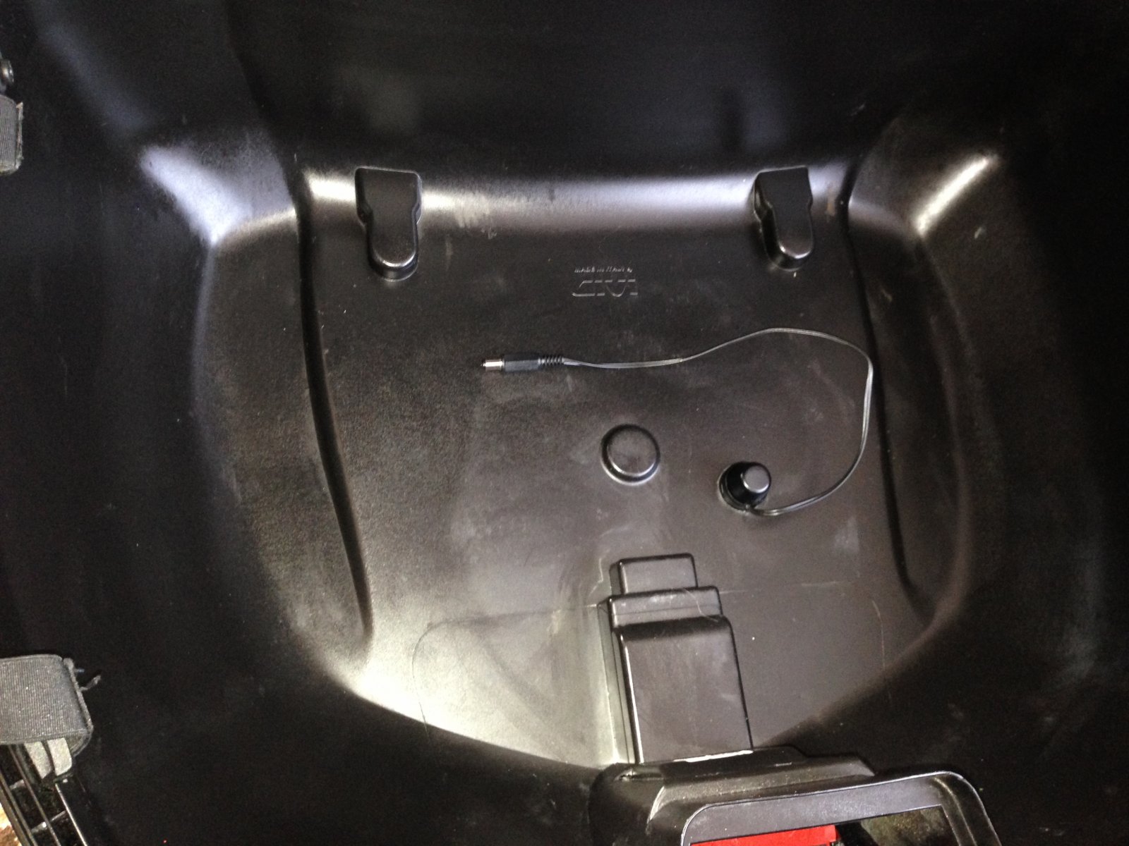

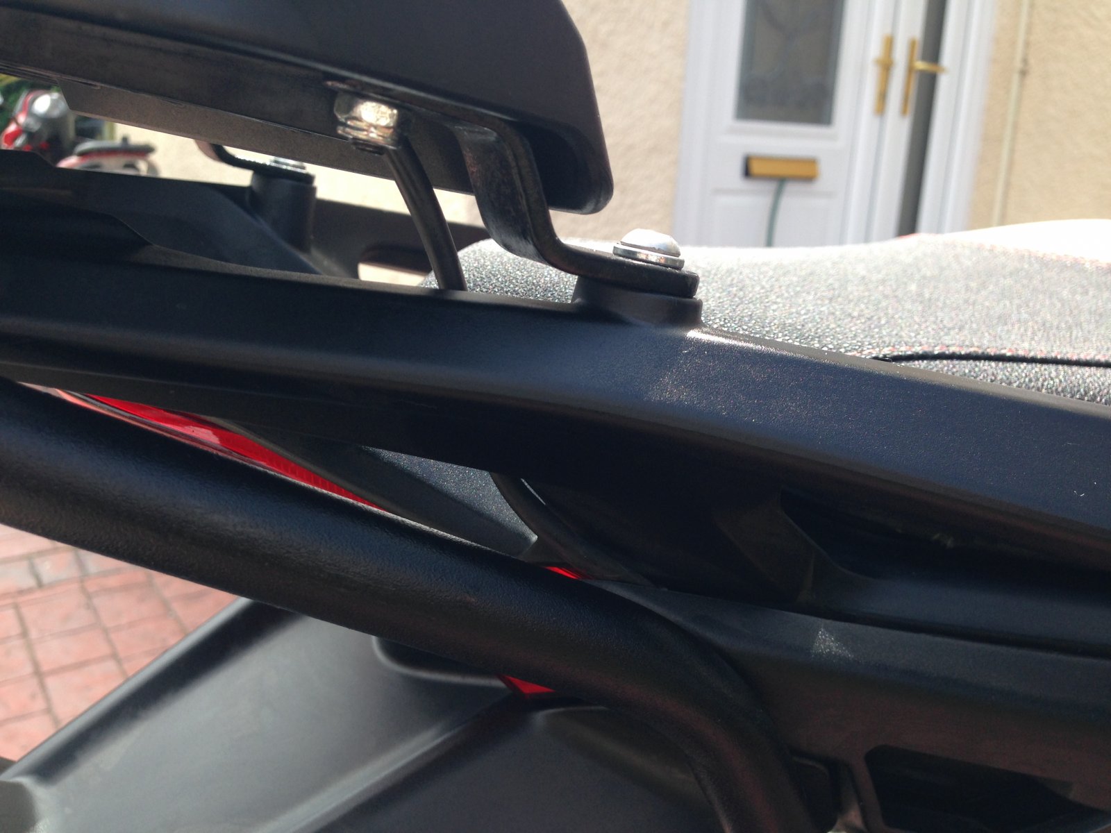

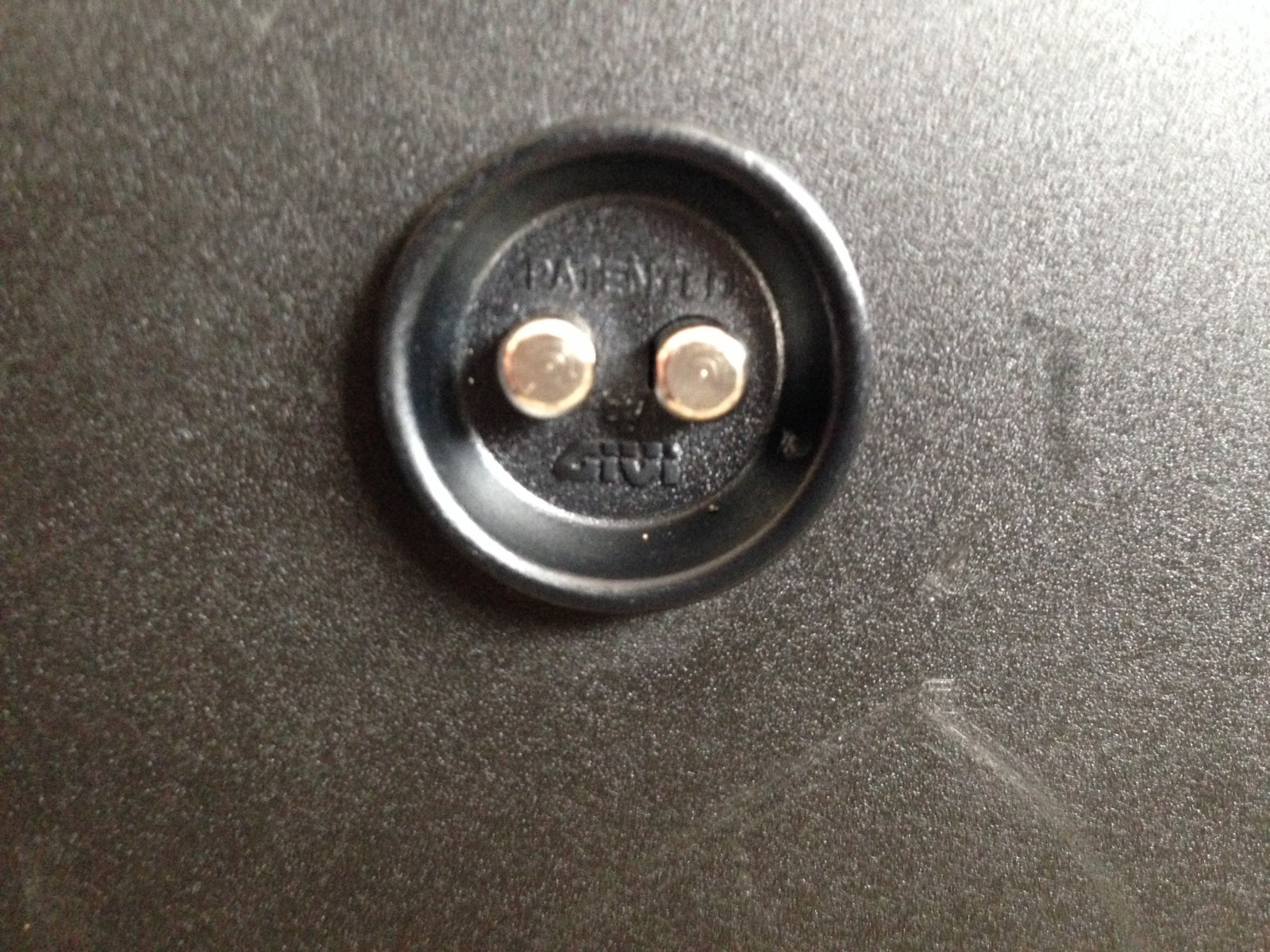

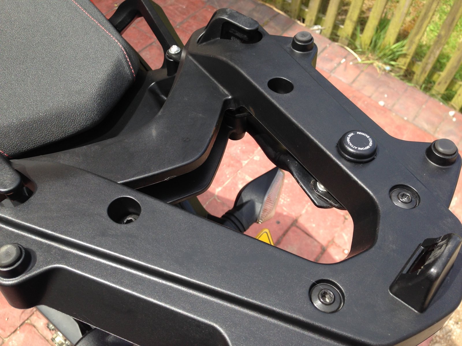

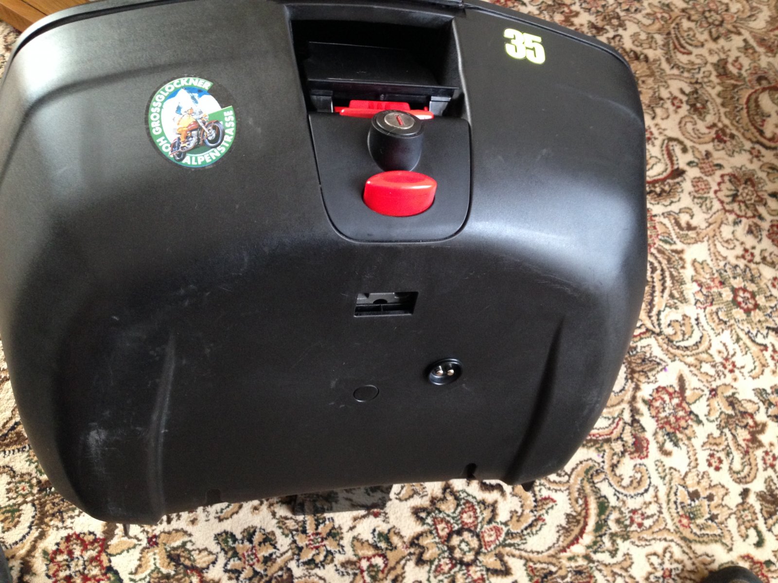

  1. Ok after all the USB charging crap in this thread http://ducatiforum.co.uk/threads/new-tank-bag.34761/I decided to share a mod I did to my top box last month.
    I orderd these Givi Z880 Plate Mounted Contacts | Bykebitz - Givi Z995M Contact | Bykebitz
    I started off by removing the mount plate, and using a dermal I cut away some of the plastic lattice under the mount plate, just enough to make room for the plate mounted socket, I then channelled some of the lattice so I could run the power line along it towards my back light. Then I fitted the top box and drilled through both with a 4mm drill, so I had a datum in both parts for cutting the hole for each socket (base plate and top box). I then cut out a bigger hole in each with a 14mm hole saw. Then to make sure the holes were a nice tolerance fit I used a tapered grinding stone in my drill removing a bit of plastic at a time until I could just get the socket to fit.
    I sealed the wires with some clear silicone and refitted the base plate to my bike. I routed the wire through the channels I cut in the base plate lattice and through a gap between my back light and trim, I broke into the circuit for the under seat power sockets, I was thinking of using the socket and just fitting a plug to the end of the wire but I'm not so sure those sockets and plugs under the rear wheel arch are water proof. So I broke into the same wiring and soldered the wires to them I also fitted a micro blade inline fuse 3amp in the circuit just for a bit of extra protection.

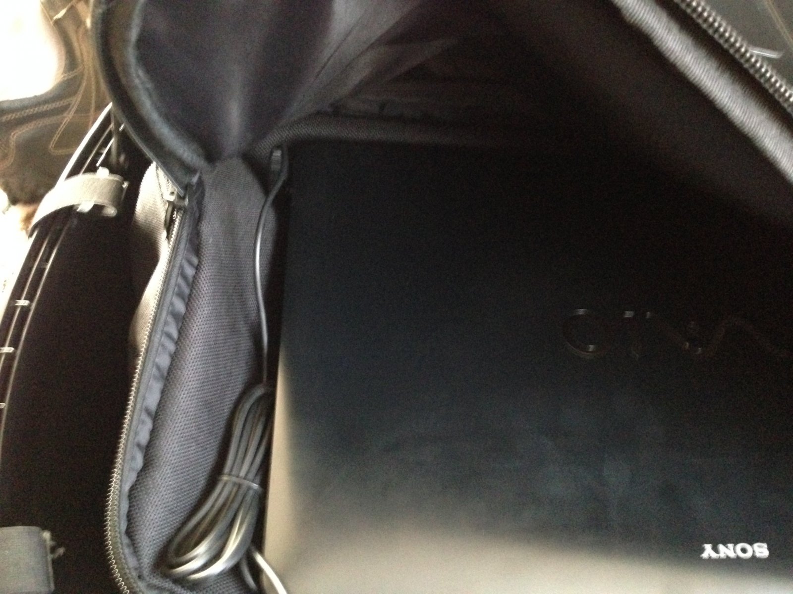

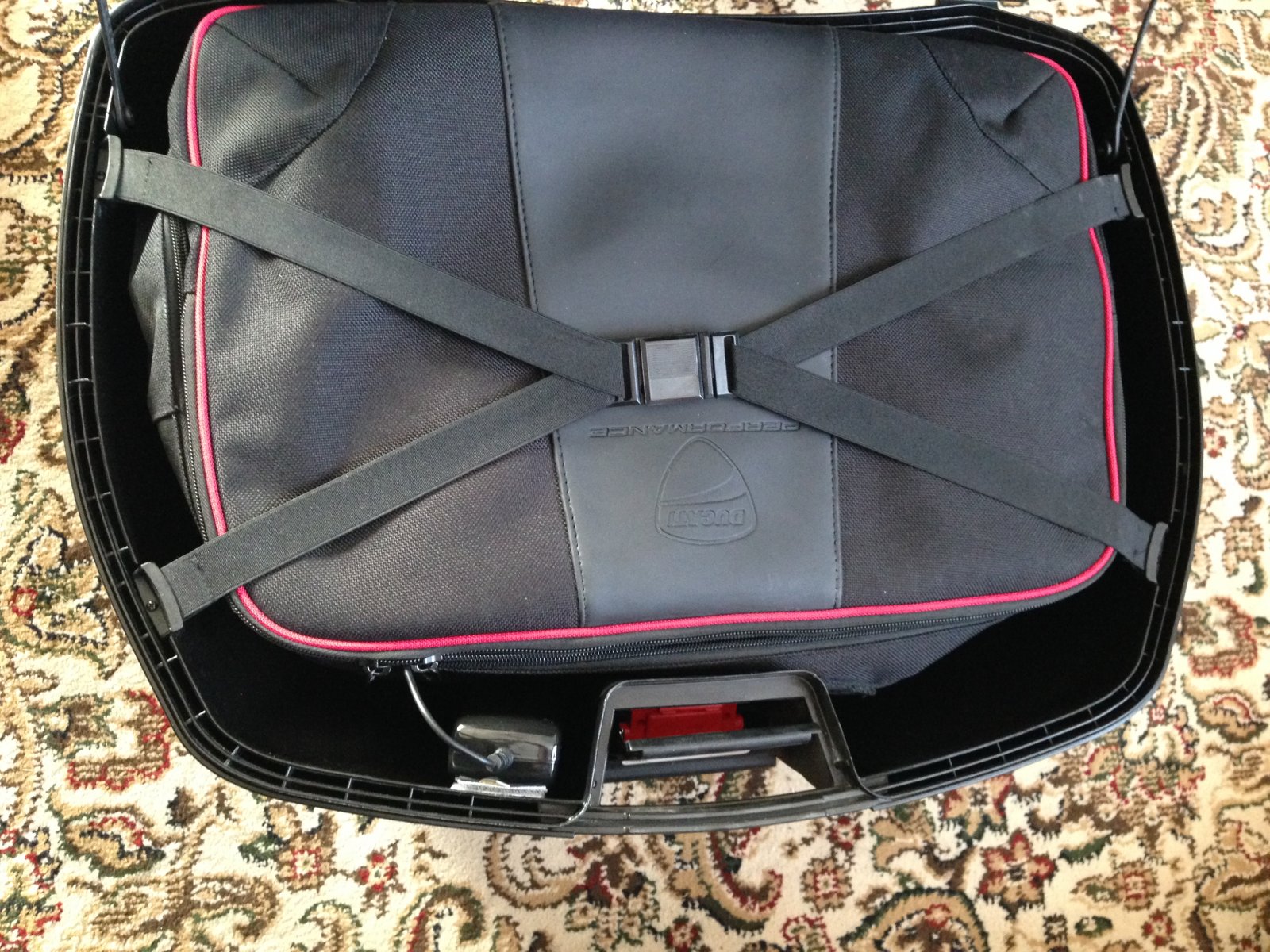

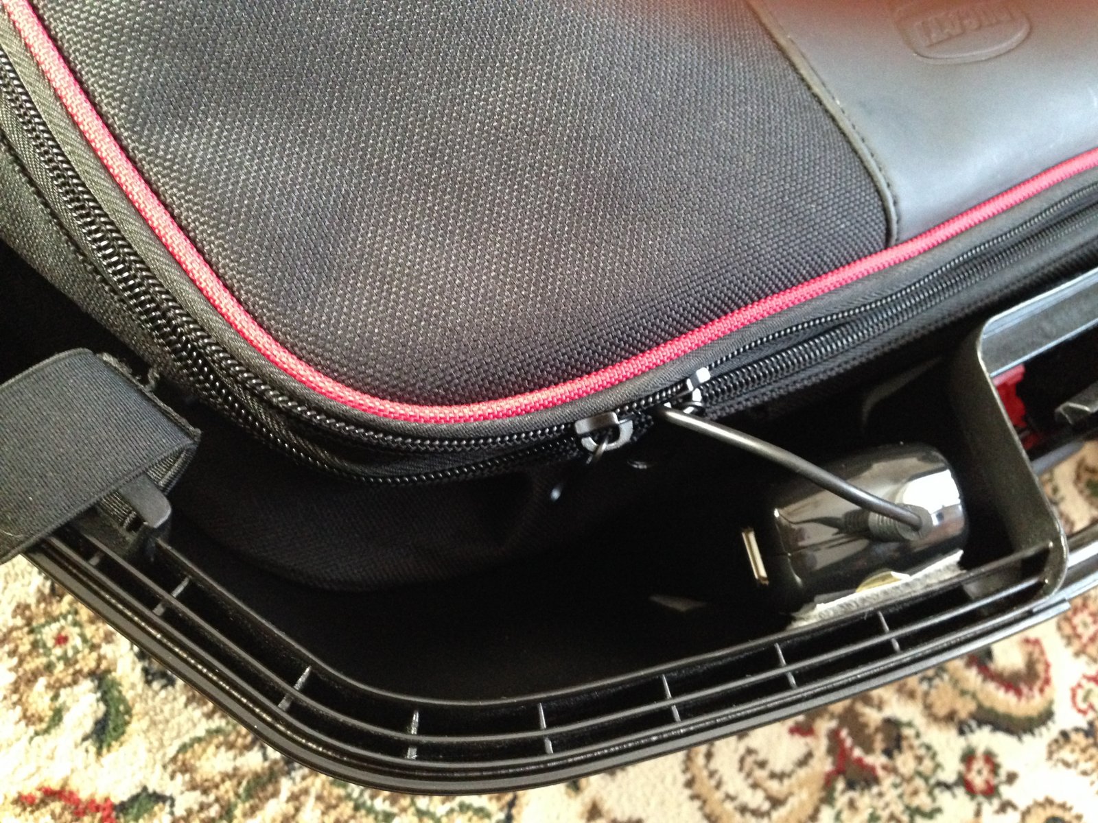

    In the top box I velcrode one of these http://www.maplin.co.uk/p/nikkai-12...ith-usb-socket-1a-with-6-charging-tips-a19jtI
    cut off the cigarette lighter type socket and fitted something a bit smaller, I know it would have been handy but I just felt it was to big n clumsy for in the top box.
    any how here's some pics.
