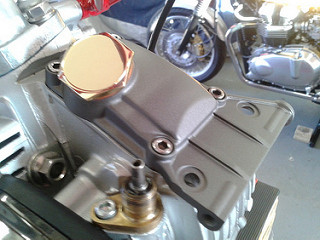

  6. Cheers!
    Got that bit sorted... used an i.e. cover so as to not foul the tacho cable
    Valve Cover by Lindsay fae Angus, on Flickr
