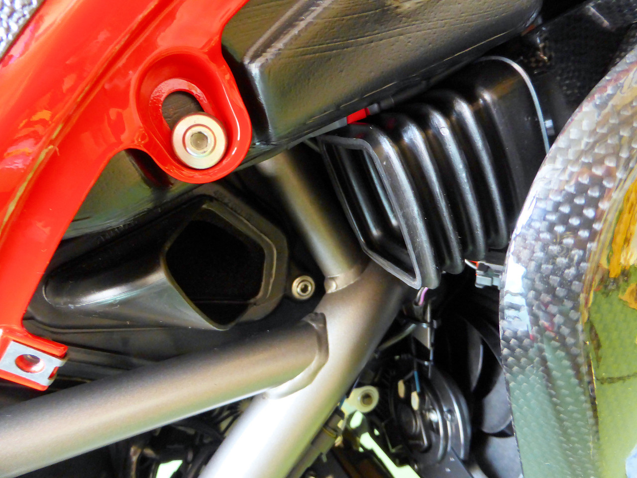

    AirConTechnical - Info for you. | Ducati Forum
    My modification was to open up the left hand (when sat on the bike) of the air box. Thoughts at the time was this would make a big difference.
    The noise is to die for...real Ducati induction noise....beautissimo .
    CJS Racing has since modified his thoughts, however to be fair that is on removing the off side snorkel connection right hand (when sat on the bike). I always left mine in.

  12. There is no dynometer on this country. How about I do this modifications like the photo with out dyno. Would you recommend it?
  13. The current wisdom (consensus) is that this is not a good modification.
    But I'm sure that some will disagree.....then I'd do it just for the noise....who cares if it won't do +145Mph.....the grin factor at normal speeds is to die for.
