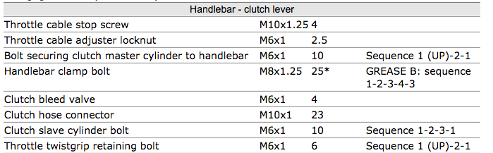

    Ive just fitted a new pair of Rizoma bars to my SFS and wondered if anyone can tell me the correct torque setting for the 4 allen bolts on bar clamp?? Also has anyone tried to take the plastic bungs out the end of the old bars without destroying them??

  2. Jack, 25Nm in the sequence below. :upyeah:

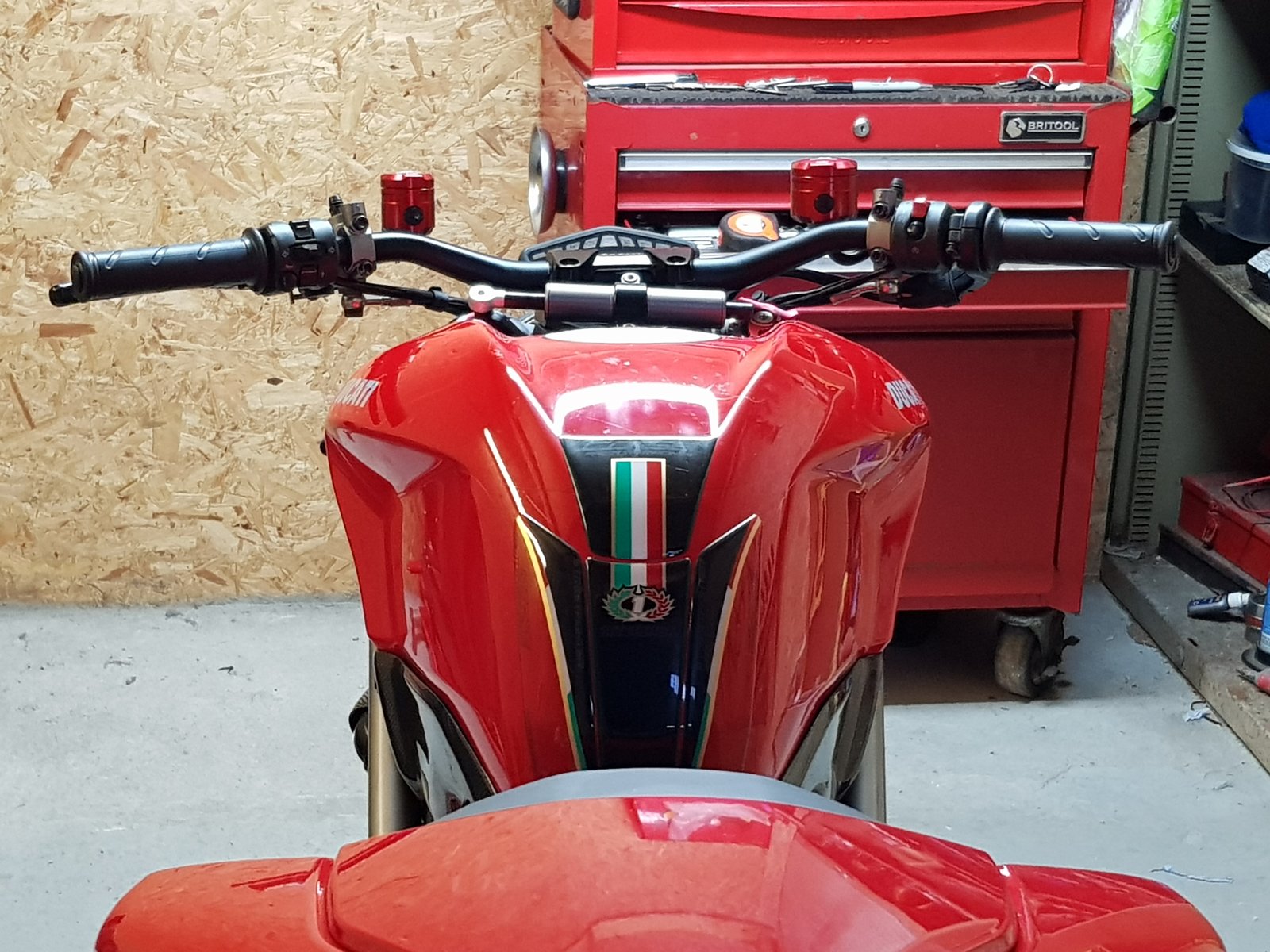

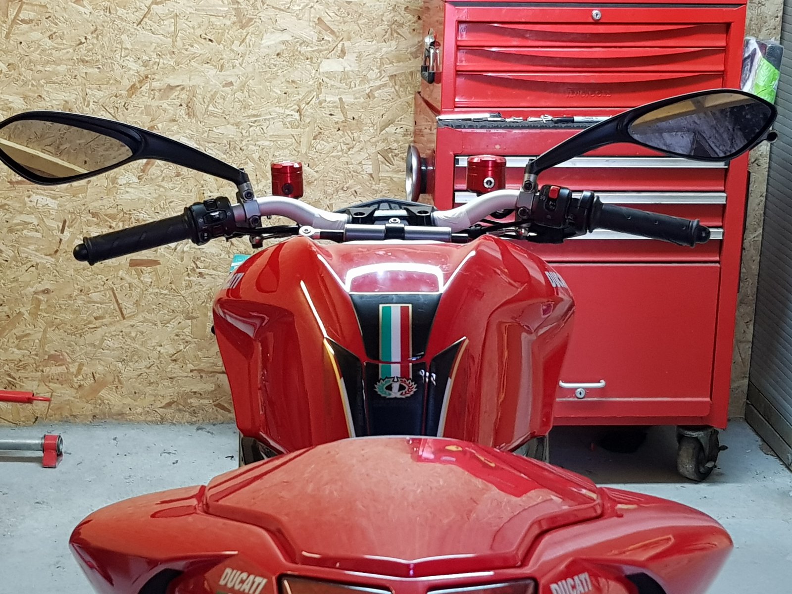

  3. Thanks a lot mate, Just what I'm after, will get it finished after the WSB in morning, Heres the difference the Rizoma MA006 makes if its any interest to anyone, Perfect and looks tidy 20180324_173630.jpg 20180324_144443.jpg
  4. They look a bit wider and a lot flatter. :upyeah:
  5. yeh they sit a load flatter, The Rizoma bars are 20mm wider in total, I'm just glad I didn't go for the MA009 that a lot of people use, Would be just to much rise for me
