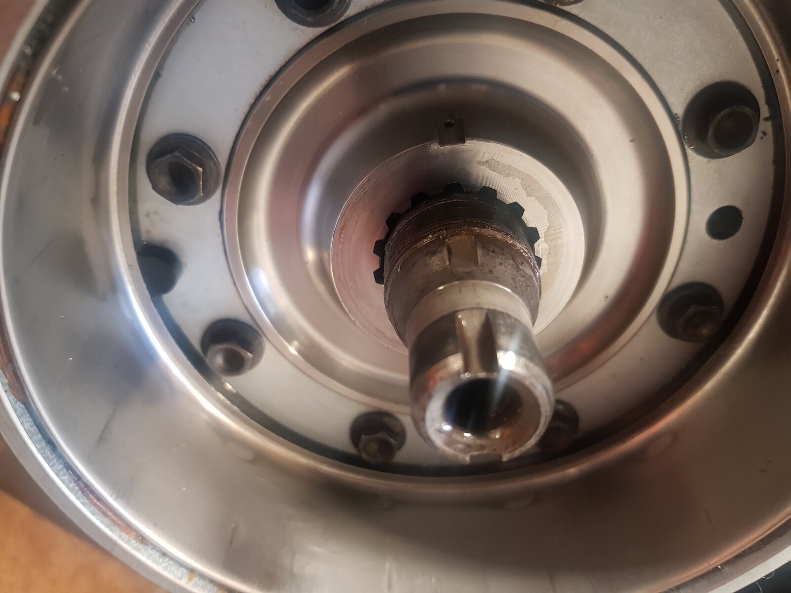

  1. As above i just want to be sure (but not) im reading torque settings for attaching the flywheel with the 8 bolts to the starter sprag mechanism behind it as 13nm?? seems really light based on the fact i nearly burst a blood vesel getting each one of them out (and fucking one up) - unless they were in too tight in the first place of course....
    Cheers to anyone that chips in...

  11. In the garage....re assembling..... the old bolts were definately way tighter than whats gone back on...anyway....digressing....the sprag clutch assembly: does this locator assembly on the flywheel mean anything ( i cant find anything n the service manual - im assuming it lines up with the marker on the crank.... )
  12. Groove on the end of the crank isnt for anything afaik, just line up the dot on the flywheel with the key way.
    The nut needs to be f*ggin tight, I bought a new torque wrench specifically for this job. If you have a standard flywheel then holding tools are available, as mine is lightened I used a lorry oil filter strap. I would also reccomend a new lock nut ( there are better aftermarket ones available), and the correct locking compound.

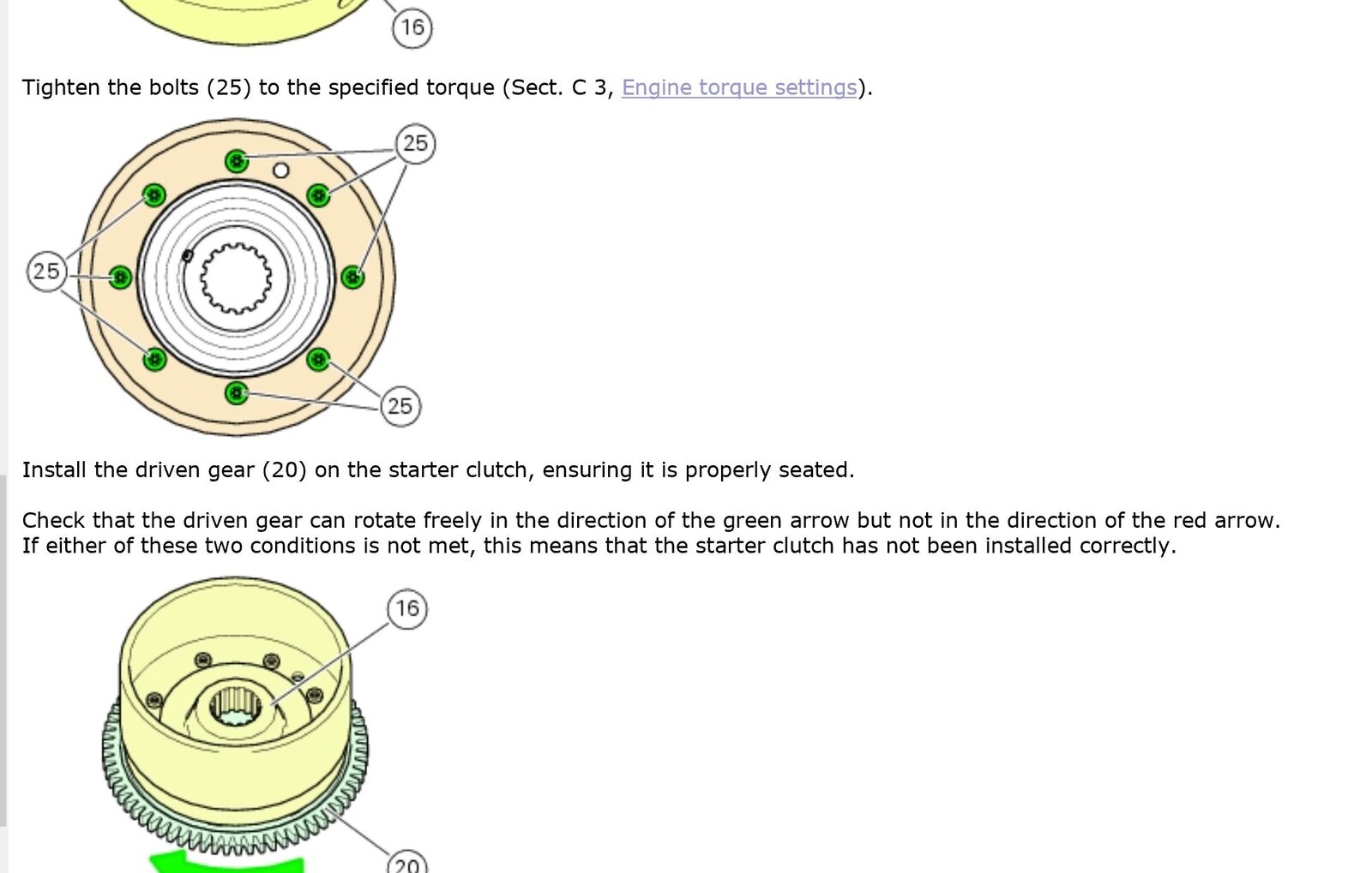

  18. The 1098R manual mentions to line up the notches, most likely feeds to/from the oil ways, might be something to do with balancing also:
    "Install the flywheel assembly (23) with the gear (21), aligning the notches as shown in the photo."
    Also, I have a torque wrench that goes upto 300Nm if you want to borrow it somehow. I got to 300 then pushed a little more and used plenty of threadlock. Also Nelly suggested to use a new nut, I think it has some clinch properties which mean that it can only be used once.
