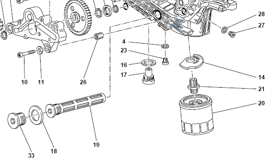

    Late 996 and early 999 engines are like this. I can't find the torque settings for 19 and 33. I can find the settings for the earlier 996(916/748) with the single oil strainer bolt and i can find the torque settings for the deep sump 999 but not for either of my bikes. Best educated guess is both are 42nm.
    Any advice/advance on this?

    From the 999 factory manual
    Mesh filter blanking cap M32x 1.5; 42Nm ;36Nm min, 44Nm max
    Oil Mesh Filter M22x 1.5; 42Nm ;36Nm min, 44Nm max
    Same settings in the 748S factory manual for MY02 except it states 42Nm +/-10%
