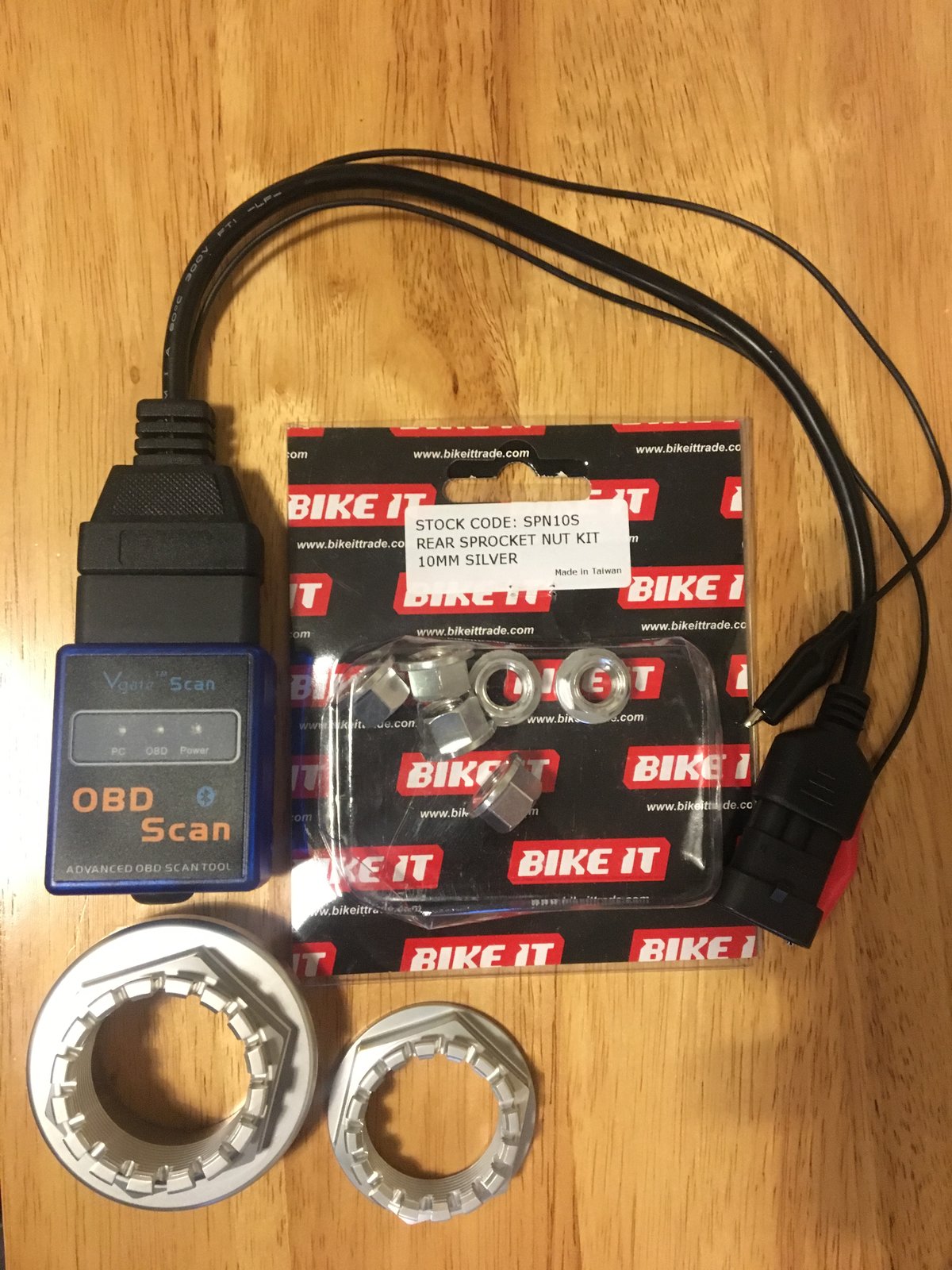

  1. Hi all. I’m starting to tidy up my 1100 S and have bought some rear wheel nuts and sprocket nuts.
    How tight should the be in Nm?
