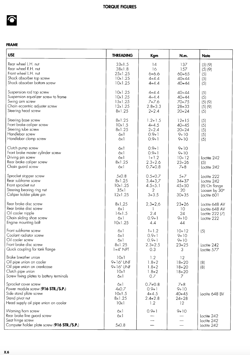

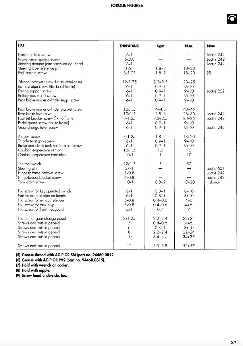

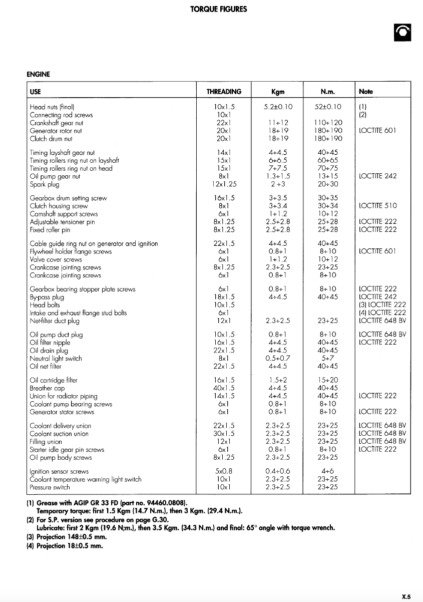

  1. Hi guys,
    I’ve had a heads up that my engine will be ready to collect next week, so naturally I’ll be fitting it back up as soon as I pull up at home.
    Has anyone got a PDF workshop manual for a 2000 748R that I can have to get torque settings from please? Or even a heads up on where to get one would be great!

  3. I've uploaded the full manual Here
  4. Thanks very much:upyeah:
  5. It's for the 94 - 95 bikes, but for torque settings it should be OK.
