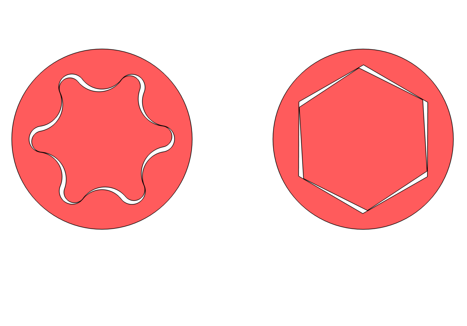

    This is my take on the subject and why I’ve moved to TORX keyed bolts both in stainless and titanium. I know some swear by hex which is fine and I’ve never had a problem with high tensile hex keyed cap screws but moving to stainless mostly for cosmetic reasons and titanium for cosmetic and safety critical fasteners like disc bolts have caused me no end of problem using hex keyed cap screws? I’ve never experienced any failures but I’m sure some have. Never had a problem when fitting and torque but when trying to remove they invariably round and the air turns blue? Moving to TORX keyed Cap screws have never caused problems. My hex keys are snap on so should be a good fit but here’s a pic of what happens with a 0.1mm difference between key and head. In the case of the hex when torsional force is applied its only the apex of each point that presses on the bolt and easily rounds both stainless and titanium bolts in my experience. In the case of TORX a greater area is covered reducing the risk of rounding. Basically the TORX head is more forgiving. Anyway here’s some pics.

  4. It's more to do with the angle of drive though isn't it :thinkingface: 60 Vs 15 ish

  7. Probably but that needs more thought. Just playing around with software.

  13. A couple of observations, the contact patch between the tool and the bolt head is larger for a torx, also the radius from the centre of the bolt to that contact patch is smaller and therefore the tool is less likely to twist out, although more pressure/stress at the contact patch would be required to undo the bolt for the same torque applied at the end of the undoing tool.
