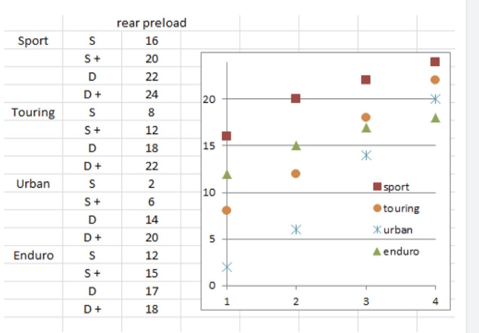

    I needed to set the my rear suspension. That made me remember this chart I’d found on the American Multistrada forum. For me, seeing the settings laid out visually suddenly made everything much clearer.
    1 to 4 being;
    1 Solo
    2 Solo + luggage
    3 Two up
    4 Two up plus luggage.
    I could see that Solo Urban dropped the rear of the bike, making it easier to get on and off but Sport obviously raised the rear end. Not being one for half measures and wanting it to ride more like the Tuono I thought f’it let’s bang it in Sport mode and put it in two up with luggage mode. Not terribly scientific but ‘Mike the bike’ aka bro 6 doesn’t hang about and I wanted us to ride like we were joined with a piece of string. Whilst being socially and sensibly distanced of course.

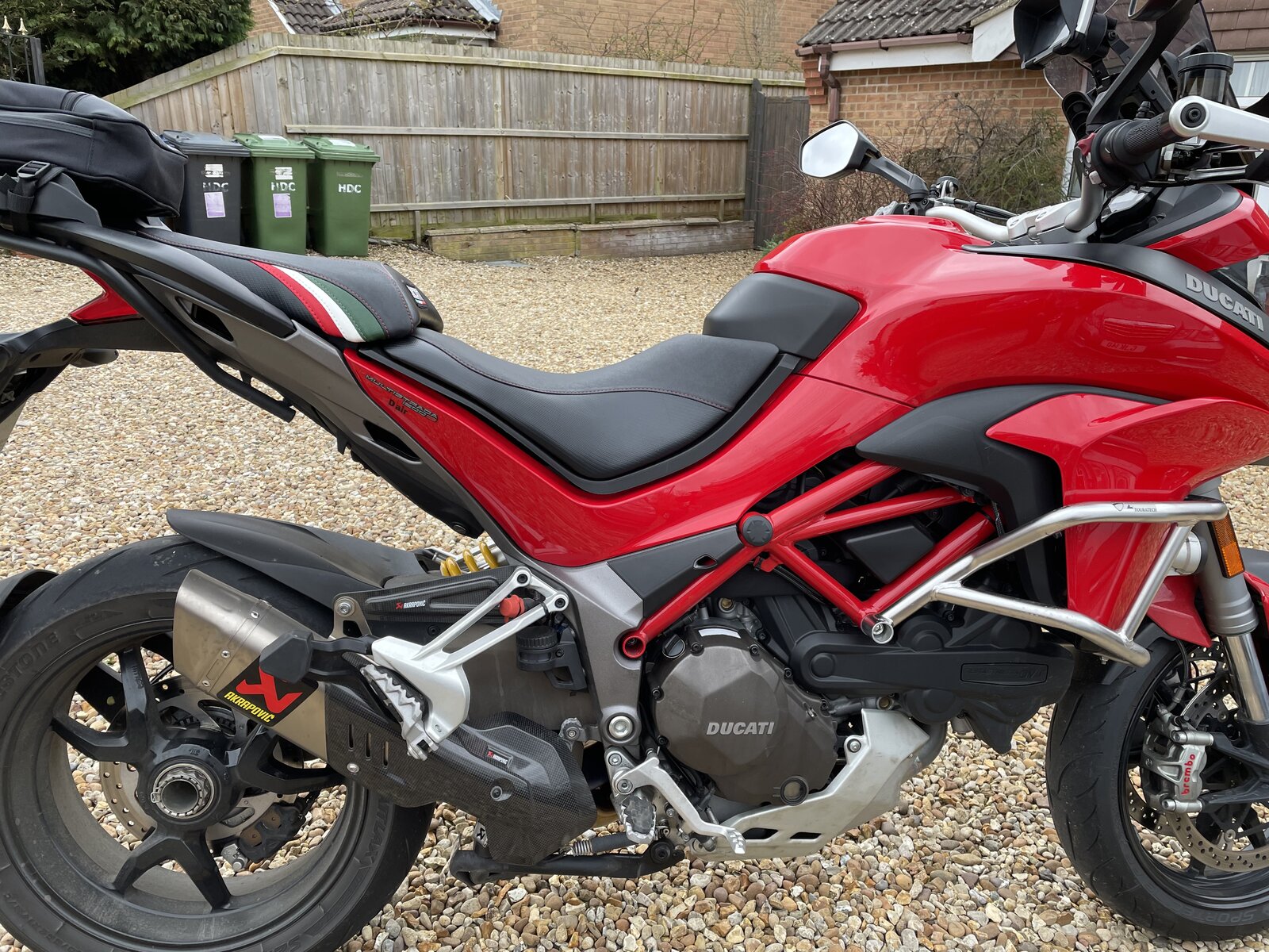

    Cut to this weekend. I’d had another go at having the seat reupholstered. Specifically raising the front and lowering the rear in order to make it more level. Making it more like one of those old fashioned tractor seats, a pan type thing. Put simply, redesigning it to stop the forward roll and make the seat feel level. Also, I had a gel pad put in.
    What a result. The seat is level, firm but comfy. Total happiness with it. In fact it reminded me of the seat on the GS which I found to be firm but all day comfortable.
    This revised seat also transformed the feel when on the bike. This thing went round bends like it was on rails. I felt glued to the road, when I’d set the bike for a bend there was no weave, no need for correction. It was a joy.
    I backed off the mode to 2 up and no luggage and dropped it into Touring mode. Softening it off slightly and it was still good. I swear it’s a combo of the suspension and the feedback from the revised seat. I was happy with the 2up and luggage mode but it’s all worth experimenting with.

  6. Seat looks good as well, who did that for you?

    Also, that seat looks awesome! I think I’m going to find a local upholstery shop and bring that pic above to do some economy stimulating.

  15. Suspension fiddled with. The settings were pretty well as per the chart but the front right leg didn't have anywhere enough pre-load, less than one turn. Winding back out and then almost three turns in (15kg per half turn as I understand it, I weigh around 85kg). Seems much better. Set damping to harder in touring will have to experiment.

    I might experiment more with this but I found it goes round fast bends with no weave once I’d done this plus adjusting the electronic settings. Without adjusting/firming up the electronic settings it wasn’t as good. This is touch of the button stuff, to either sport or touring and two up, with or without luggage, electronically. There was no actual passenger or luggage.
