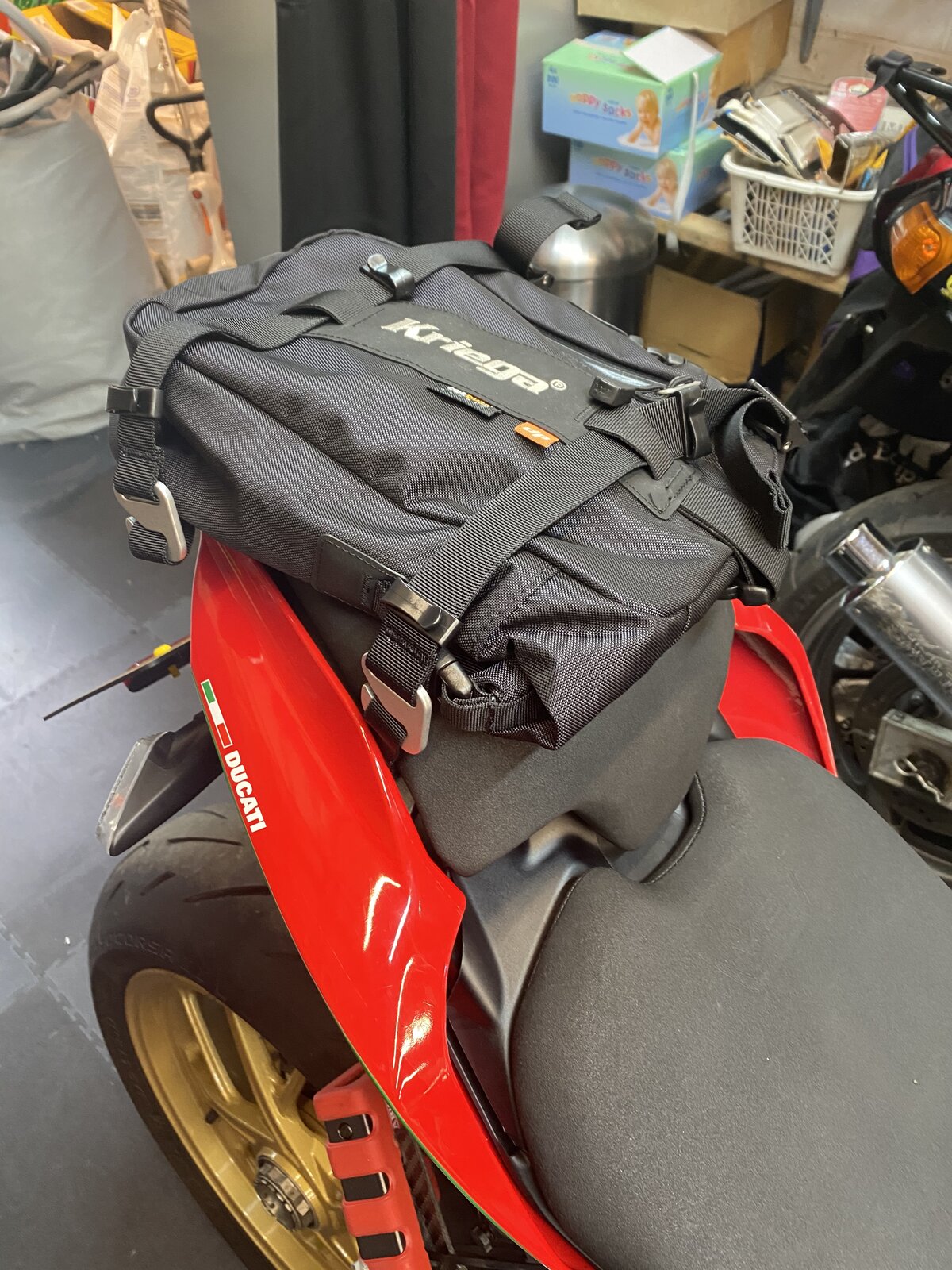

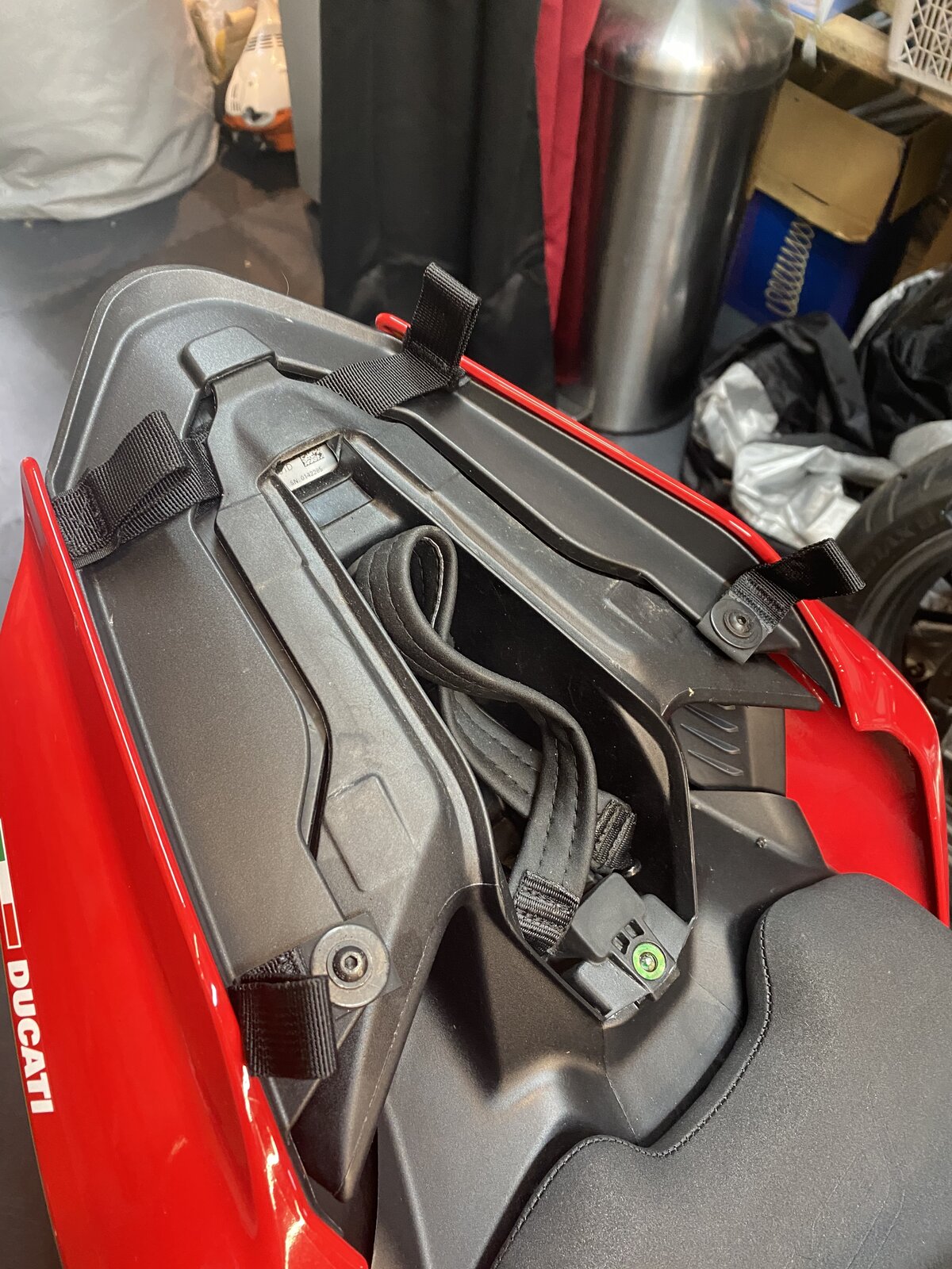

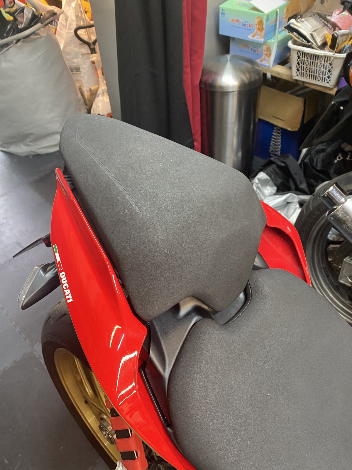

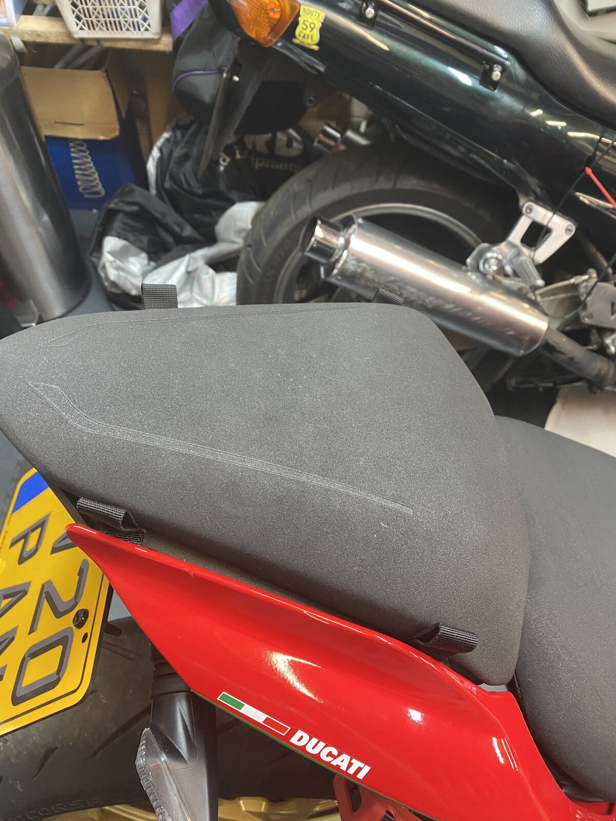

  6. here we have straps visible with seat removed, straps hidden under the seat, straps exposed from the side of the seat and then my US5 attached (the US30 is in the house, but the principle is the same)

  7. Thanks @manicguitarist I really struggled to get the strap at the back to fit straight/square it just seemed too thick to fit underneath. When I did fit it I found it hard to get the seat to slide on. I'll have to have another go.
  8. Did you disassemble the rear end? I did...made it much easier to fit.
  9. Yes I did, took me a while to realise that I had to do that as the instructions which came with it were poor.
