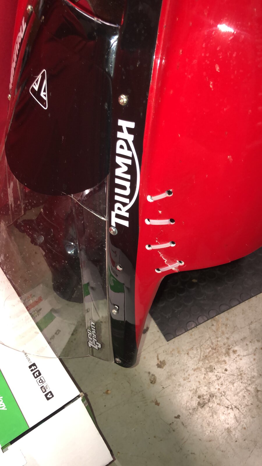

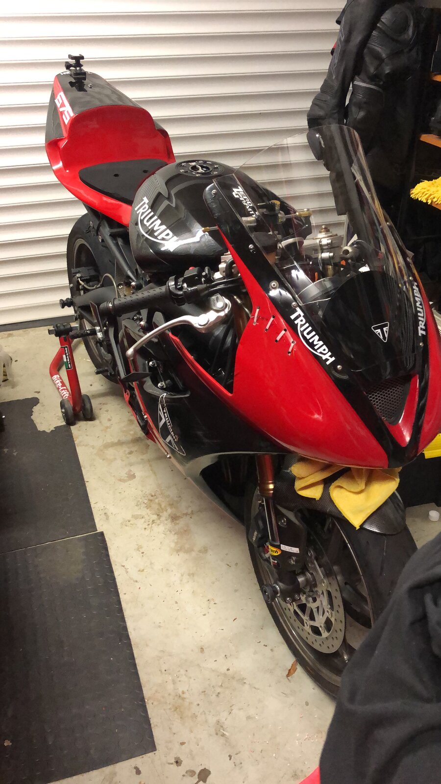

  1. My track kit is looking pretty tatty now, it was done by Mike at Rage a few years ago and I could just take it there and have him work his magic again, but I'm unsure what I might do with the bike in the next year or two so I'm on the fence with spending that kind of money to get a proper job.
    So I'm contemplating stripping, sanding, filling, priming then paint, lacquer myself I know it won't be as good, and I may just do it red then get graphics or get it wrapped.
    Has anyone got any advice on the steps, what grade sandpaper, wet and drip, primer, paint, lacquer to use.
    Or could I just get it wrapped as is? I think you would see the raised surfaces through the wrap though from the underlying original design.
    Thoughts?
