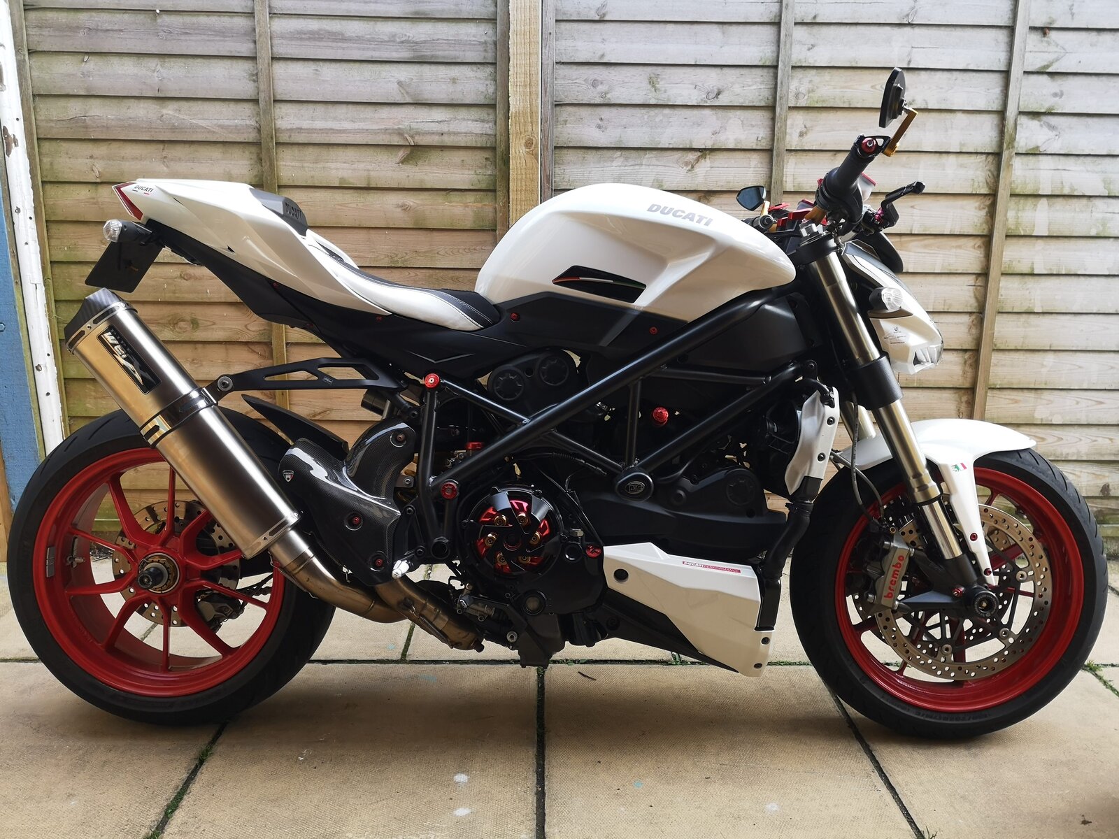

  8. Great stuff, glad you got it sorted.
    Any pics :)
  9. Here you go
  10. Its the biggest they do at 450mm and I think on first inspection it looks bloody massive....but having ridden it properly today...it's phenomenal....it barks at you and popps.... and thats with the DB killer in...havent taken it out yet...might try it..Kinda like how it sounds now....Loved the SC can...but, I do love how this changes the ride feel...So much more linear in the power...rather than snatch, it's rolls on better..
