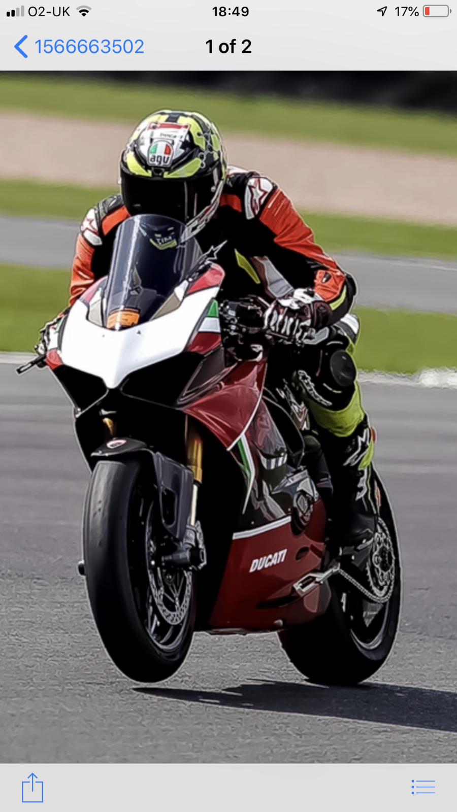

  11. Great!! Come and say hello. I might set up outside with a generator. I think garage space is an issue with this Covid shite. We’ll see when I get there.
    Here’s my bike for id purposes :):upyeah: Exciting Melbourne
