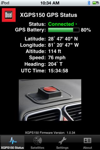

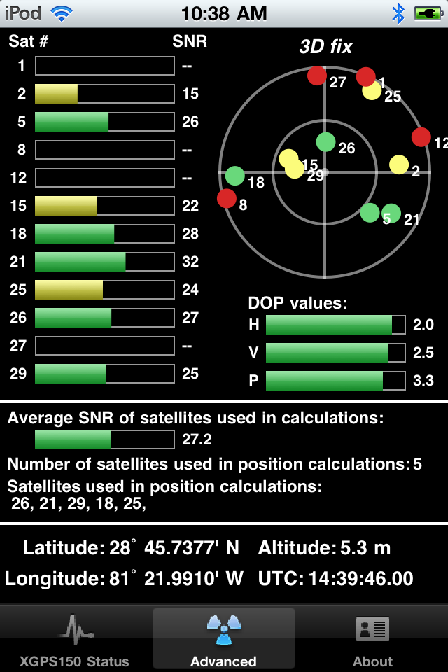

  12. One nice feature of the DUAL GPS is it has its own app which tells you things like battery life, satellites found, satellites locked etc
  13. It is a really nice bit of kit, but not cheap (from memory). I think mine was about £120. A few used ones on eBay though... Dual XGPS 150A | eBay

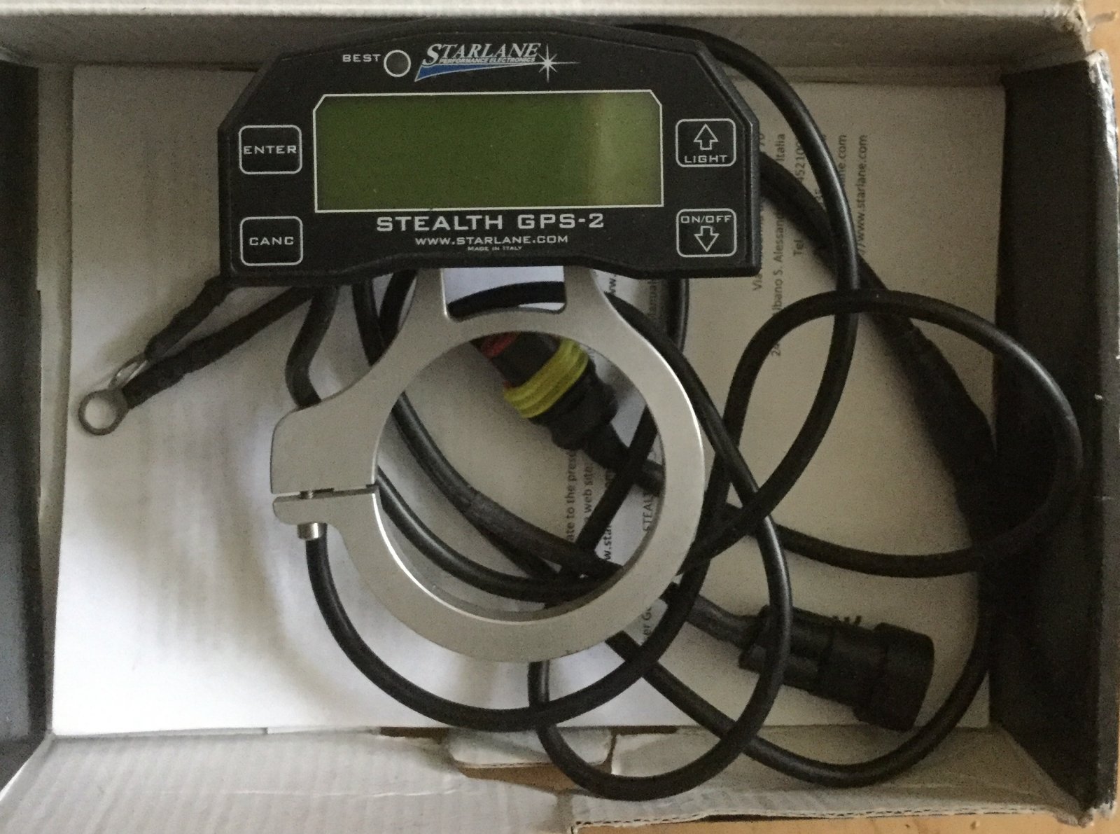

  14. Does this do what you are talking about ? Andy
  15. No. I'll take it off your hands for £20 ;)
