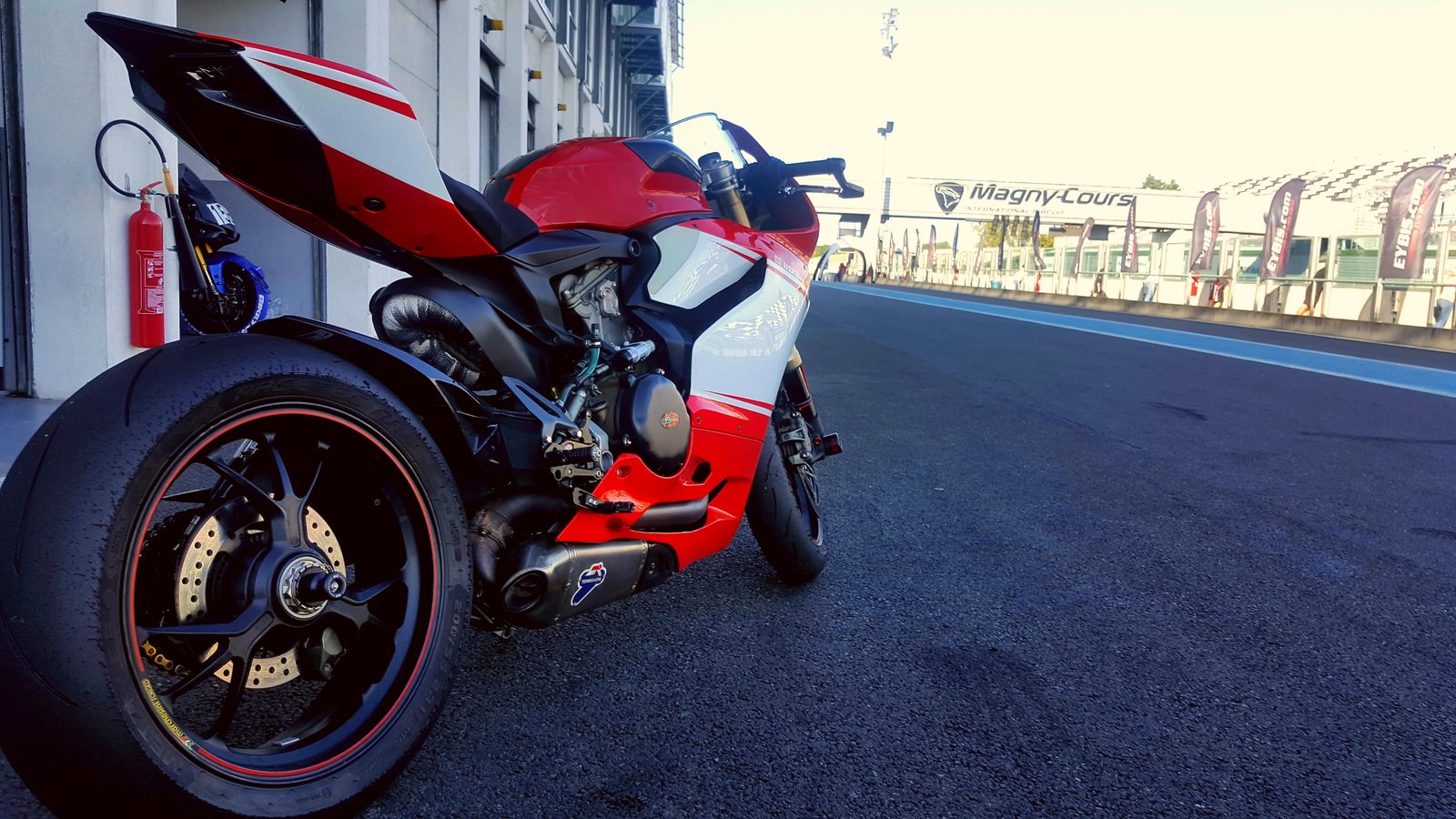

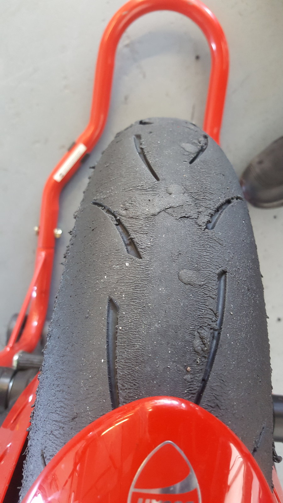

  19. Half way through the double trackday update:
    I'm running 30/26 hot per the Metzeler recommendations (on that chart that Steve linked). All looking good and none of the weird tearing I was getting at Mettet (although some slight tram lines on the front which my friend is also getting on his rsv; what's that?). Track is bone dry and hot which is obviously nice.
    God, this is a fantastic, fast circuit... 20180819_102501.jpg 20180819_102511.jpg 20180818_232908.jpg
