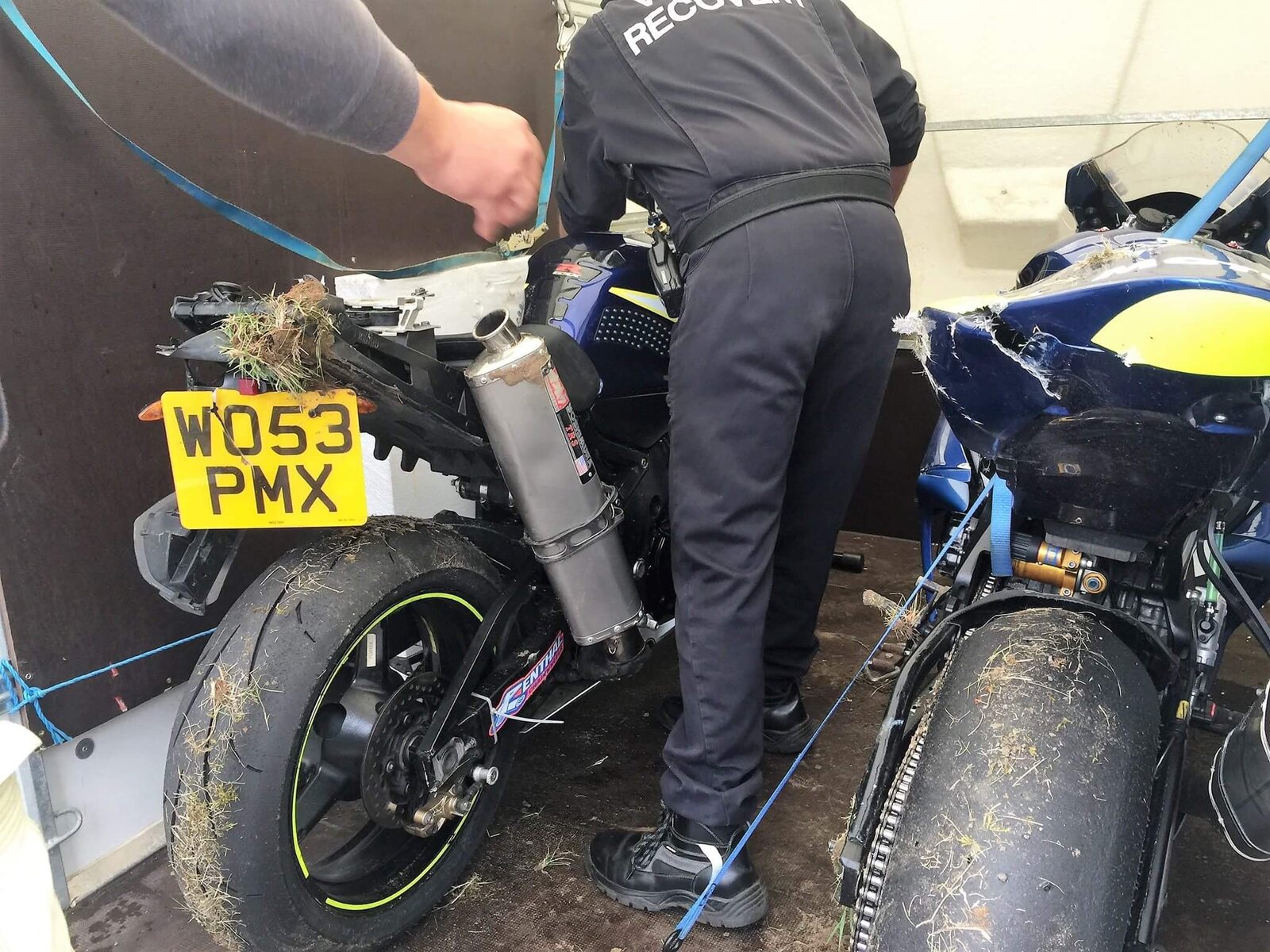

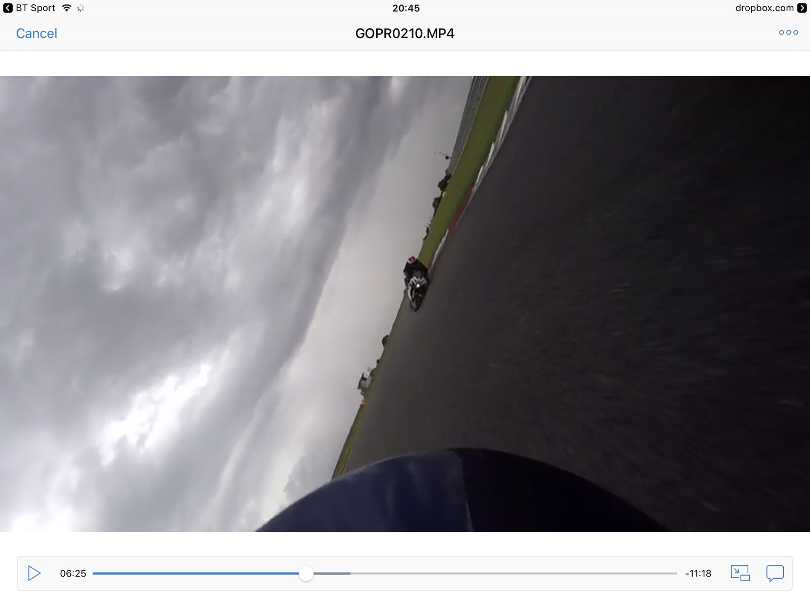

  17. This is what happens without abs and an emergency pull on the brake at 60 to not run a rider over who’s just fallen off
    C02FAEE9-C789-48C3-A2CB-3F728ABF6167.jpeg 281C8774-AA4C-44E7-84EF-6A44FE4656E4.jpeg 9360C82F-5CB2-40AA-8E0F-53D15B0449BE.jpeg
  18. Ah, you laid the bike down too early. You could have easily saved that :yum
