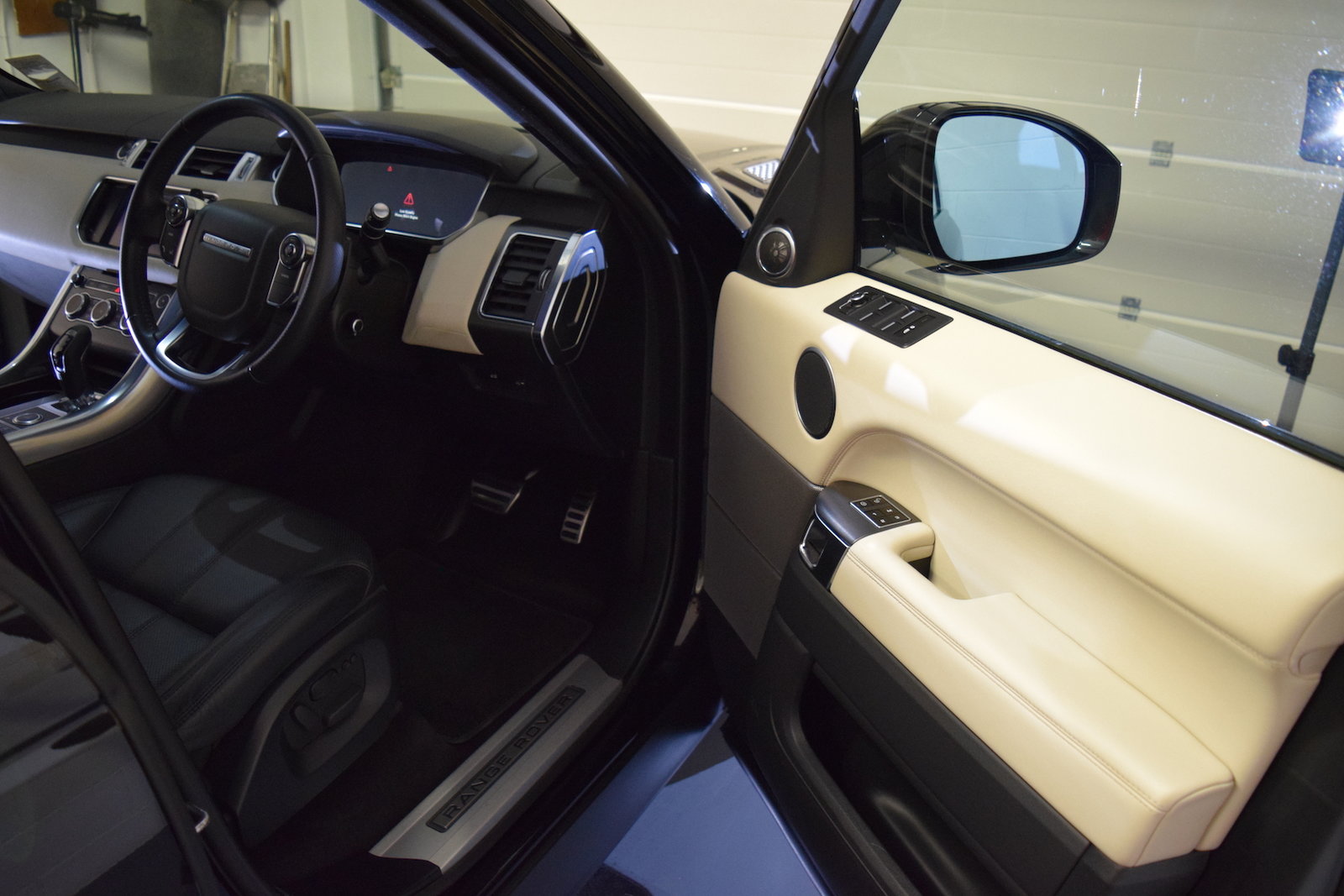

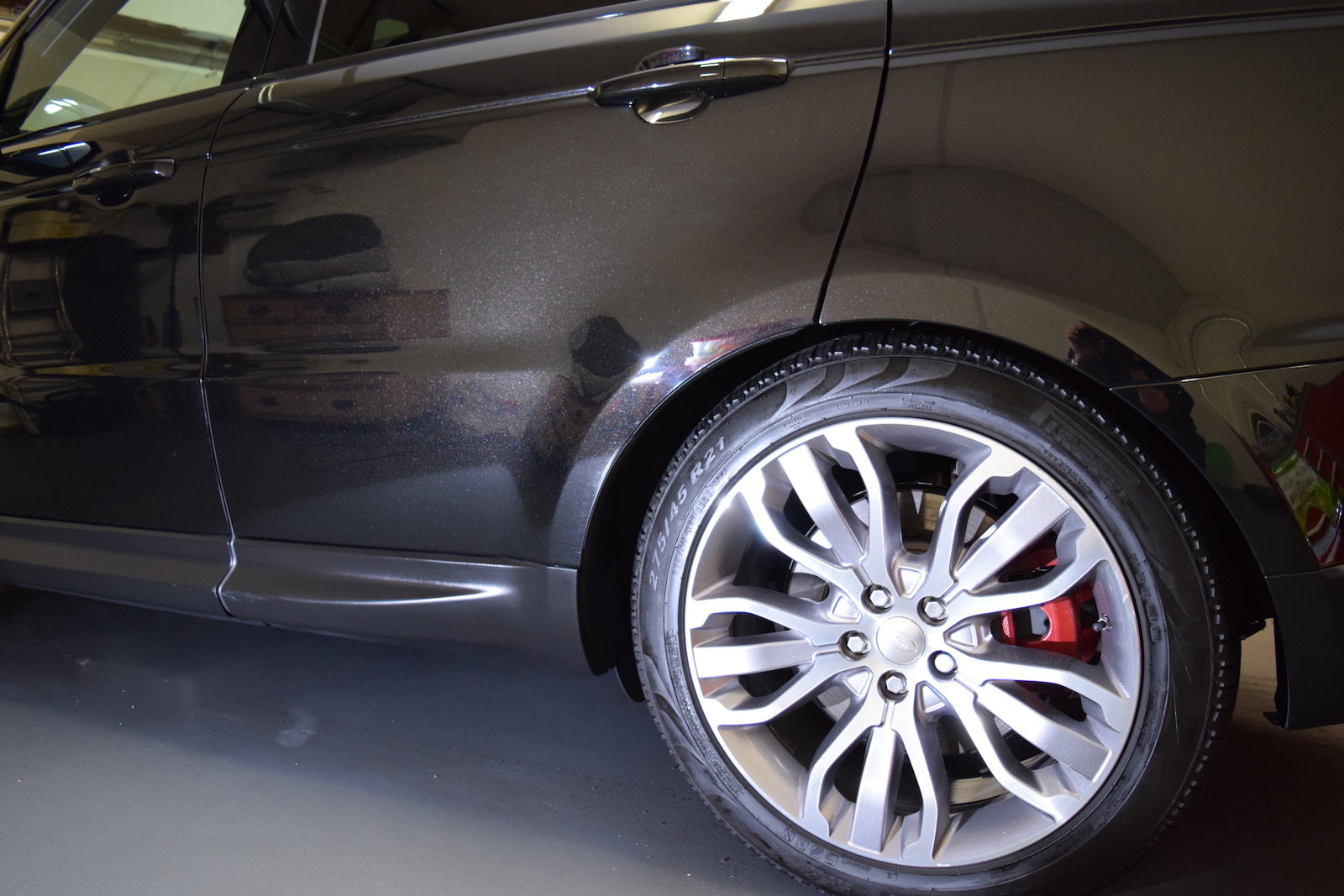

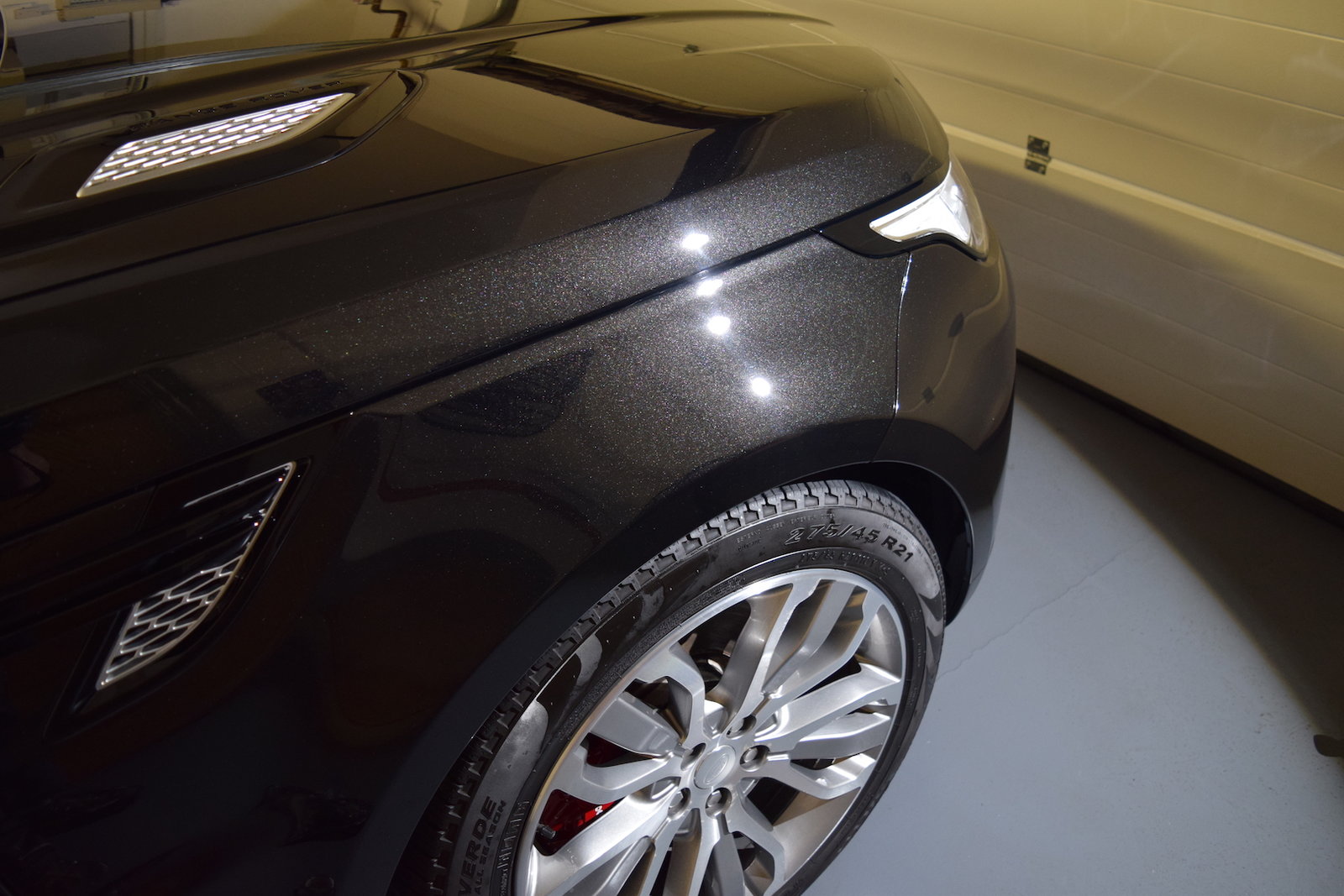

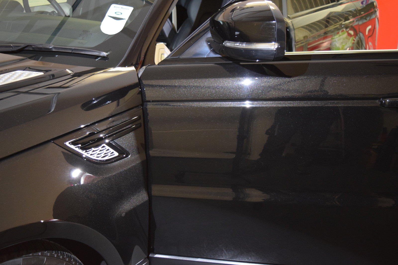

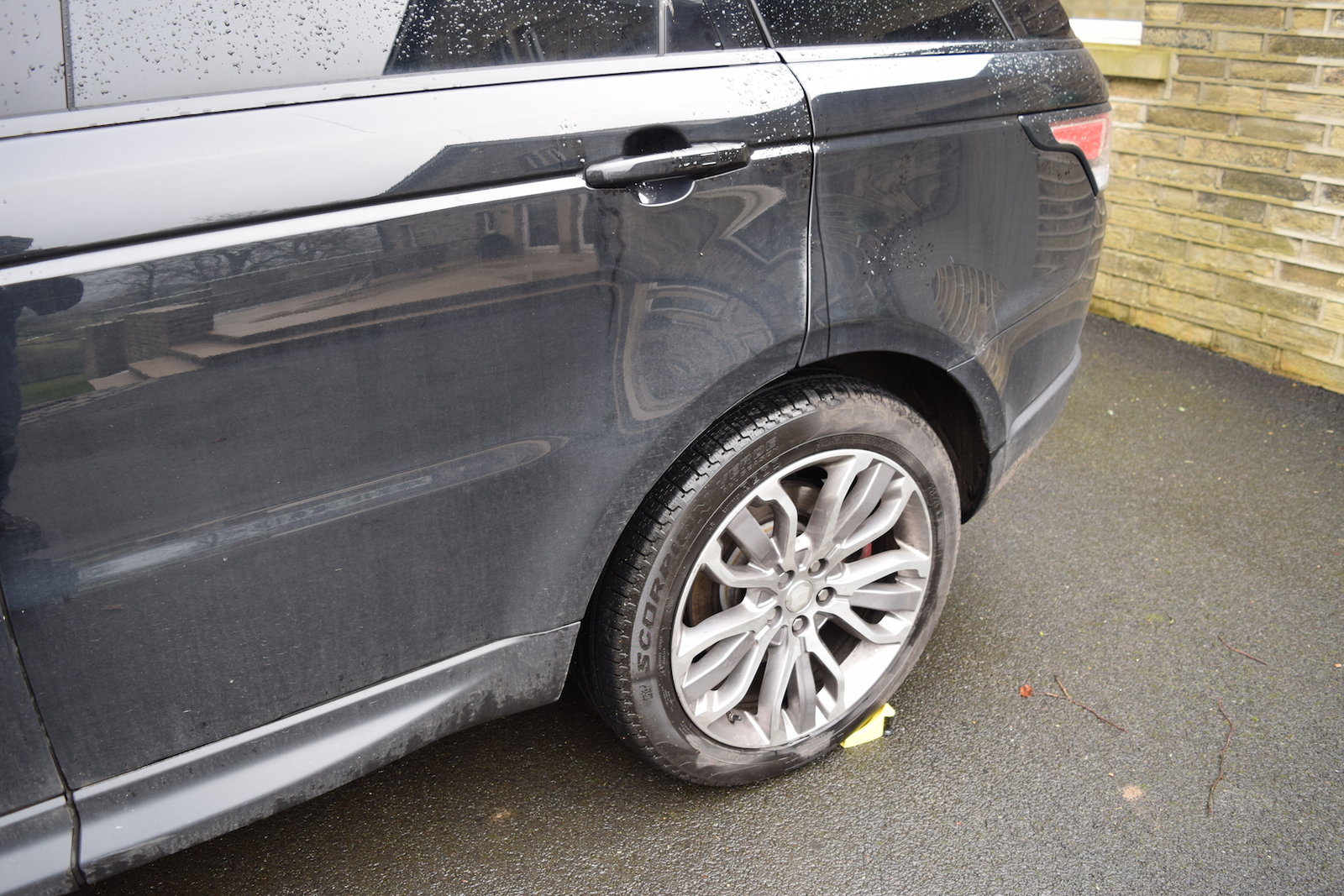

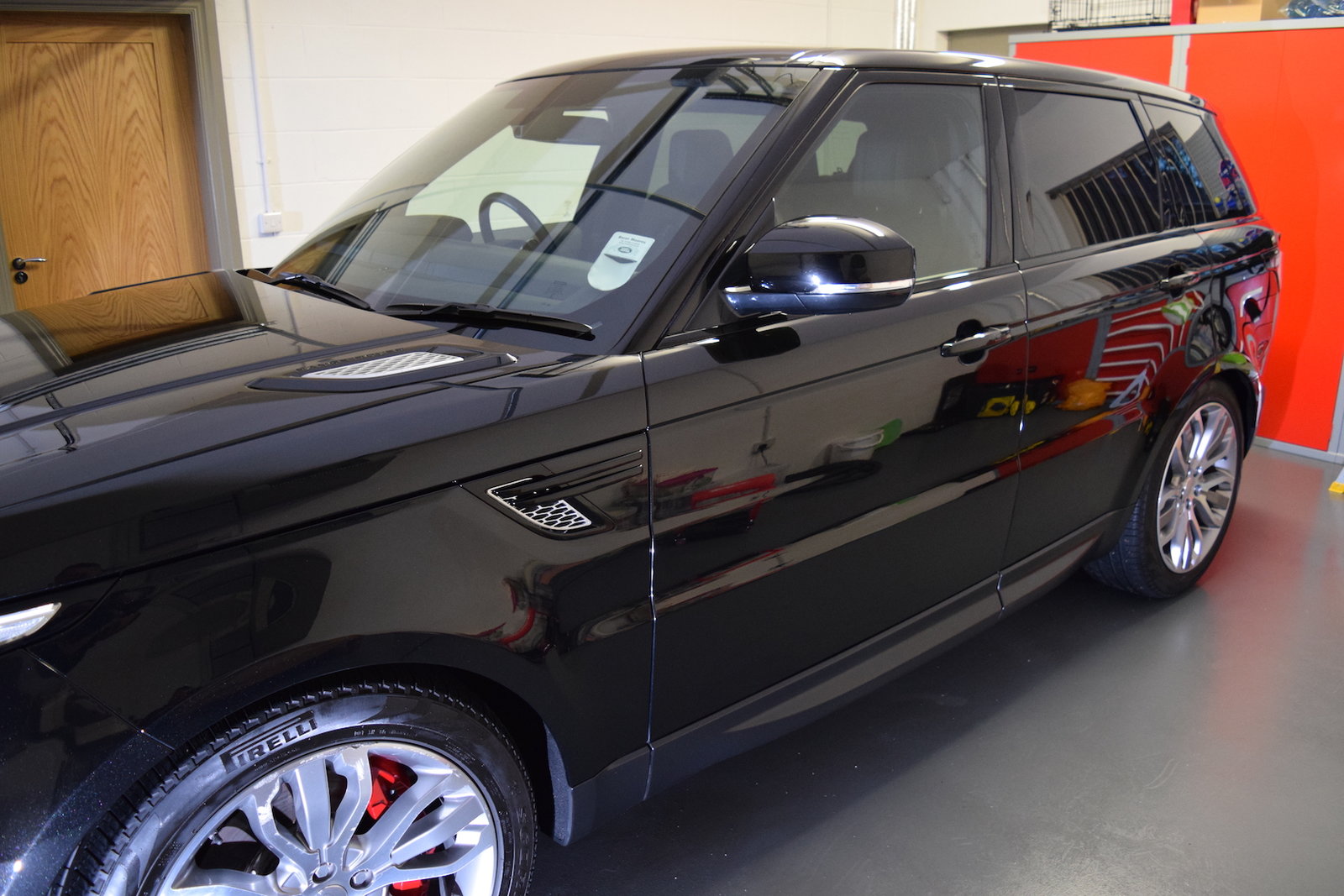

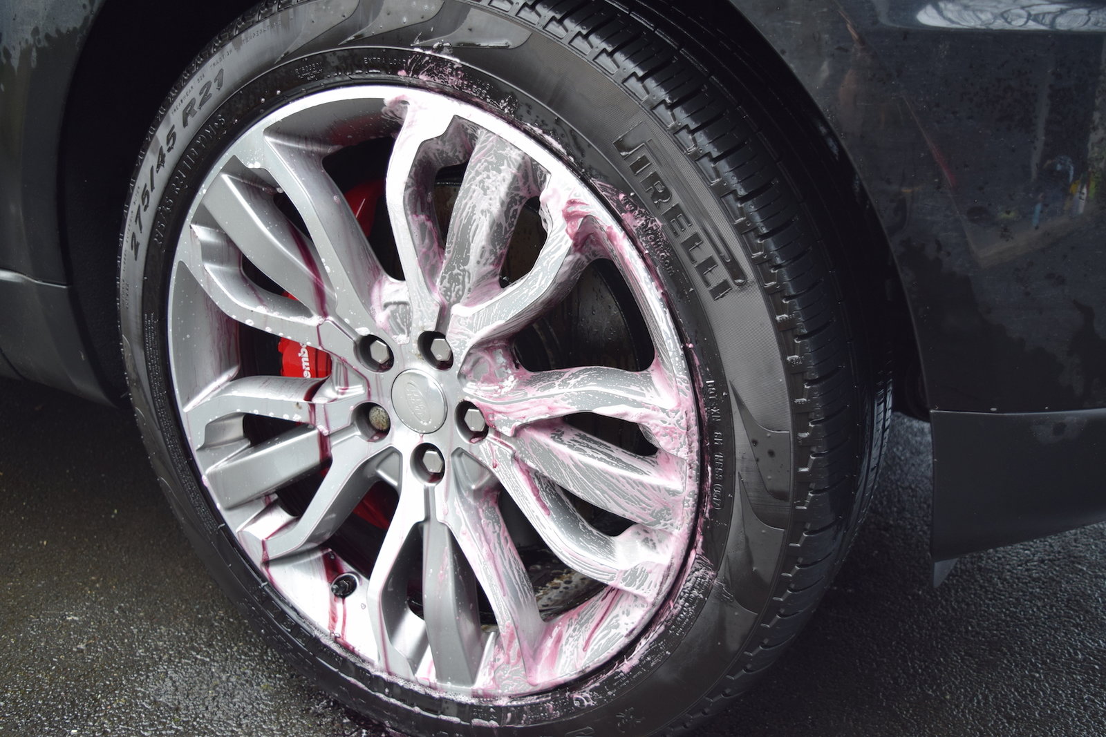

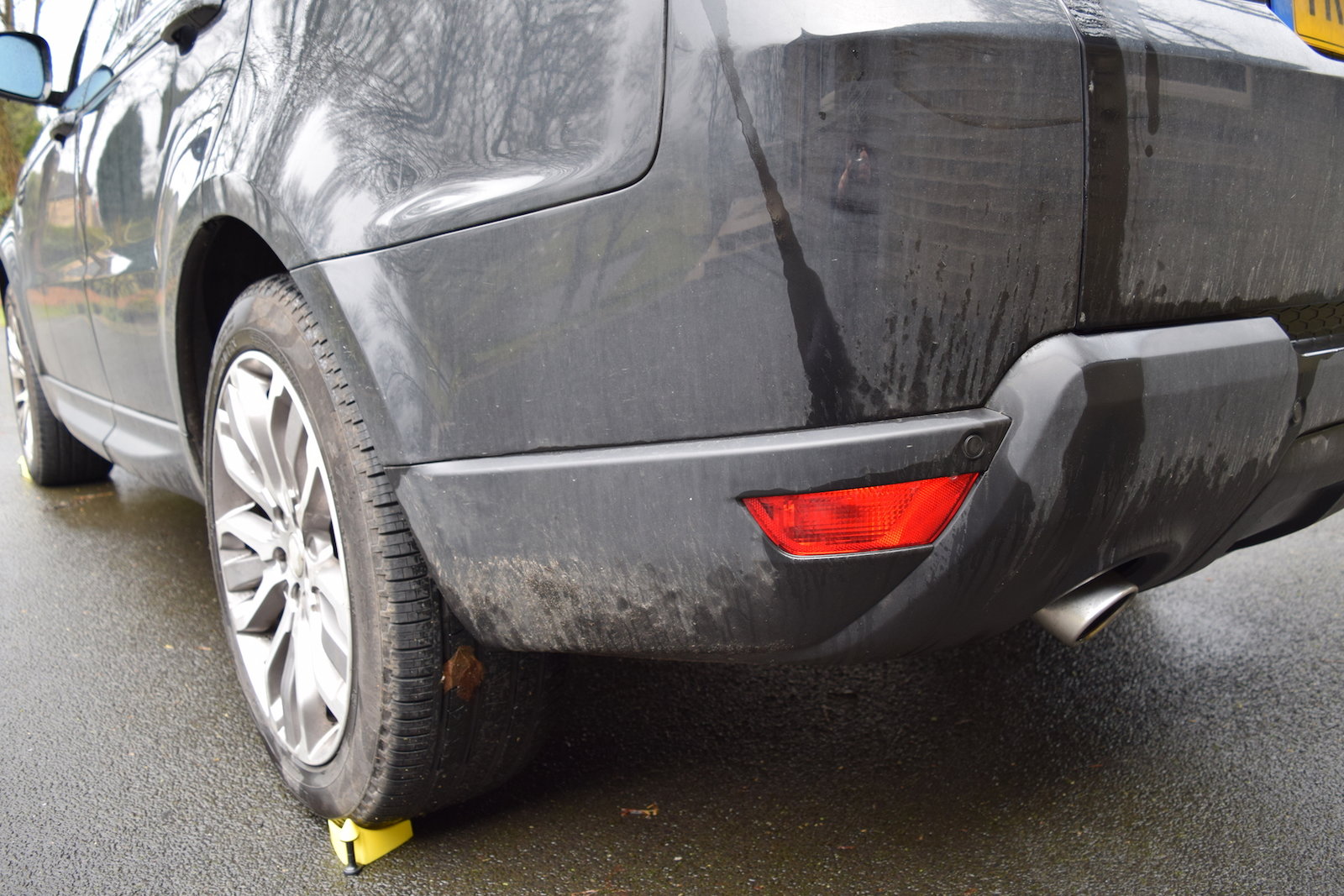

  1. Range Rover Sport HSE - Vehicle was absolutely riddled with deep wash marring ( Hand Car Wash ) and random deep scratches ....( Metallic fleck in paint was totally obscured due to amount of surface defects - after machine correction the metallic fleck is once again visable and ' pops '. ). Full clinical safe wash ( 4 buckets with double gritguards in each ) Citrus pre-wash followed by Bilt Hamber Auto foam to remove as much dirt as possible prior to contact wash. Gyeon Bathe Essence vehicle shampoo. All intricate / tight areas cleaned with a Swissvax detailing brush. Dooka Osha wash pad for paintwork and Microfibre madness mitt for lower parts of vehicle / Arches cleansed - tyres degreased - Iron remover to wheels then wheels coated - Full chemical ( Tar & Iron ) decontamination & physical decontamination to remove any remaining bonded contaminants with Tac Systems clay-cloth. Vehicle air blown dry including all gaps. Spies Hecker 7010 wipedown prior to machine correction to give true representation of paintwork & to give me an idea as to how bad it really was. ( All Rupes Bigfoot machines and Rupes pads used & Fantastic Sonax Perfect Finish ), Various light source's via Scangrip. Finally Gyeon Ceramic coating allowed to cure overnight then an application of Gyeon Cure to protect underlying ceramic / promote curing and to give a super-slick finish. All exterior plastics cleansed and restored back to factory with Solution Finish. Tailpipes polished and protected. Interior FULLY detailed back to a factory as new finish.
