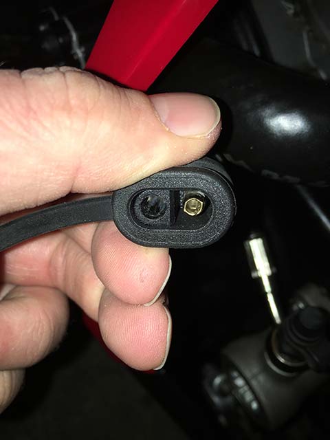

  3. Thanks, I think it's an original battery. This is the connector I mentioned down by the gear stuff.... with only two pins I'm guessing it's a power connector.
    If so, does anyone know a reasonably priced trickle charger that can be easily connected/disconnected to it? Or have I got my connectors all wrong?

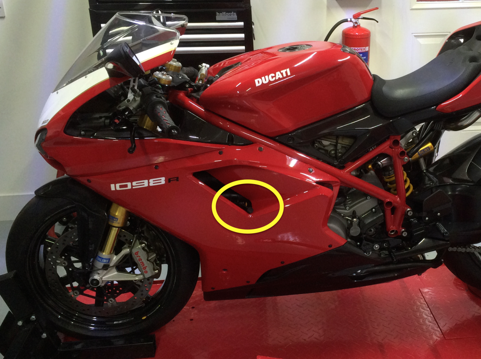

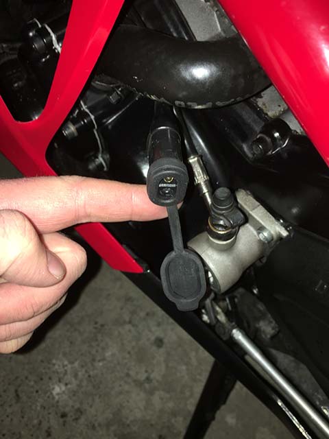

  9. I have a Ctek lithium charger for my 1098. As the battery is just behind the LH fairing vent, I have a permanent lead that's easily accessed to plug the charger into and is barely visible. No need to remove any fairing panels.

  10. Hi Chris, that's what I was thinking when I found it might be SAE, but was worried by your quickshifter suggestion. Knowing what a quickshifter does didn't want to send 12+V shooting up the throttle!
    Anyways, the pics above show my connector, which I believe is the "socket" version of SAE, like this: https://www.intobikes.co.uk/popups/imageviewer.php?id=4637
    I guess it's the two pin thing that makes me think it's power rather than quickshifter. So on the one hand I'd rather plug an optimate in and give it a whirl, rather than take panels off and trace wires... but on the other hand if you think it could be quickshifter, I'd rather that than frazzle something.

    That connector you showed has nothing to do with the quick shift it's a trickle charge plug (although not the stock one mine has, although I am in usa so not sure of your model has a slightly different plug).

  16. Looks like you already have a trickle charge plug connected. Just trace it back to the battery to make sure.
