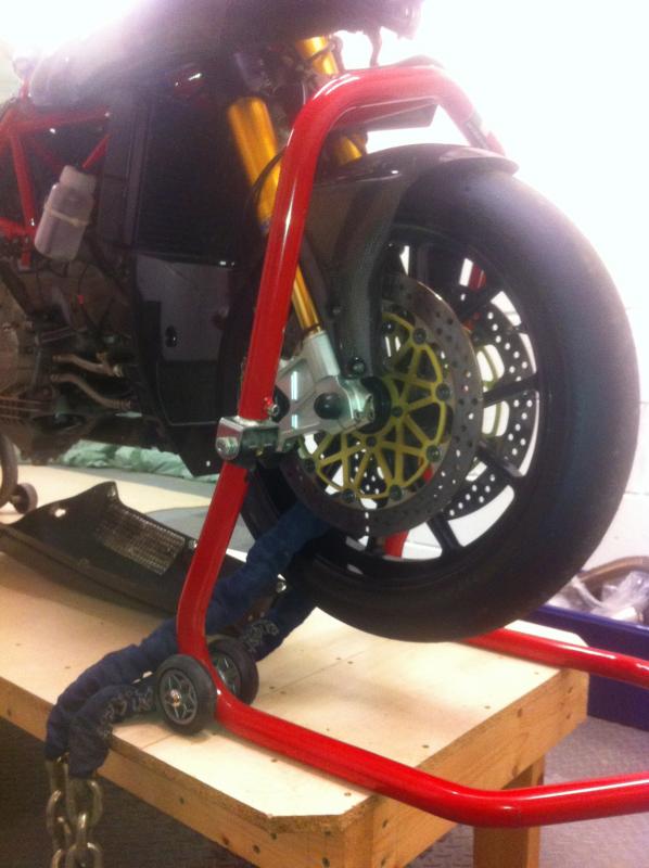

    my front end…….
  15. Look at my fffing album ! :biggrin:
  16. Nice. The standard 748R bottom yoke doesn't have a hole in it so I had to use the latest attachment for the Abba stand to lift the front end enough to dismantle it and I have to say it works pretty well. The plan for tomorow is to refit the front wheel and build the front end back up so I can turn the bike round and start on the back end. And yes I will post some pictures in my album which is supposed to be a record of the transformation. Andy
    #16 Android853sp, Dec 27, 2013
