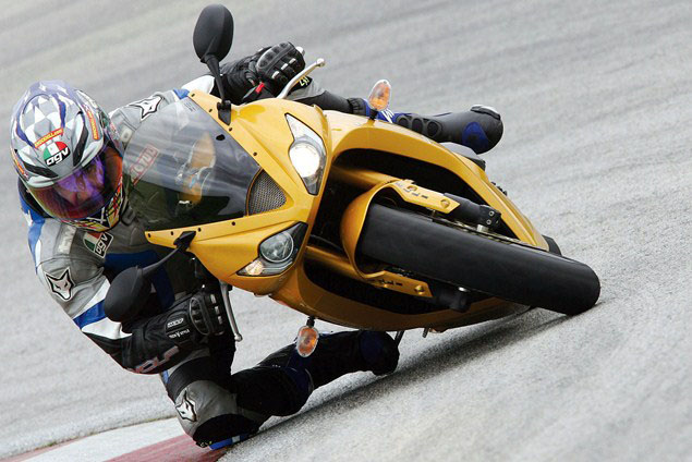

    3) Triumph Daytona 675
    0
    Submitted by Visordown on Thu, 04/05/2017 - 15:02
    An instant, guaranteed-with-knobs-on, classic. Not the new ones or the Rs – keep an original, gold, 675 under a blanket and it’ll reward you when you retire (providing you’re not already in your late 50s). Triumph’s slow turnover of new models means it’ll take a while before everyone’s forgotten how good looking the first Daytona was. But it was. Skeletal, minimal, slightly shonky but shot through with an unmistakable genius that perfectly captures the moment a manufacturer hit its stride. And it also signifies the moment in the mid Noughties when we realised the Japanese had lost the plot.
