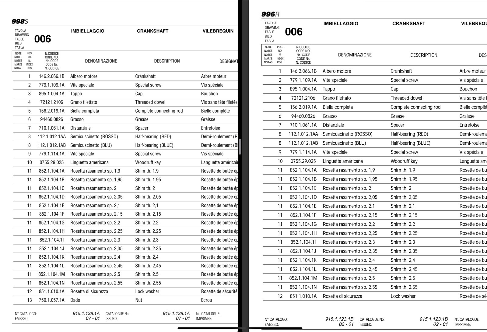

  11. We covered this pretty comprehensively in the Ebay thread not long ago - same part number for the Titanium conrods on loads of bikes including the 998S
    Bikes that share the same titanium conrods
    (Edited to remove 1098)
    1998-02 Ducati 748 R
    1998-99 Ducati 748 SPS
    2004-06 Ducati 749 R
    1997-98 Ducati 916 SPS
    1999 Ducati 996 R
    2001 Ducati 996 R
    2001 Ducati 996 S
    1999-00 Ducati 996 SPS
    2002 Ducati 998 R
    2002 Ducati 998 S Bayliss
    2002 Ducati 998 S Bostrom
    2004 Ducati 998 S FE
    2003-06 Ducati 999 R
    2006 Ducati 999 R Xerox
    2003-06 Ducati 999 S
    2007 Ducati 999 S AMA Replica
    #15 LiveFast......, May 9, 2020

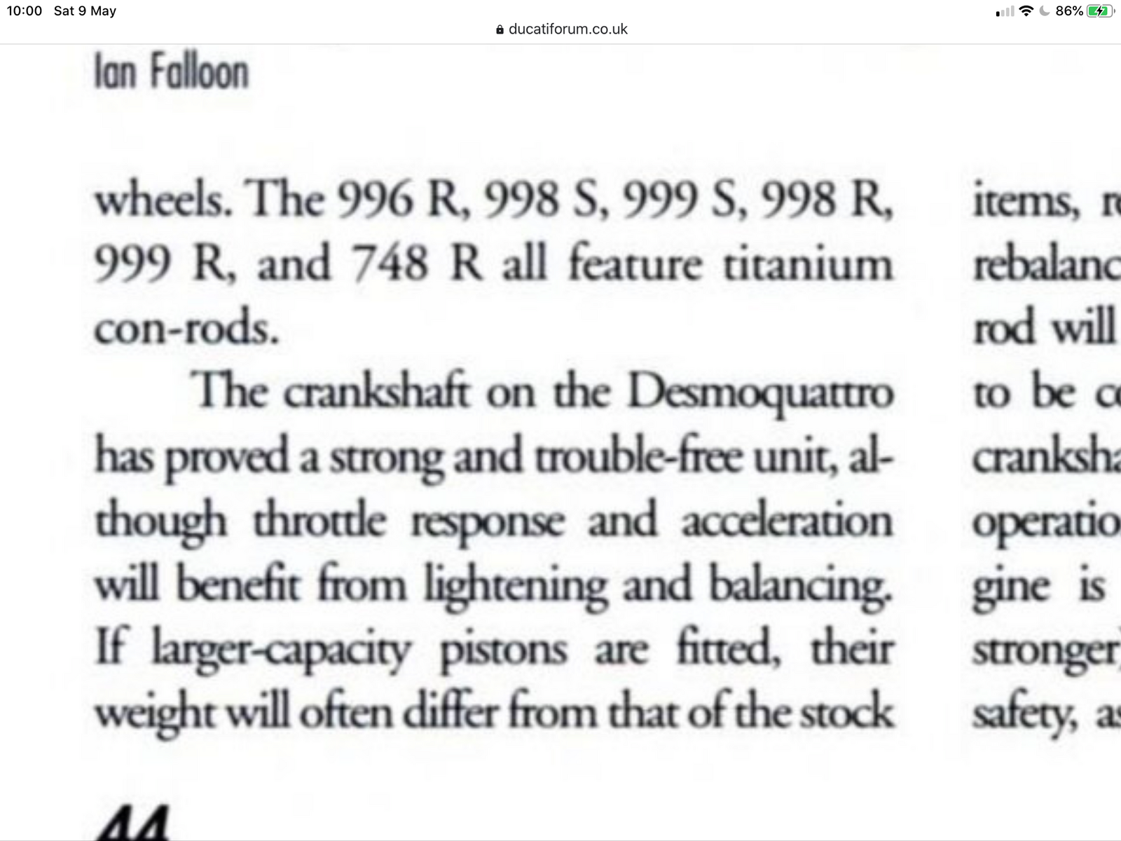

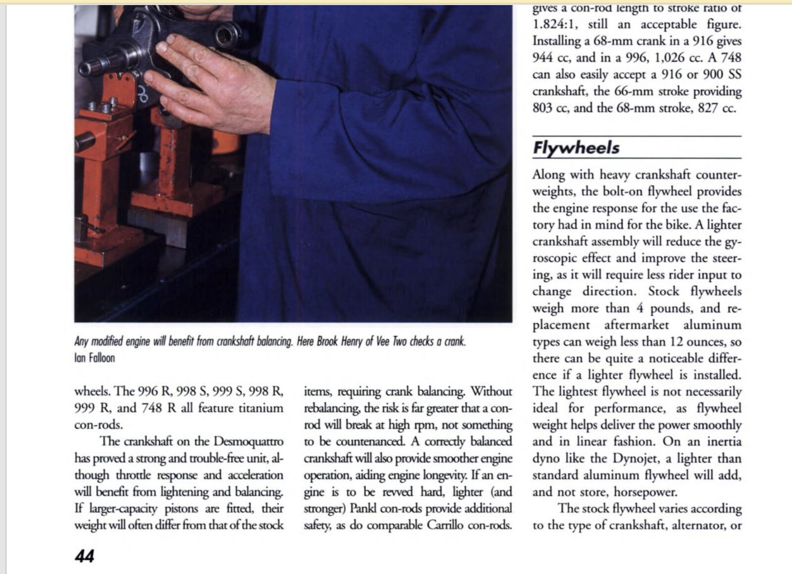

  14. Yep all the Ltd edition stuff ti rods in theory ... but 998s nope ..steel rods!
    And the 03-06 999s had steel rods too!
    • Disagree Disagree x 2
  15. But the 998S has the complete 996R engine and on the parts lists put up by @LiveFast...... above the con rods for the two are the same part number.
