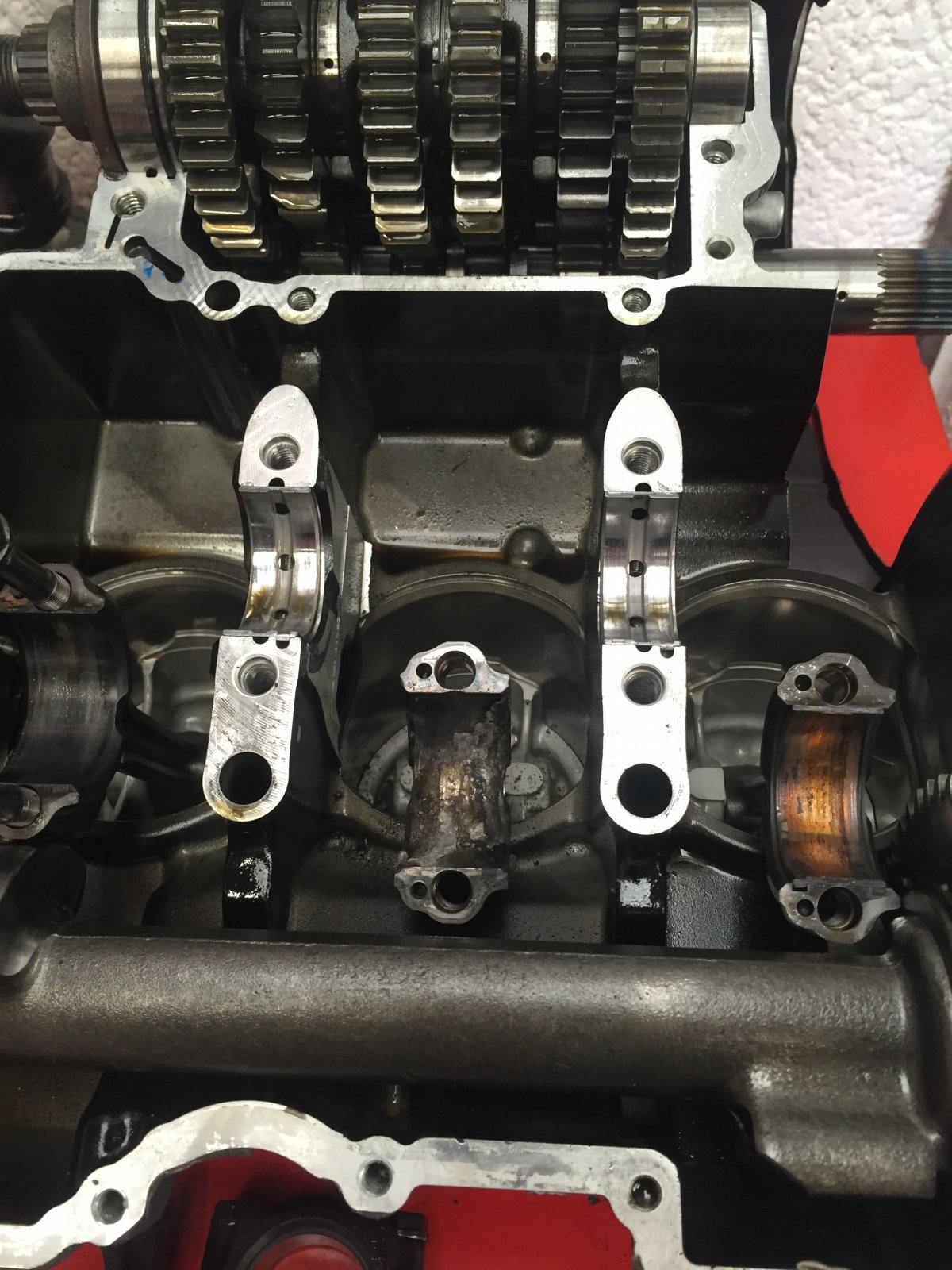

  1. Oil starvation. So new crank, big ends, valves are fine but the heat has dished the top of 3 so need to replace, one cam too.....
    Wouldn't mind but I didn't even crash it!!!!!!
    Check the middle one, looks like it's been welded!!
    And the dished valves. Tims mate from triumph done loads of these and never seen them dished like that before. Must have been heat???

    What caused the oil starvation? Obviously, that will need to be sorted before rebuild or it will do it again.

    Ricky, guessing at some time (like just before I bought it!!) it was crashed (ex race bike, so to be expected and accepted) but the fella put new fairings on and full paint, but didnt check motor. So run fine on stand and in garage but as soon as used in anger boom.
    I have, since buying, found out trumpets are very fragile (why did I now know this before?!) and if the oil is ever so slightly low it can go bang. And checking oil is bia dipstick...so they make it as hard as they can :smirk:

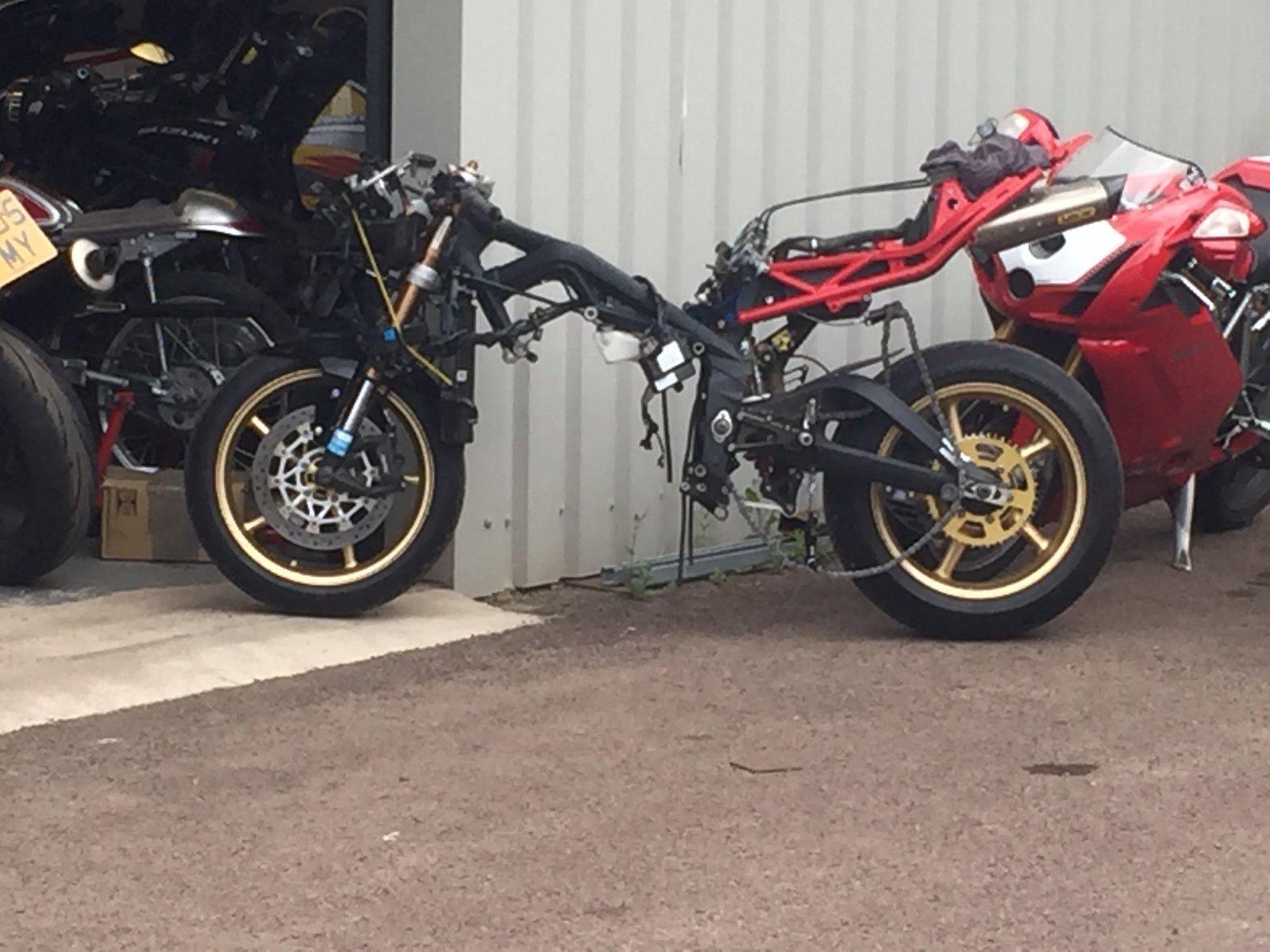

  6. Yep full rebuild, so parts being priced up and sourced, then probably sell on. I want a turn key travk bike, not something this fragile

  9. So, as it stands today my engine is still in bits. However, its now going back together and found the conrods were potentially damaged beyond being able to be machined into tolerance. So thats a whole new bottom end plus camshaft and couple of valves and buckets. Even at a 'good rate' its going to be a big bill....

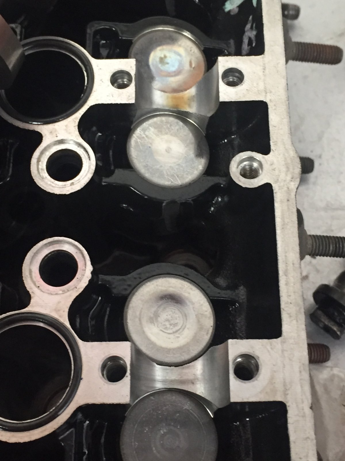

  11. I never quite understood what you meant by the valves being dished. How can that be? How was the shape of the valves different from standard? Did you mean that the bucket tappets or cam followers were dished, which might make some sense?
  12. @Pete1950 see the pic above, the top of the valves were dished but also the buckets were toast. Mechanic said he can't remember seeing them that bad before.
    But going by the state of the rest, it was pretty catastrophic
