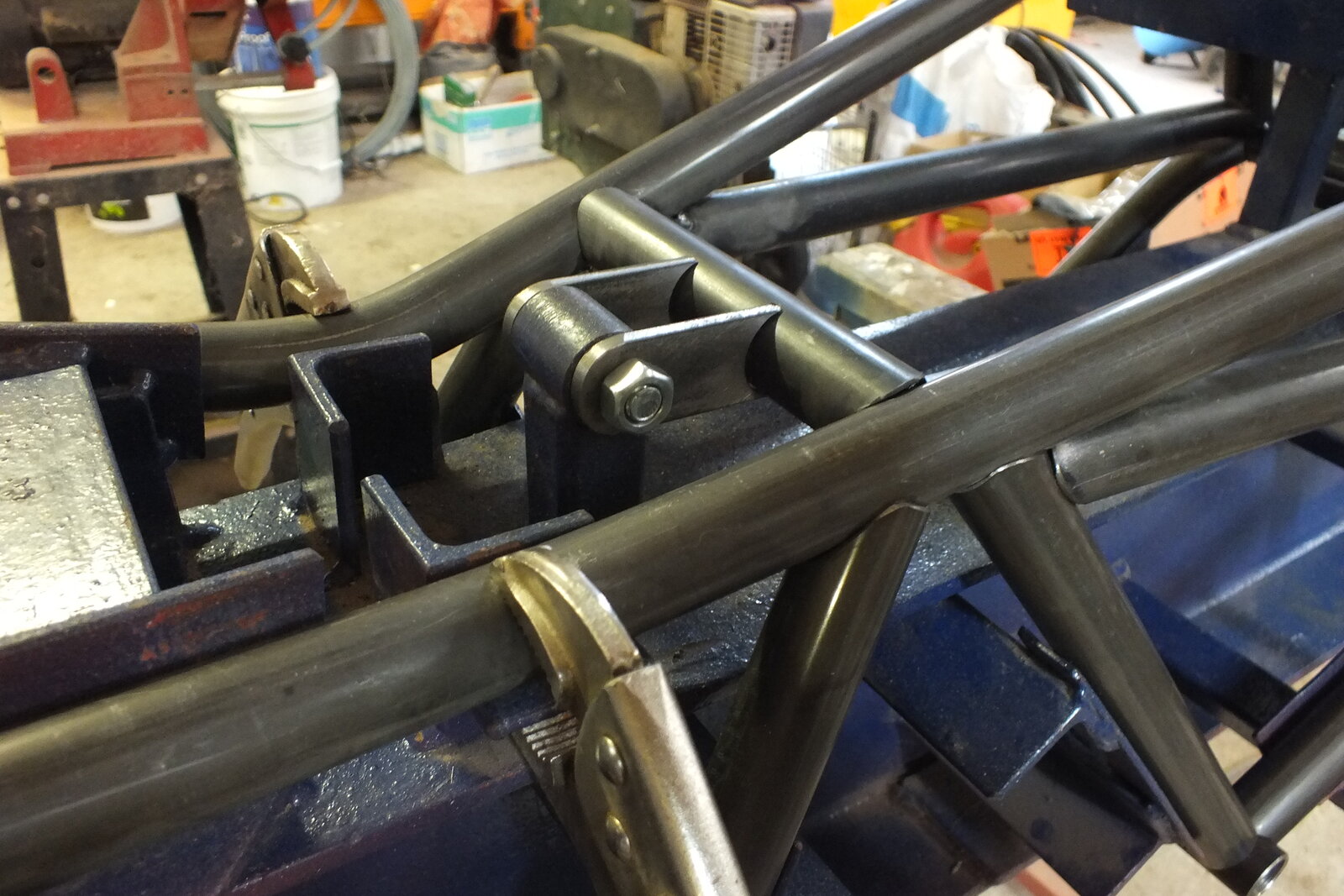

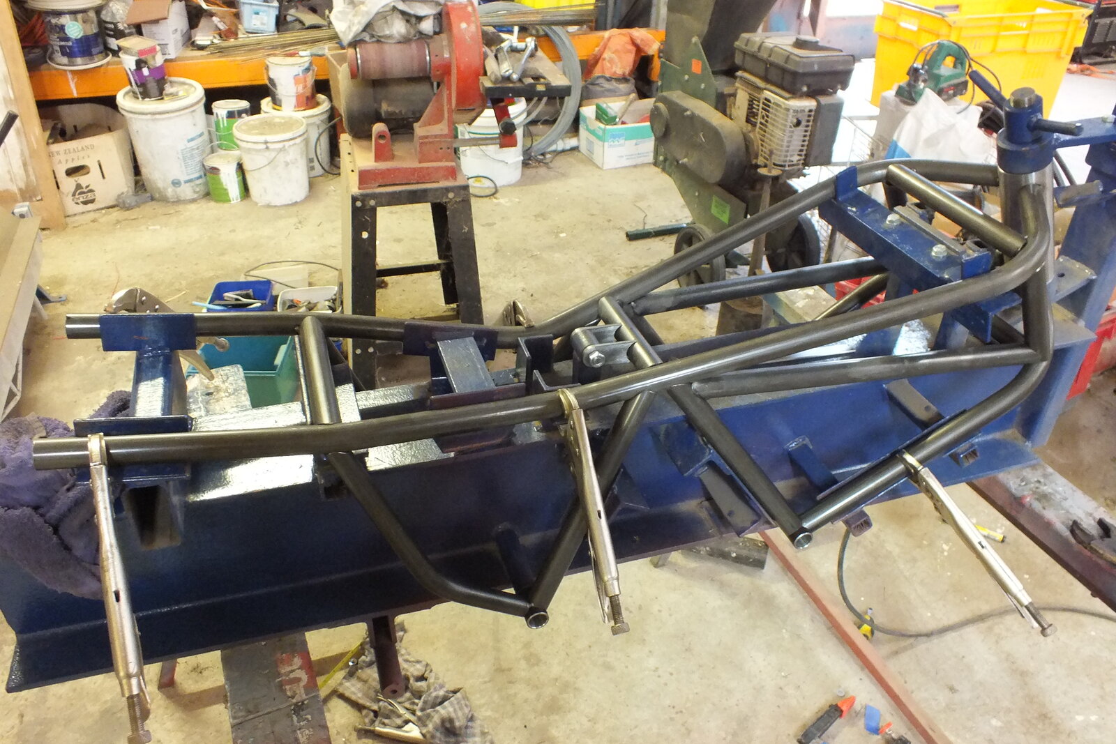

  1. Hey Everyone, brand new to this site. I have been mucking around with TTF2 frames for nearly 30 years now with 28 built to date. Most of them have been special orders and no two have been the same. I have come to the stage where people are wanting genuine replicas that are faithful to the original design but it appears there are many variations. I am trying to determine the correct tube sizes for the rear sub frame tubes, the ones that go from the seat cross member down to the rear engine mount and the tube sizes for the footpeg hangers that form the triangle footpeg mount. Any help much appreciated if anyone has a genuine Verlicchi frame they could have a measure up of. Have attached a pic of whats in the jig now. Cheers
