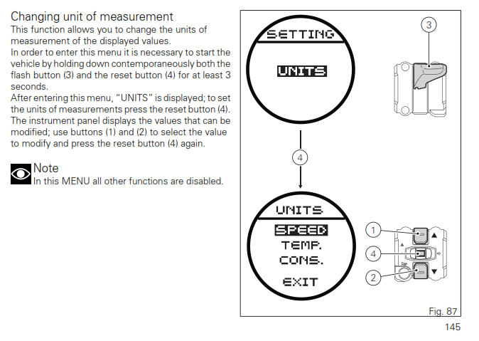

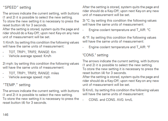

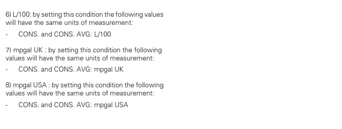

  3. ANy power interruption to the ECU will default the units to kilometres / kph, so you'll have to change the units back to miles / mph. The procedure for this on 2010-2014 models is: upload_2021-12-20_9-15-9.png
    It's worth noting that when you change the units it will zero trip 1 and trip 2.
