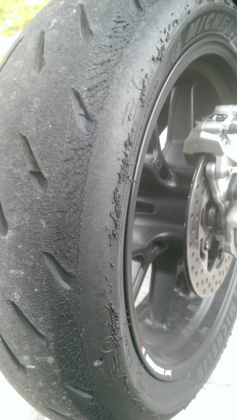

    Want to try to clean this tear up on the open road. Do I go lower pressure than normal and just go roundabout surfing? Or run my normal road pressures?
    Cheers.

  2. Normal pressures and ride it, see what happens. There are no magic beans for this ;)
  3. Looks like hot tear
    Hot shear, increase the pressure 2psi and ride it ......... um, enthusiastically :cool:. Andy
  4. Just ride it normally

  7. Looks like your pressures weren't right for sure
  8. Some fella said add more pressure as it was cold tear :thinkingface:: unamused:
  9. What pressures did you run? And what group?
  10. What pressures did you run? And what group?
  11. About 31 cold in inters.
    Just been out for 30mls on open sweeping roads, cleaned up a bit but this is going to take 500mls huh?
    Luckily next TD is at Bedford and that's a left hand track.
  12. I didn't ride, but in pilot powers like those was recommending 28 to start then when it started cutting up a psi lower...Cream started with 29, seemed to be quite hard on the gas, got some tearing then went up I think...hence the cold tear...
