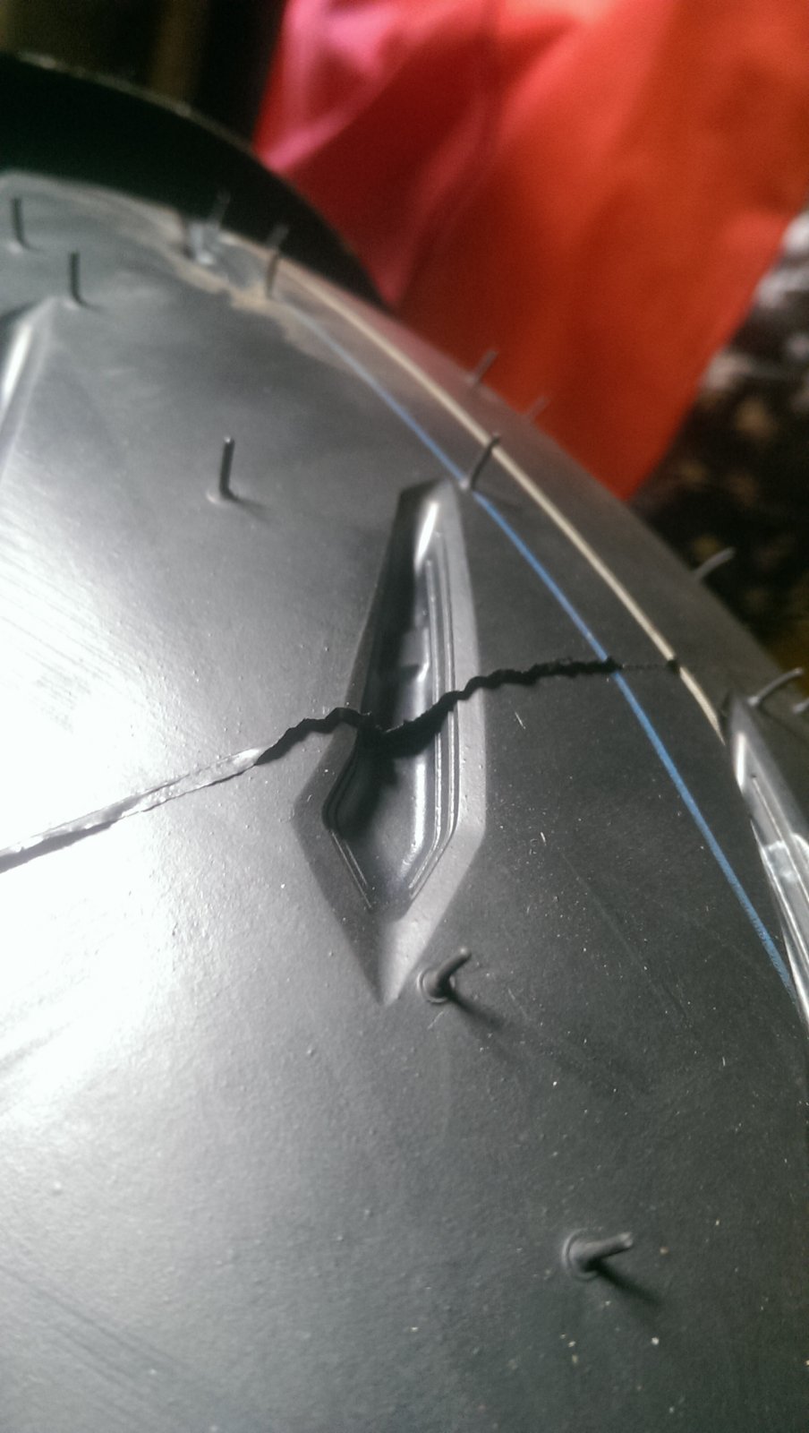

  6. Going to jump to a conclusion. These sticking up bits, what's the point? Maybe they indicate tyre growth at speed? So I need to make sure they don't touch anywhere when the wheel rotates?
    Anyway, going to put the old smaller rear sprocket on till I get a longer chain.
  7. Just mould marks aren't they? Cool idea if that's why tho :upyeah:

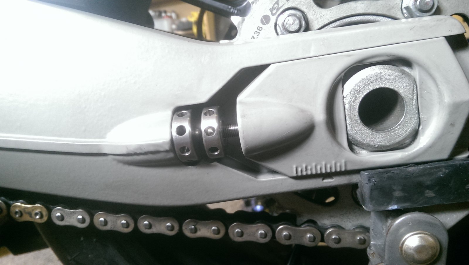

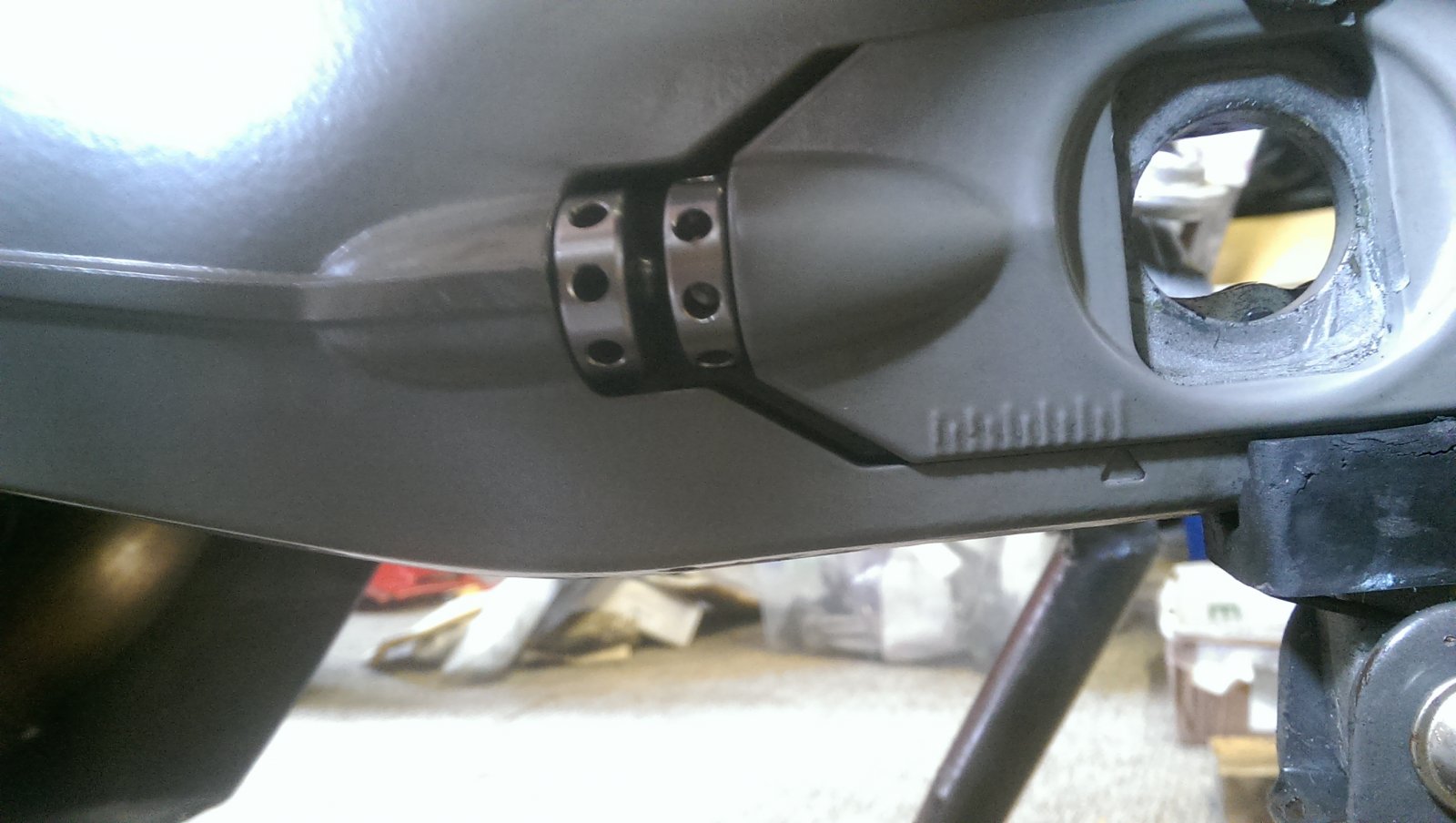

  8. IMAG1490.jpg IMAG1491.jpg Differences between a 36T and 38T rear sprocket.
  9. 38 probably work better anyway :upyeah:
  10. No. It was originally 36, I changed to 38 last year but it means front wheel really close to SA, further forward. So I've now had to go back to 36 for 180/55 to fit. What I need is +2 links in the chain so I can fit the 38 again, may go 39 if I'm buying new CnS.
  11. Or change the front sprocket. Cheaper and I may even have one laying around in spares somewhere that will fit off another Ducati . What front are you running @Cream_Revenge ?
  12. They are from the moulding process.

  14. The horizontal obviously are, but why the little spiky bits?
  15. Front is 15. Will go 14/37 if gearing commander works out......
  16. Yes, vents for the air to escape the mould, which fill up with rubber. They will usually be all different lengths.
