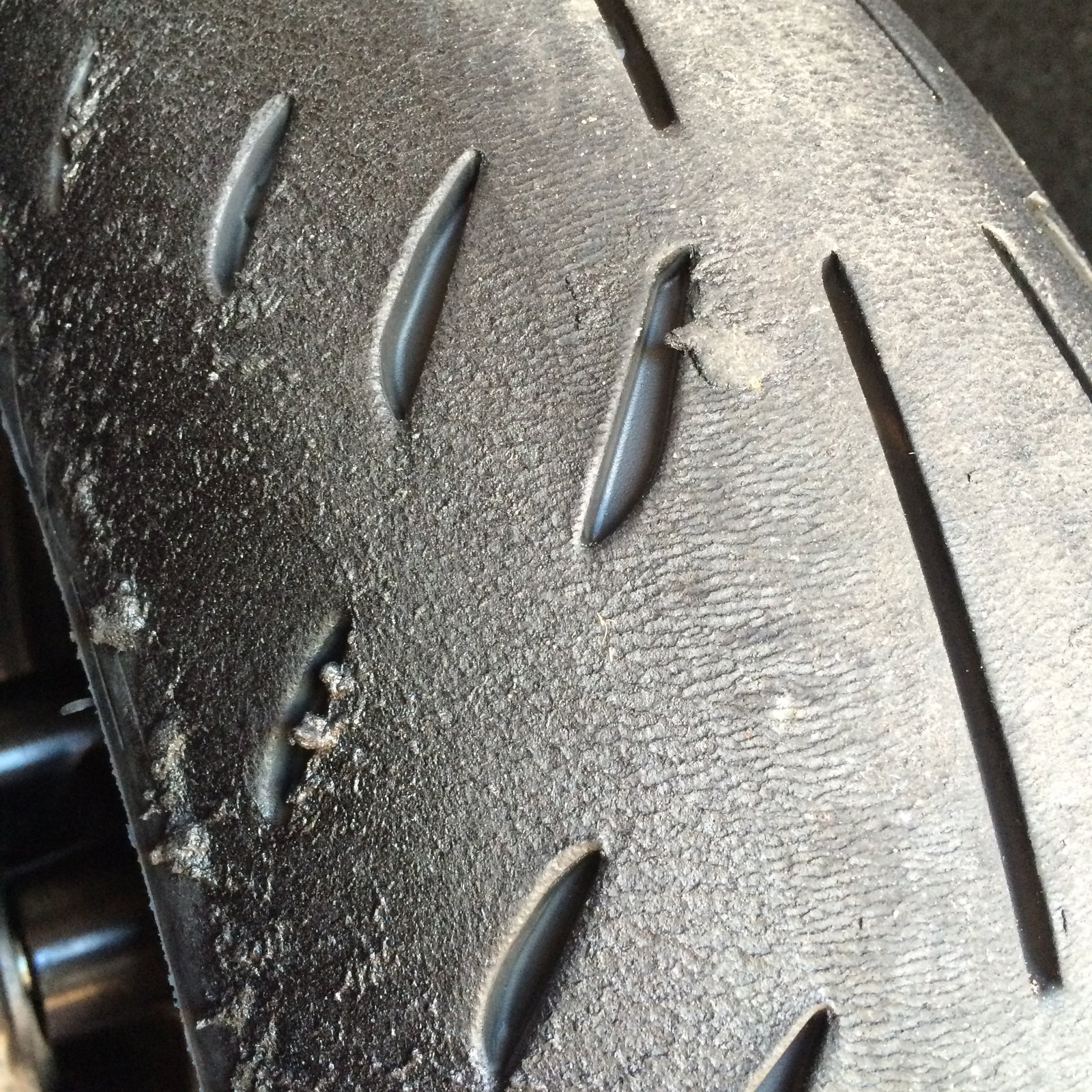

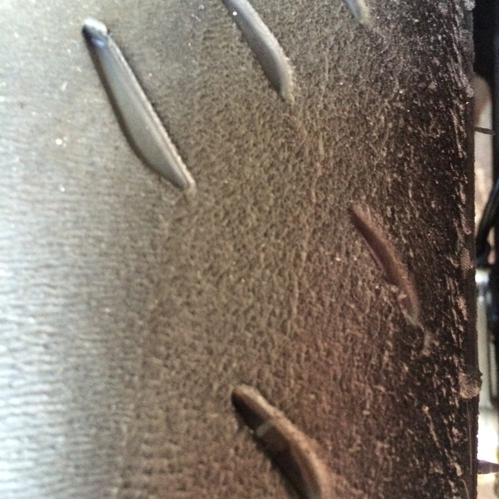

  18. Just unloading van so a couple of pics
  19. Looks fine in those pics (can’t tell if first pic is cold tearing). Suspect just overloaded heat wise and going a bit quicker meant tyre took too much pressure increase
