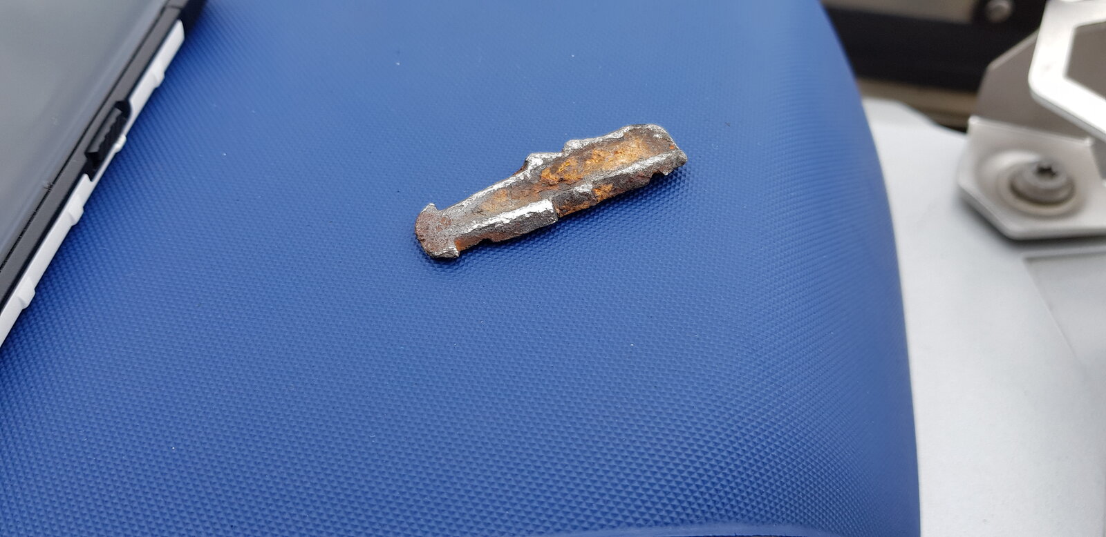

  2. Last year my mate on a GS adventure heavy guy too got a part of a rawlbolt in his tyre making a slot see pic of bit pulled out. The AA guy had a kit I have never seen. It was like a small gun.The plugs were square with centre cut out. He attached them to the front of the pistol & stretched the plug back to a clip which hooked it on. Then pushed it into the tyre & pulled the trigger letting the protruding half go. With adhesive on it. He actually got 4 in side by side. It got him from Holme on spalding moor back to Scholes to tyre shop for new tyere 20180712_114214.jpg 20180712_121734.jpg . Amazing bit of kit. A good 35miles.
