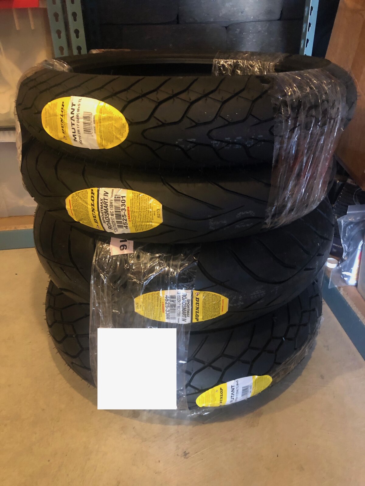

  12. i've been running Dunlop Roadsmart IIIs and now IVs on my previous and now current Multistrada ... averaging 7,000 miles out of the rears.
    love the Roadsmarts ... over the years, have put a little over 80,000 miles on them between my 2010 1200s and now the 2018 1260s.
    i have sets of Dunlop Roadsmarts and Mutants in the garage. i am hoping the Mutants will provide the same quick warm up, stickiness, and mileage that the Roadsmarts have always provided.
