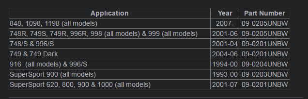

  3. As you have both SpeedyMoto and R&G, do you know if they look the same?
    The SpeedyMoto fitment chart gives the same part number for the 1198/1098/848 and the 749s/749r but a different part number for the 749 and 749 dark.
    I have read elsewhere someone said they had clearance issues with the pre facelift fairings, maybe that could explains the different part numbers.

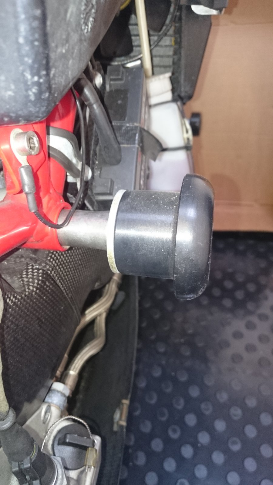

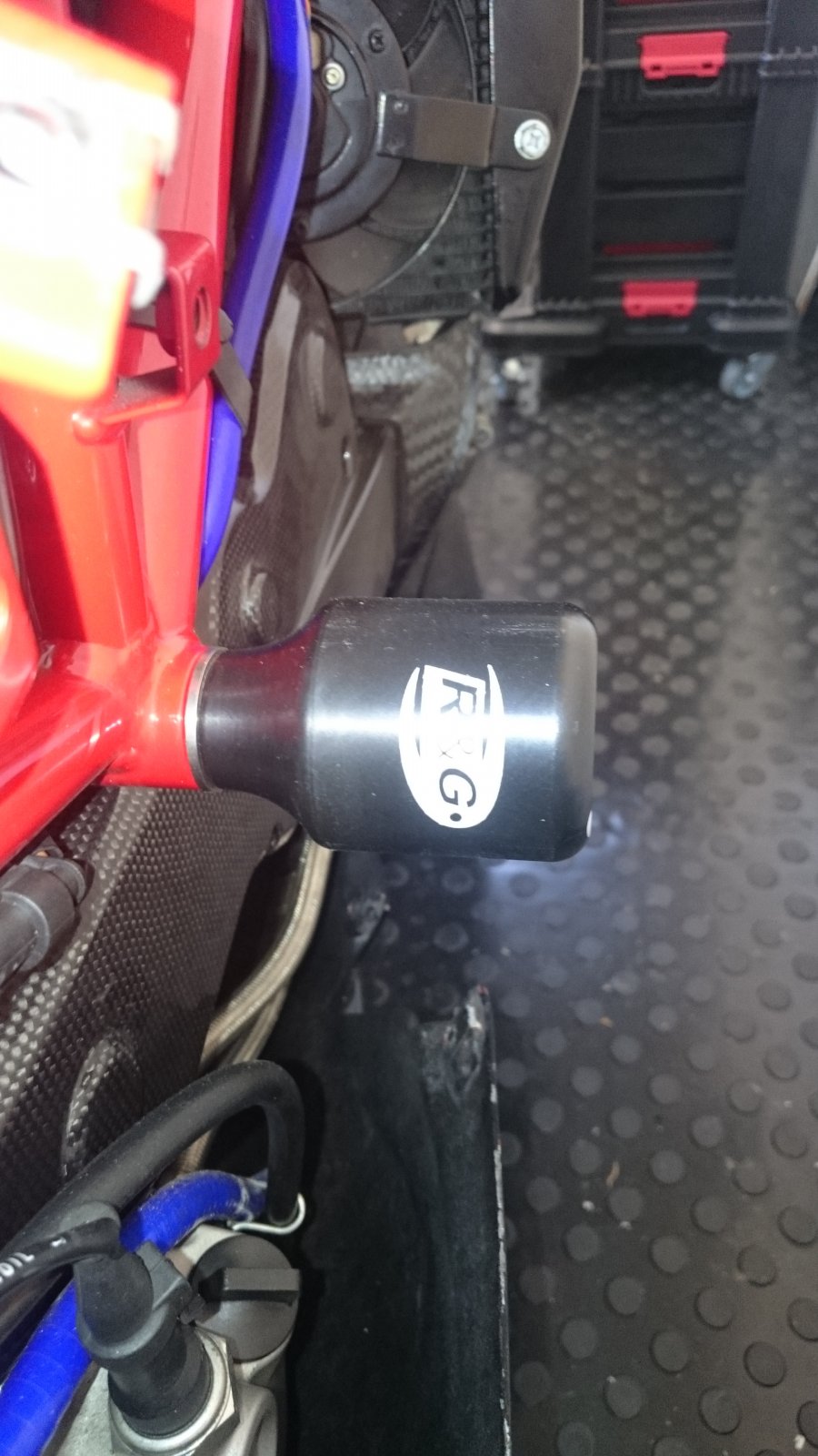

  6. @Pierre 66 here you go.
    Both extend approx 78mm from the red frame boss.

  12. Update on these frame sliders.
    They do not fit the 749/999.
    I don`t think the engine bolt is quite long enough, I couldn`t tell for definite because the left hand bobbin is a bit to wide to clear the battery box.
    I always knew it was a risk but, c`est la vie, pays your money takes your chance.

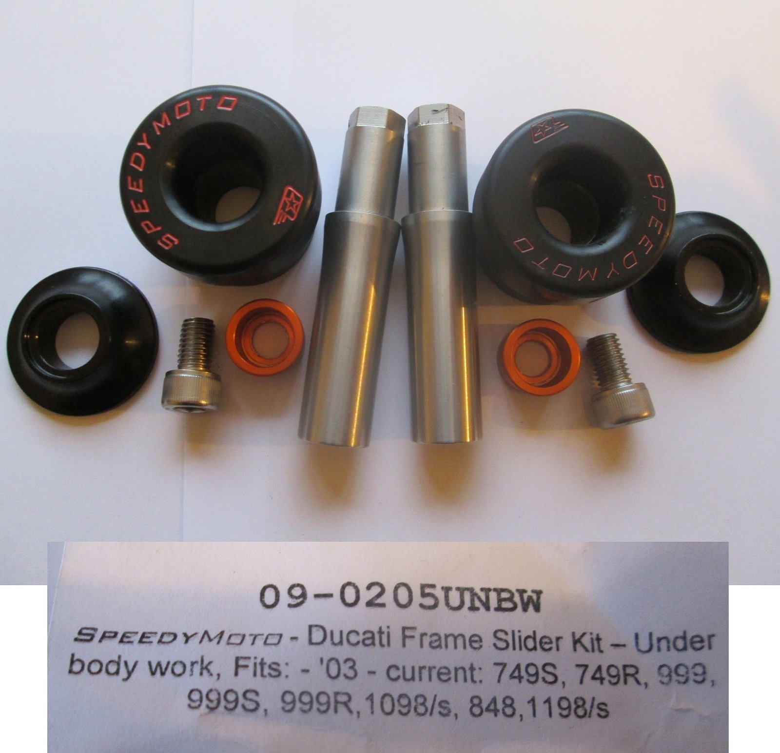

  15. I finally bit the bullet and ordered a set of speedymoto underbody sliders from America.

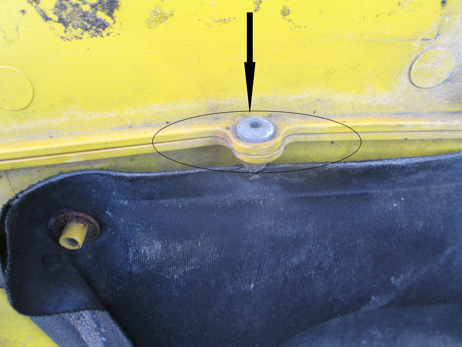

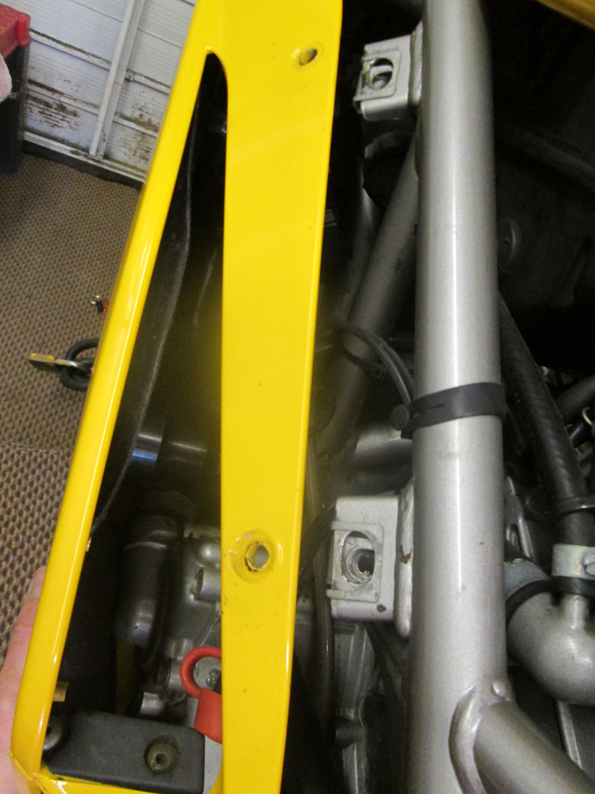

    Unfortunately, these fecking things won`t fit my bike either, or more accurately, my standard fairings won`t fit with these sliders.
    The slider pucks line up exactly with the fairing joint and fastener, no way will they fit without modifying the fairings and/or the slider rods.
    This is the fit and the offending fairing joint and fastener.

    Motowheels have said they haven`t come across this issue in over ten years of selling these sliders and have no solution to the problem other than modification. They sent me some pictures of these sliders fitted to their shop 999R, their slider pucks are more mushroom shaped than the one`s in my kit, don`t think this would make a difference though. They did say the fairings on their bike are one piece so don`t have a join.
    If they haven`t had any issues with this kit before, and there`s no reason to think this isn`t true, surely the internet would be awash with complaints etc. otherwise.
    The only other thing I can think of is my bike is quite an early 2003 model, I wonder if Ducati changed the fairing joint position, just enough to clear the sliders on every other bike but mine.
    Ah well, c`est la vie.
  16. My fairings are one piece so I don't have this problem.
    Perhaps you could shorten the puck on the smaller diameter side to clear the fairing?
  17. I tried fitting just the rods without the pucks to get an idea of how far out they are, the fairing would nearly fit. I think the fastener and joint lip will need removing where the puck would be, there is about half an inch of the rod nearest the bike that is unthreaded, that could also be removed on a lathe.
  18. I would modify the Fairing if it were me. If you shorten the slider/puck, it may not protrude sufficiently past the engine casings therefore completely negating the effect of the sliders which obviously need to touch down before the engine does.
  19. That was my thinking.
    I`ve read the idea behind underbody sliders is they are more to support the fairing and help stop it collapsing into the more expensive parts underneath, the fairing being seen as the slider and as such, a sacrificial part.
    I`m going to have another look tomorrow, I still haven`t got the old girl serviced or MOT`d yet, bloody work keeps getting in the way.
