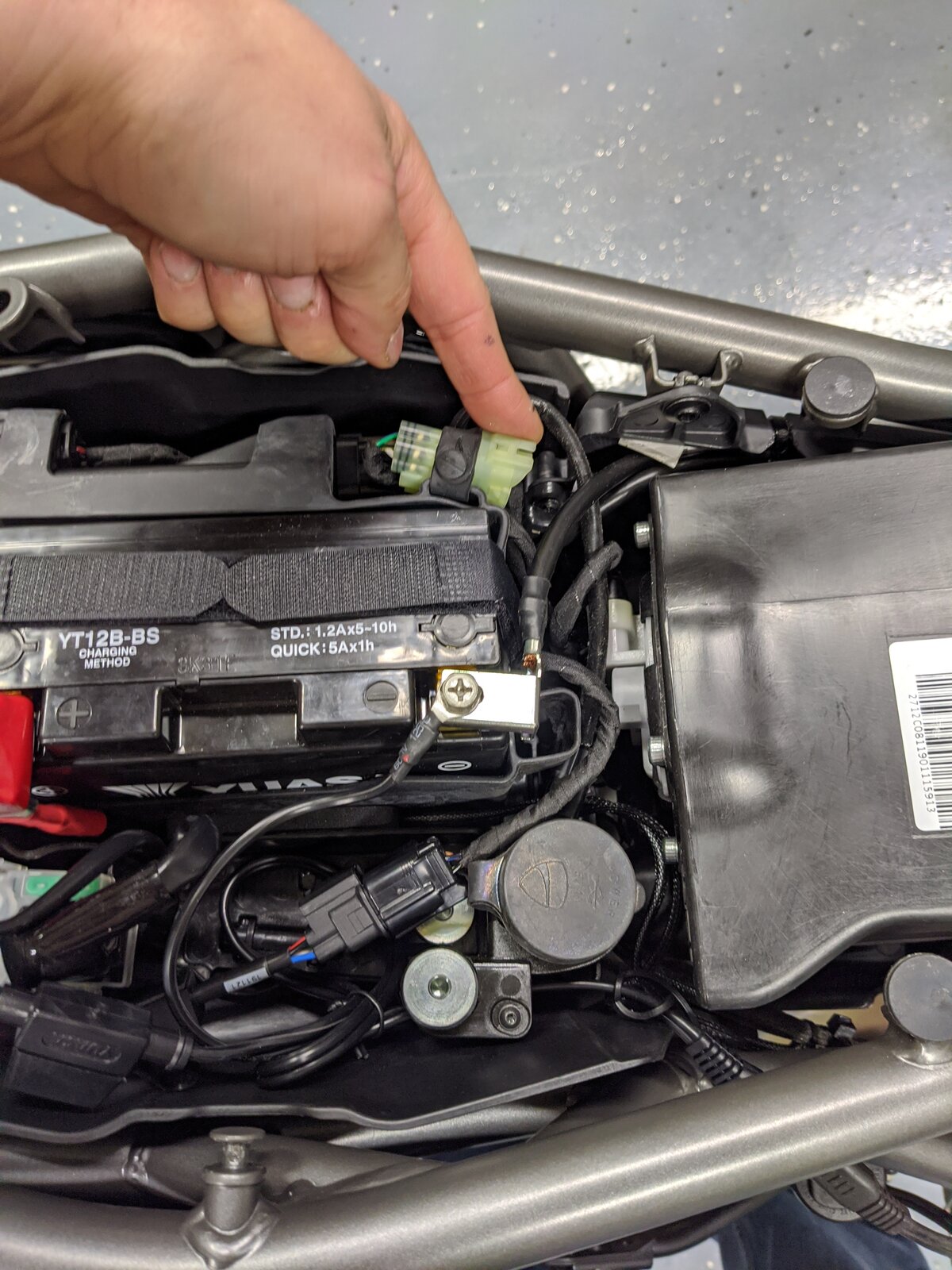

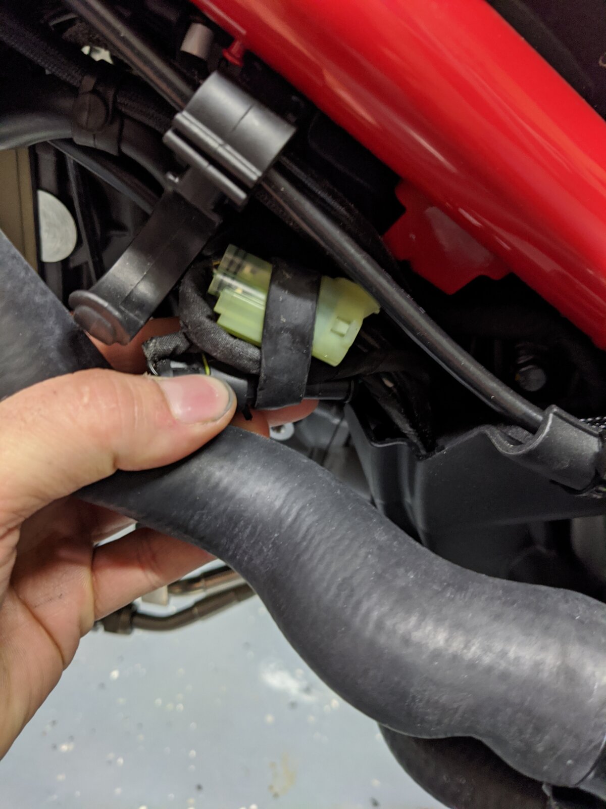

  10. Thanks mate. Presumably you unplug the cable but leave the sensor in the pipe? Unconnected I can't imagine it makes a difference if they are still screwed in.
  11. Yeh thats what i did. One is on the left side just behind the big coolant pipe and the other under the seat next to the exhaust valve plug. 5 minute job

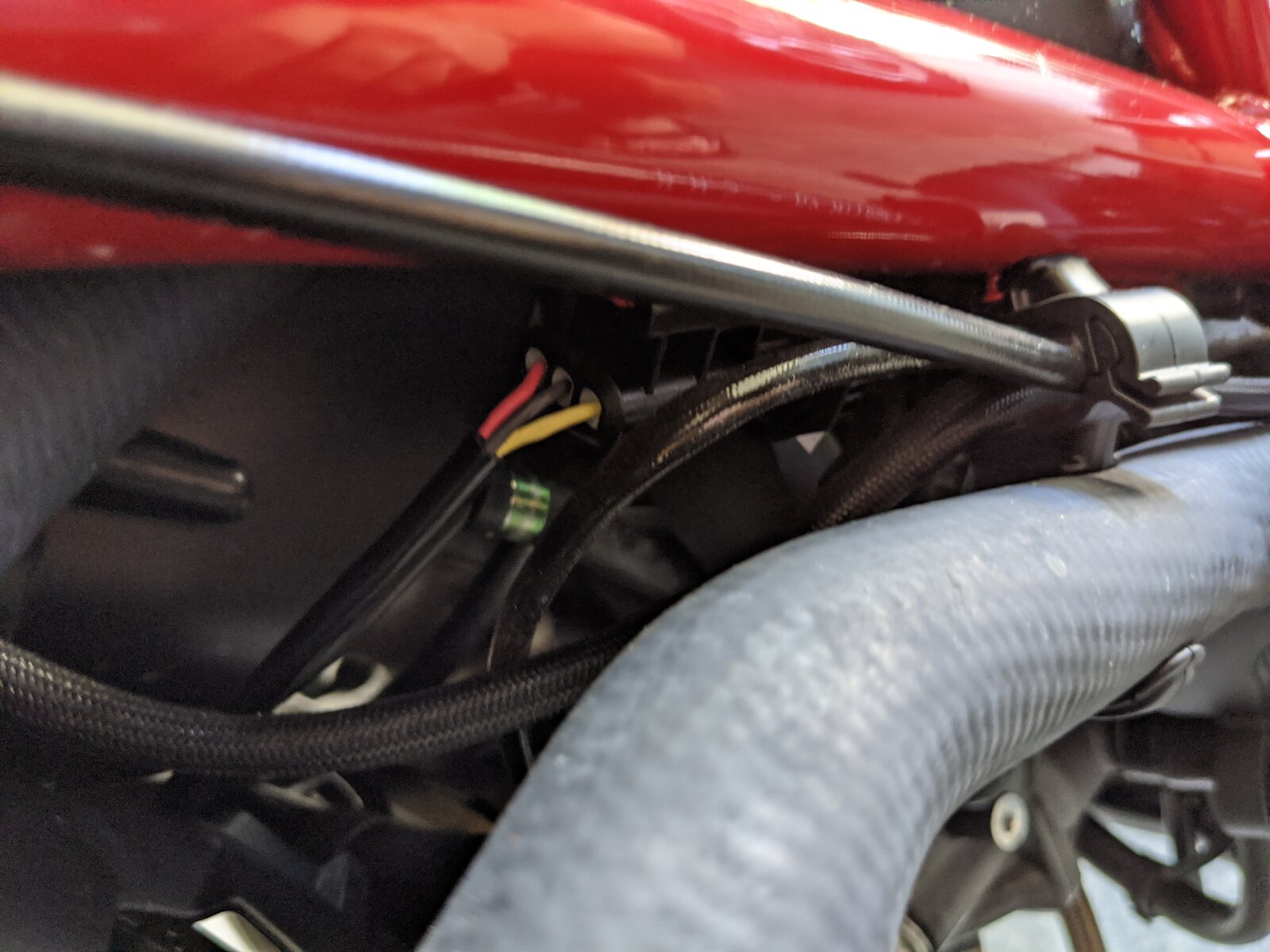

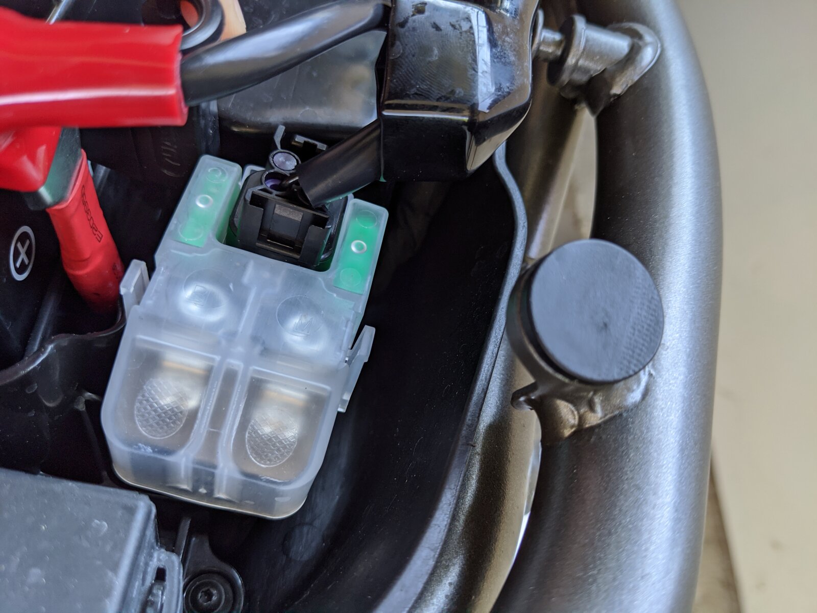

  14. Hey bud just to be clear it is these two yeah?
  15. The lower left one is tucked behind the black three-pin in the second picture. Helps if you pull the hose out of the clamp.
