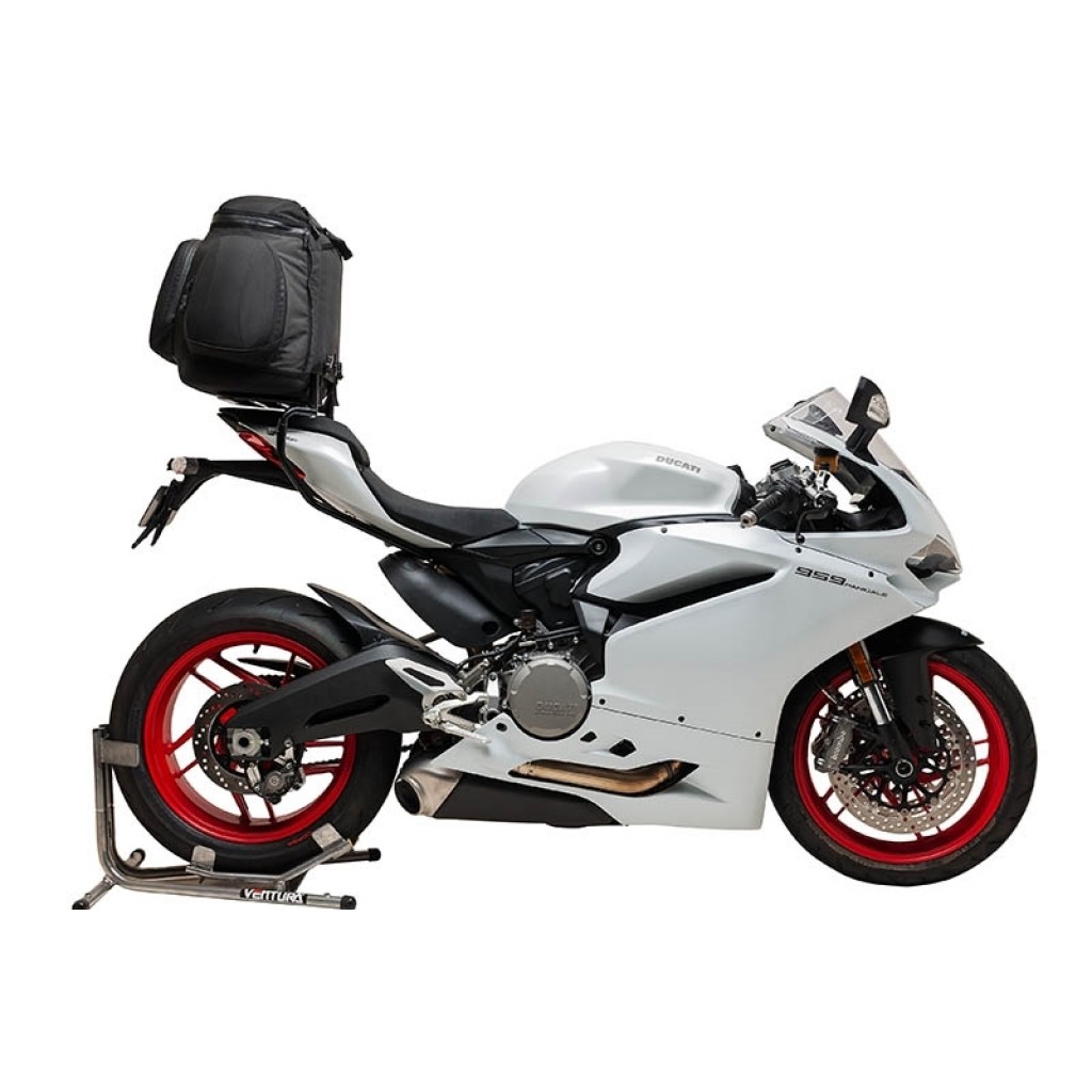

  2. Ventura stuff works well. I hacked an 1199 Ventura rack to fit my 1299, but now I understand that they have a dedicated 1299 rack. If you go the Ventura route, don't get the big 50l bag. you will only end up filling it with crap you won't need. You will have to get your skates on though, and hope that all the bits you need are in stock!

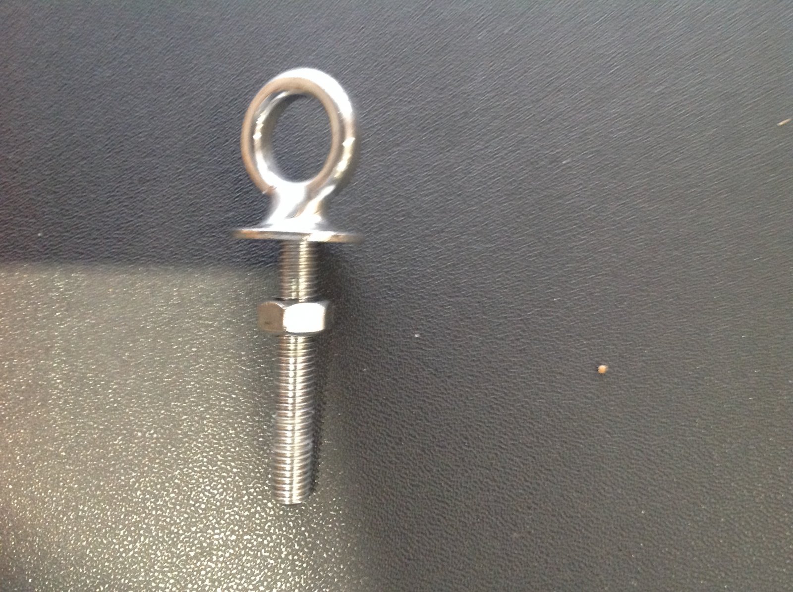

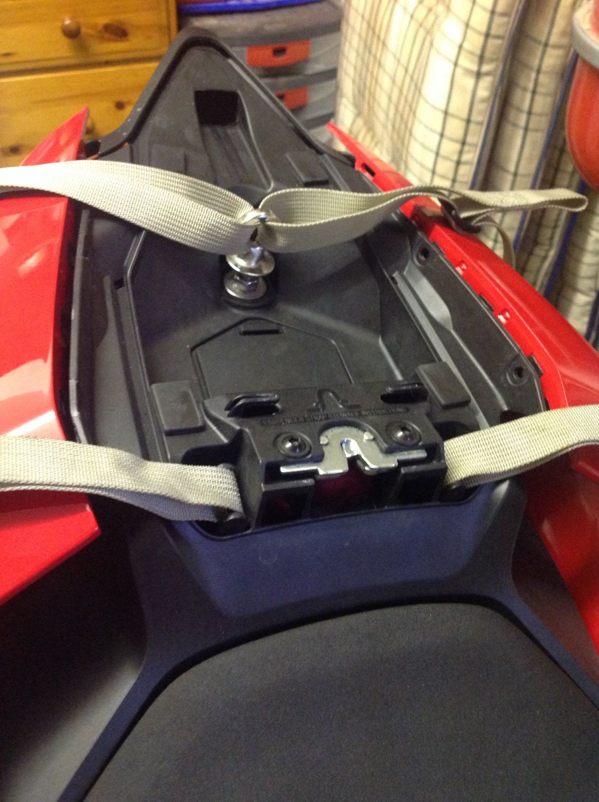

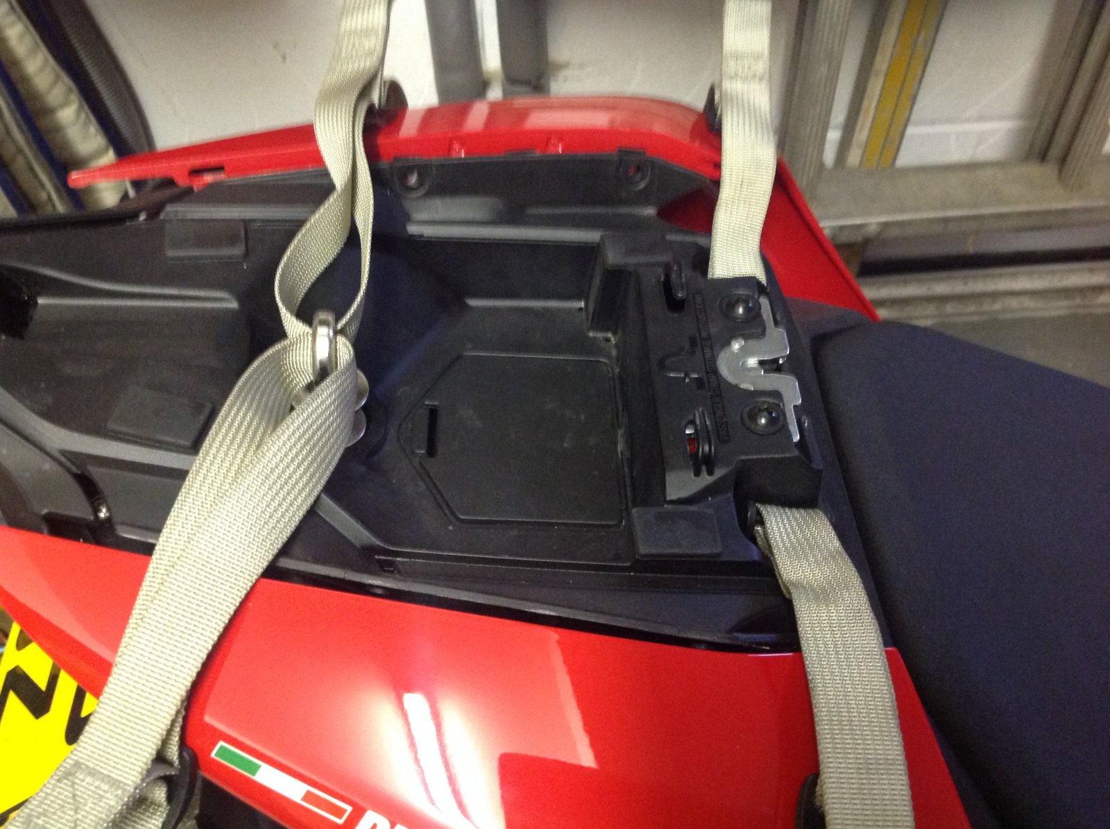

  7. I made a couple of really easy tweeks so you can use the new Kriega hooks. One done you can just leave straps fitted under the seat and just pull them out when you need to use your bags. Remove the pillion strap from the two brackets and attach the thinner grey (Kriega) straps. This gives you the two loops for the front. Replace the bolt under the saddle with an M8 collared eye bolt, stick a couple of nuts on so you can lock it. That gives you an anchor for the same thinner grey Kriega straps for the rear of the bag. As the saddle is soft you can put something along the edge so the straps don't dig in too much. The whole thing costs bugger all and takes no time to do.
    Let me know if you want any more help. I have used this several times in France and it has been fine. I planned to use it until Kriega come up with a solution.
    Cheers

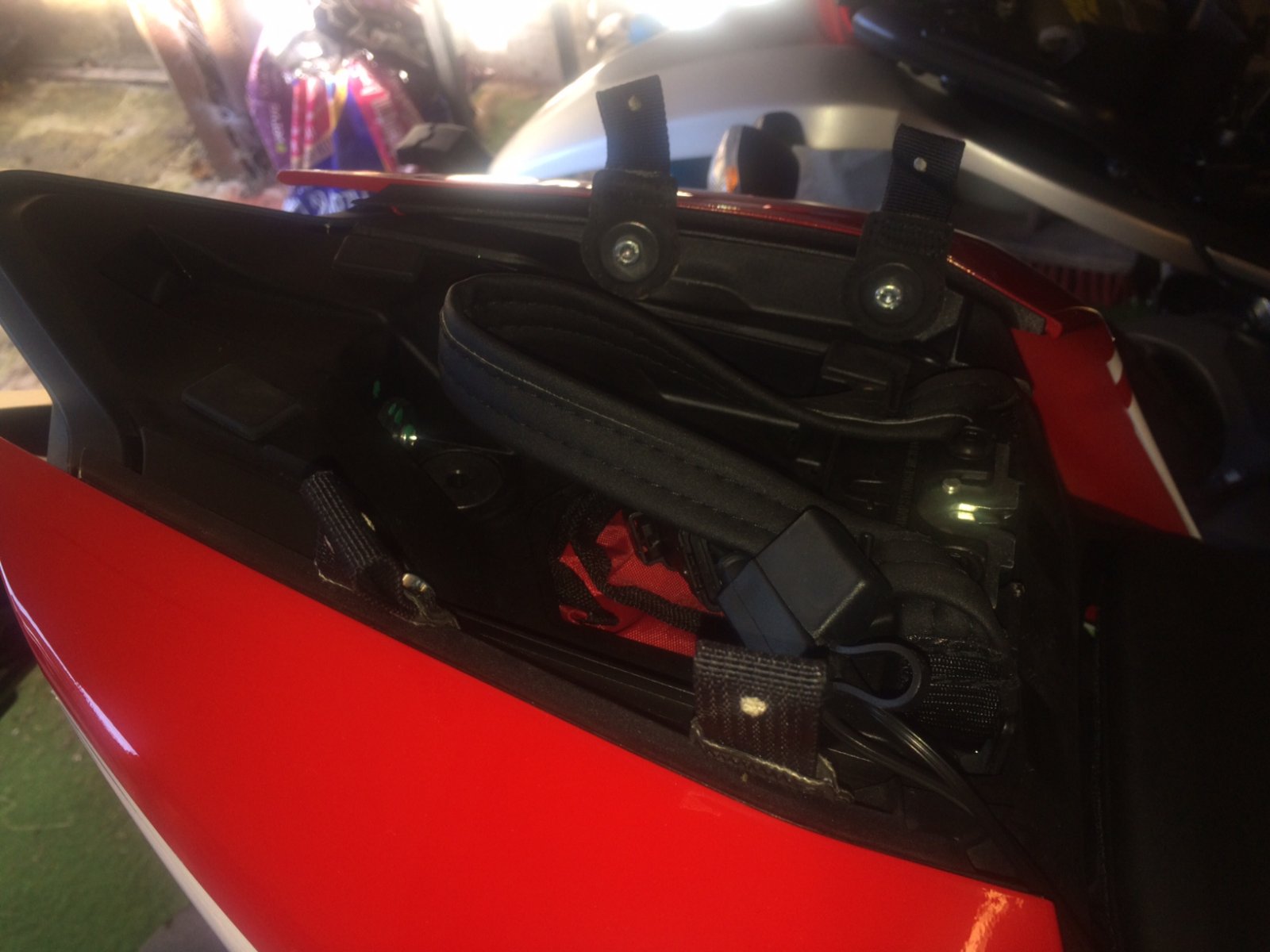

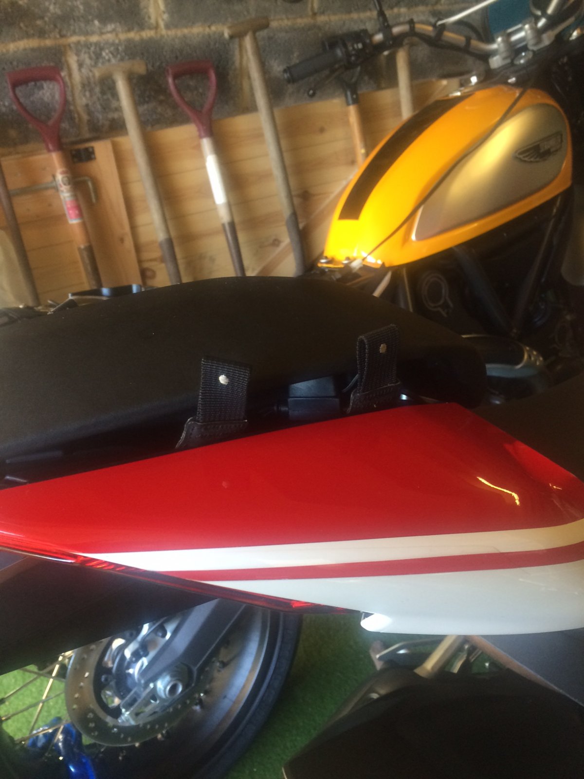

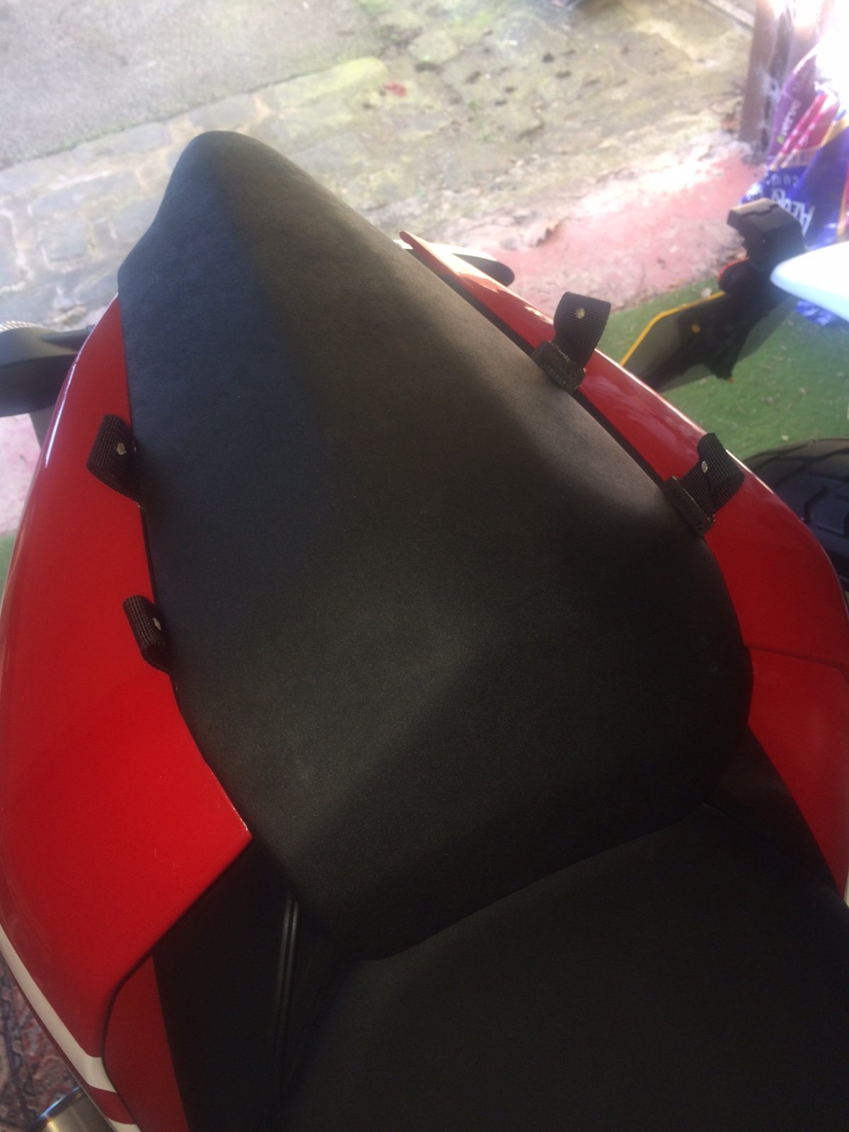

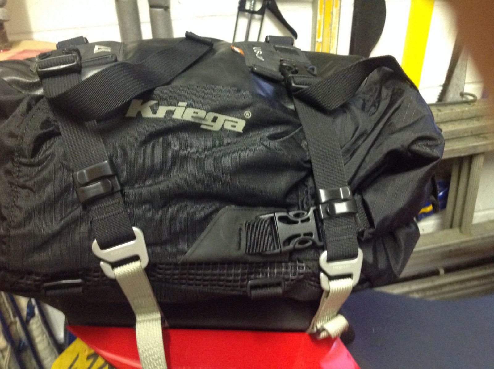

  8. This is how mine fit (apologies for the quality of the pics but I took these for @Rosso in a dark garage a few weeks ago)
  9. Thanks for all the suggestions guys. Called Motohaus this morning and ordered a Ventura rack with a Mistral bag and it will be delivered tomorrow.
    I think the Kriega would of been ok for smaller lighter loads but it just didnt fill me with confidence re stability or bodywork damage when I'm throwing the bike around the Picos.
    Now time to sell the Kriega and 1299 fitting kit and get off to Spain. First trip abroad and can't wait.

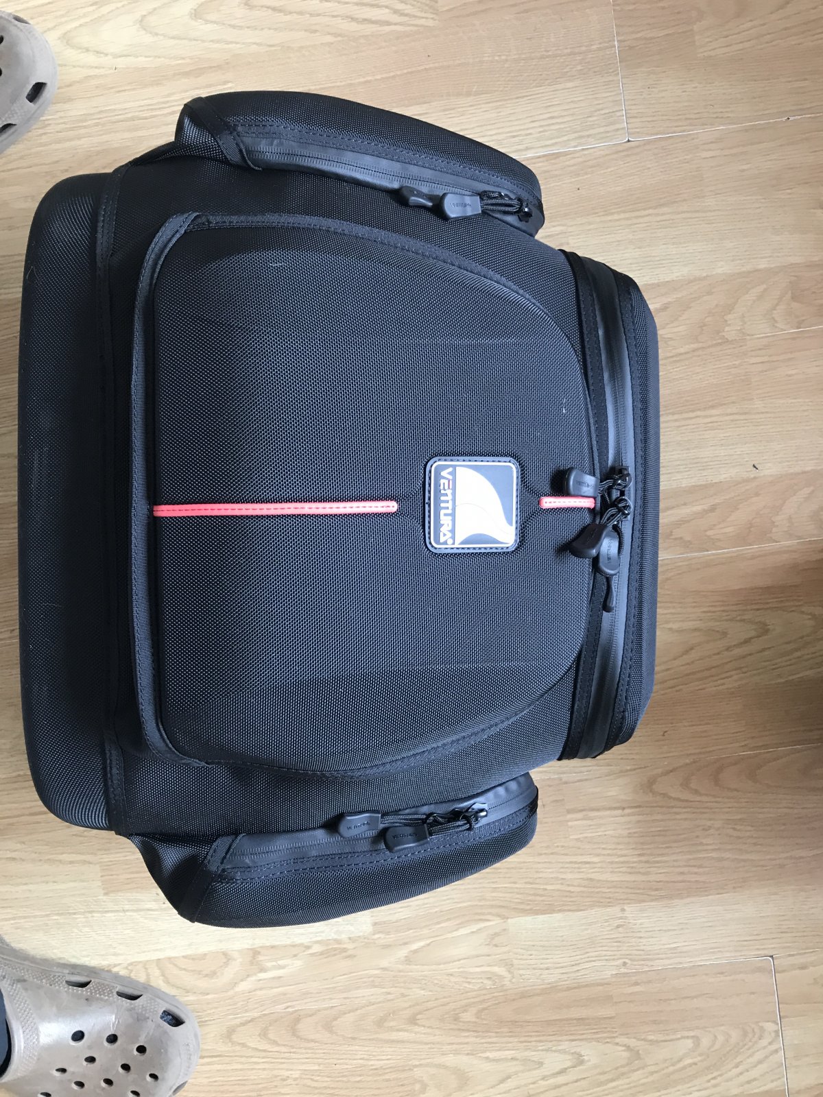

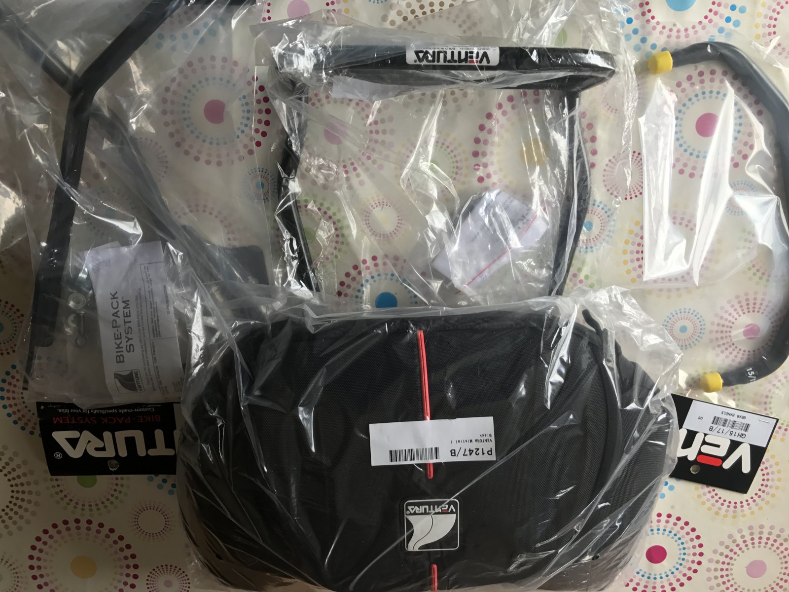

  16. IMG_0811.JPG Quick update. My Ventura stuff arrived today. Looks like good quality stuff. The Mistral bag took everything that I was trying to fit into the Kriega 30ltr & 20ltr with room to spare.
    I'll fit it tomorrow or Friday and let you know what I think and post some photos.

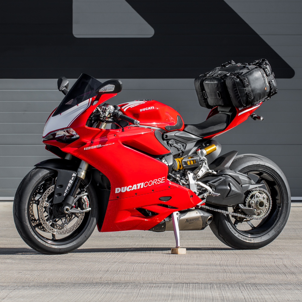

  17. Hi JJ1299,

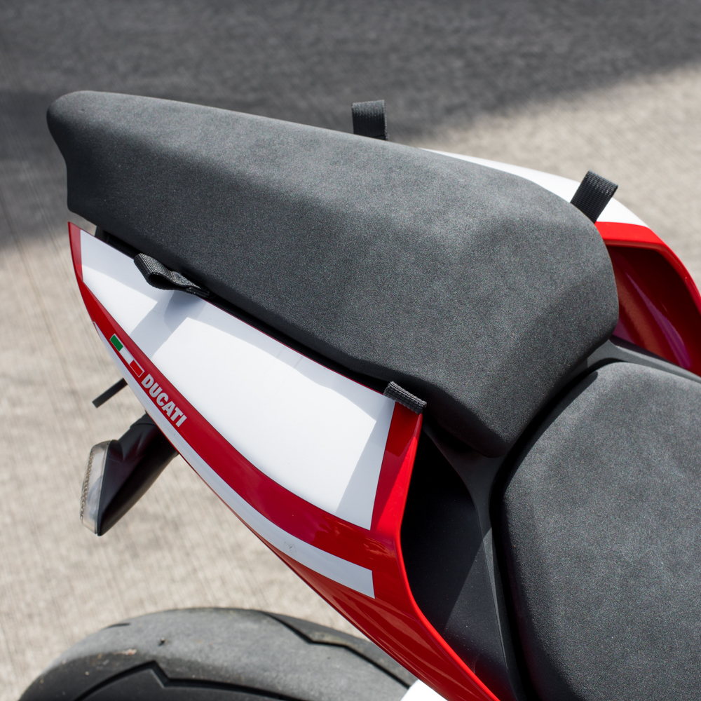

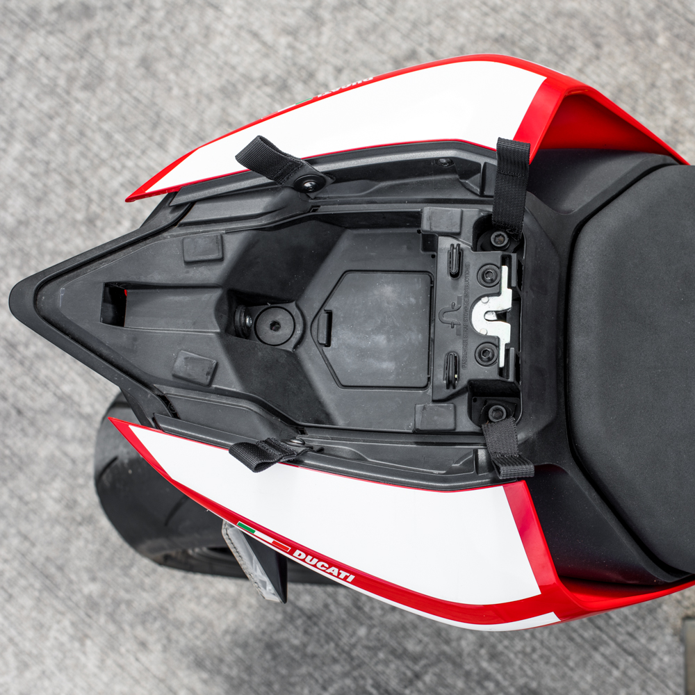

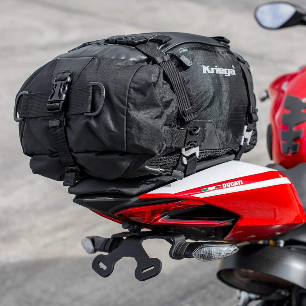

    Not sure why the post I did yesterday didn't go up. looks like it's a bit late now anyway?. For your benefit and other 959/1299 riders the new kit works fine with any of the multi-pack set ups. Without speaking to you directly it's difficult for me to give you feedback on how you are fitting the US70 combo. I'm guessing that the problem is that the middle/base pack the US30 is not being properly attached. For multi-bag set ups the base pack has to be cinched down to give a solid foundation to the add-on bags. Top tip is to push down on the corners of the bag as you cinch the buckle. Also on most race-reps the US30 is too long to fit inline with the bike. It can be mounted across the rear seat and the extra bags can then be added to the back and top. The fitting kit has been tested with all the multi-bag set ups and does work well. If you are near to our Deeside, North Wales location I can show you how to fit the bags, no problem. Here's some images of the kit and how it fits. The main single bag is the US20 and the cult-pack shot is the 40 combo set up.
    Best regards, Dom

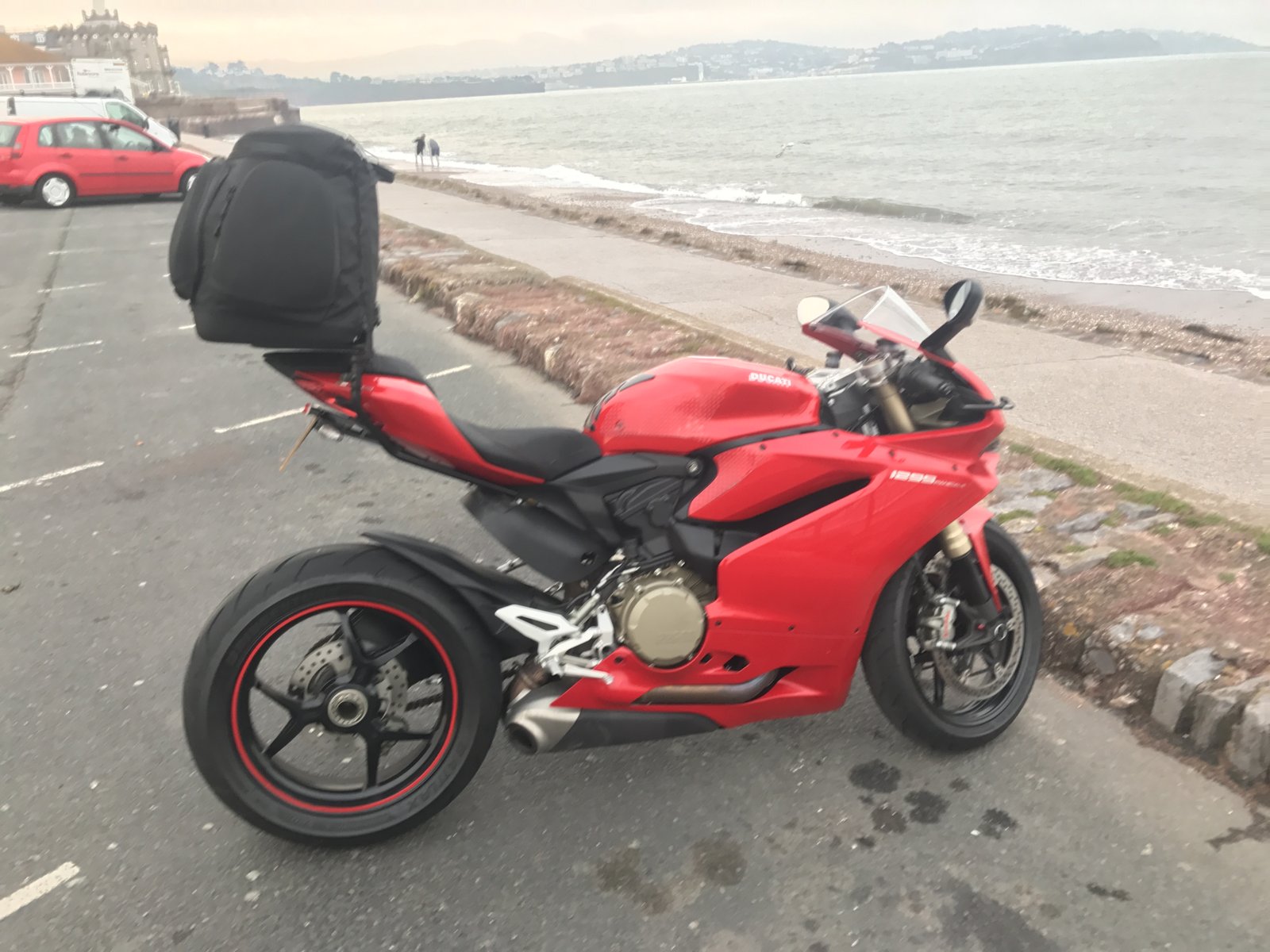

  18. Ventura kit fitted. Nice and simple to fit and I have to say I'm impressed. Had a couple of test rides throwing the bike around and the bag hasn't moved.
    Setting off on Sunday and I can't wait.

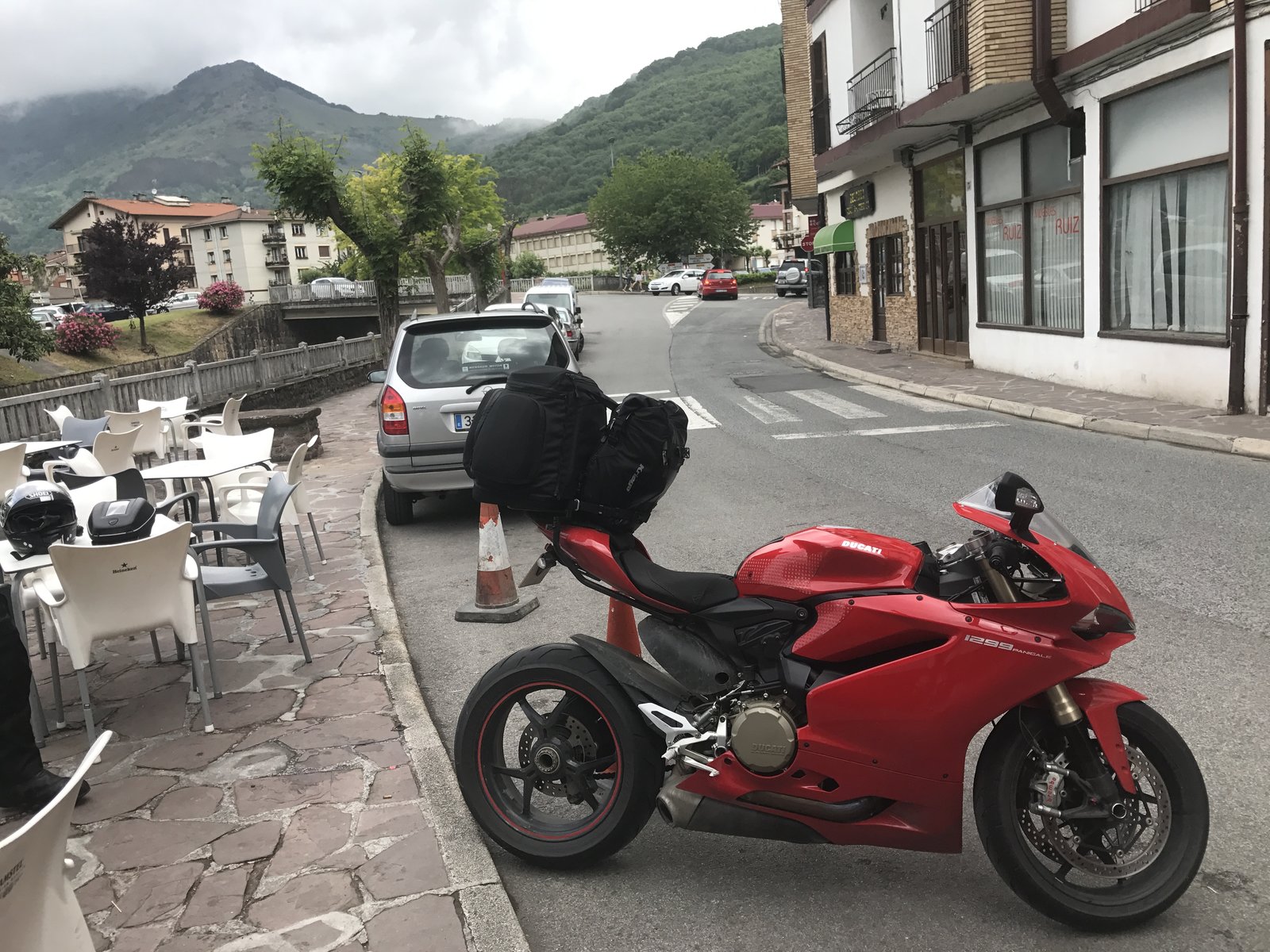

  19. This was my final solution which I have used for a few trips now and offers plenty of room. It's a combination of Ventura and Kriega.
