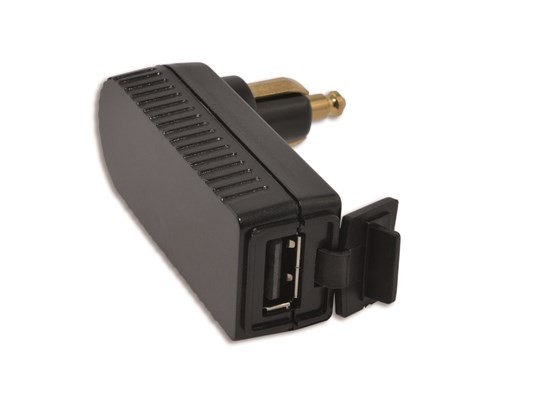

  8. Thanks Gary.
    That adapter looks decent - I think I'll try one of those.
    I have one of those USB converters on my Monster - worked ok for a while, but the USB connectors were a bit rubbish, and unsurprisingly not very weather-proof, so they got pretty corroded. Did you hard-wire that to the battery? I'm wondering if there might be a case of mounting the USBs into the panel next to the existing Hella outlet. Would make far more sense to be able to just plug straight into a USB. Although the weatherproofing issue would remain.

  14. That looks absolutely perfect, thank you kind Sir!
